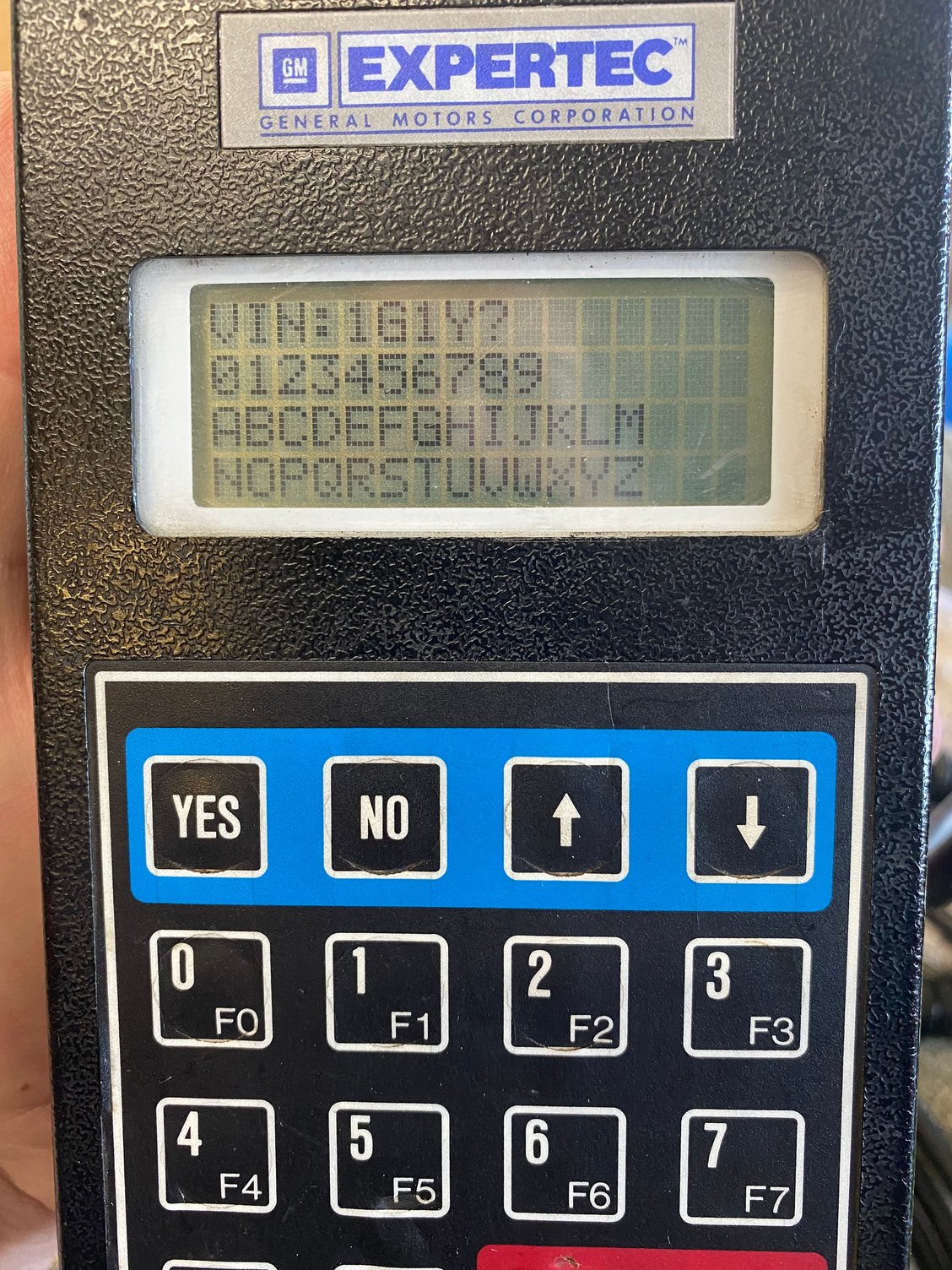

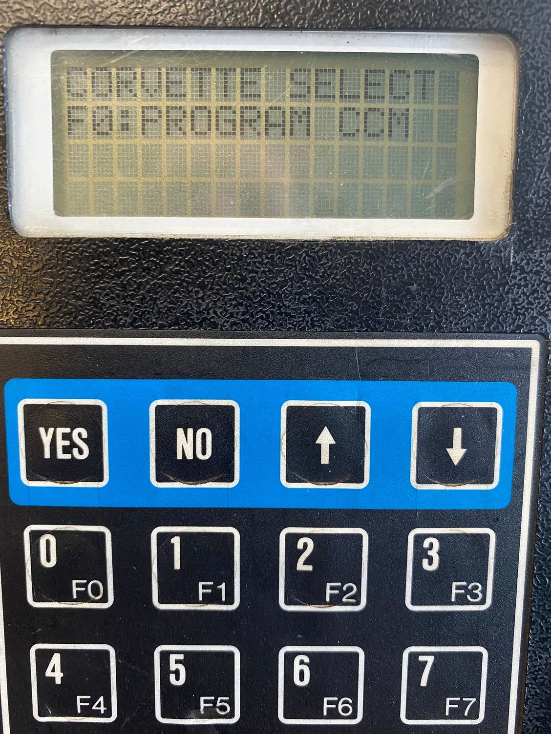

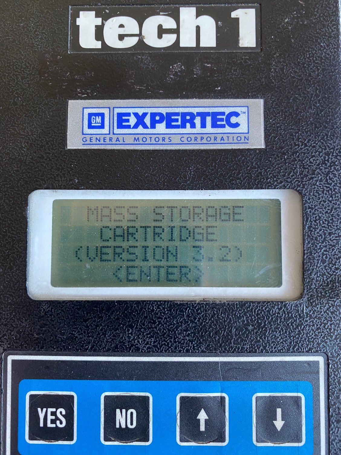

I believe you will need the CCM cartridge or a Mass Storage of 3.2.
Connect Tech-1 to ALDL connector just above gas pedal, plug power cord into cigarette lighter outlet, turn ignition key to “ON” position
The backlight should illuminate and display the cartridge version installed: (mine is Mass Storage Cartridge Version 3.2 )
Press the Enter key
The Display will show available selections on different lines, Powertrain, Body, Chassis, Programming etc.
Use the UP/DOWN arrow keys to select “Programming” then press the F3 key.
The tool should display GM 90-96 Service, Programming Version 4.02,
Model Year ? will be flashing. Enter just the last digit! (3)
The display should show Select 4th digit of VIN code and give choices
FO : S/T Truck? and the letters AFJLRWY, “A” should be flashing
Use the NO key to move through the choices until you reach “Y” then press YES
The display should now show Corvette Select
FO: Program CCM
F9: Help
Press the FO key
The display will now show three lines of letters and numbers, and ask for the 5th digit of the VIN.
Use the NO and UP/ DOWN arrow keys to select “Y” then press YES
Continue to follow the screen prompts using the NO/ YES and UP/ DOWN arrow keys to navigate the display entering the information requested until finished.

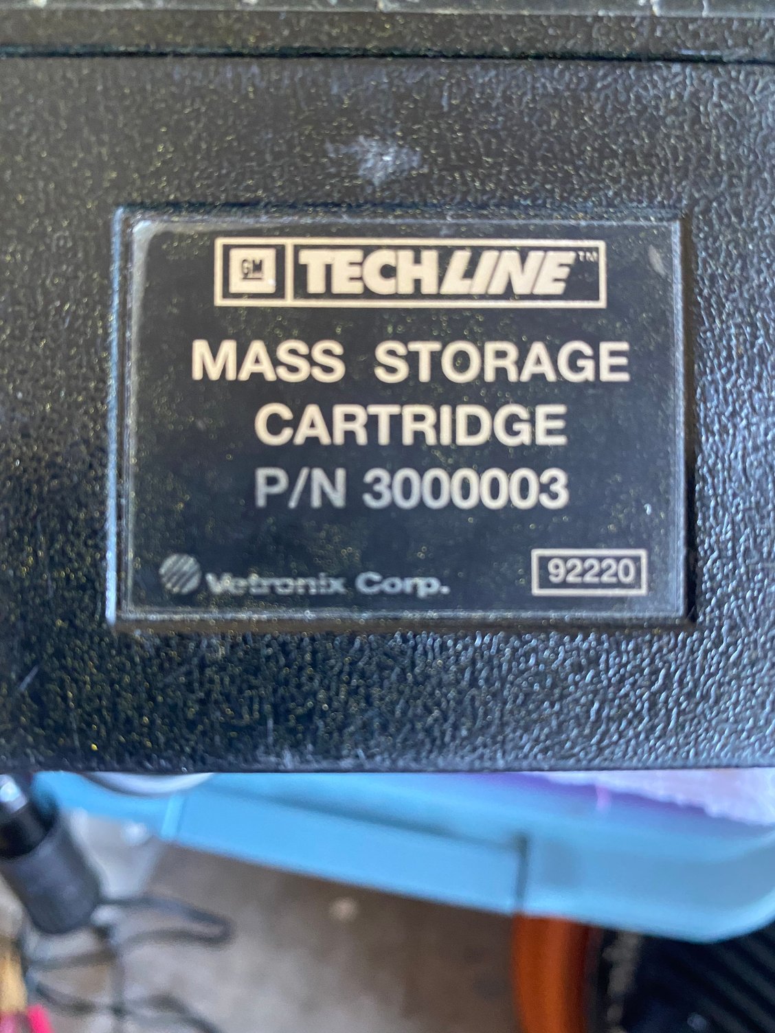

The problem, is there are numerous Mass Storage cartridges. And even if you had the GM specific cartridge #3000003 it was able to be updated as well. So you might find one for sale, and it could be a lower version.

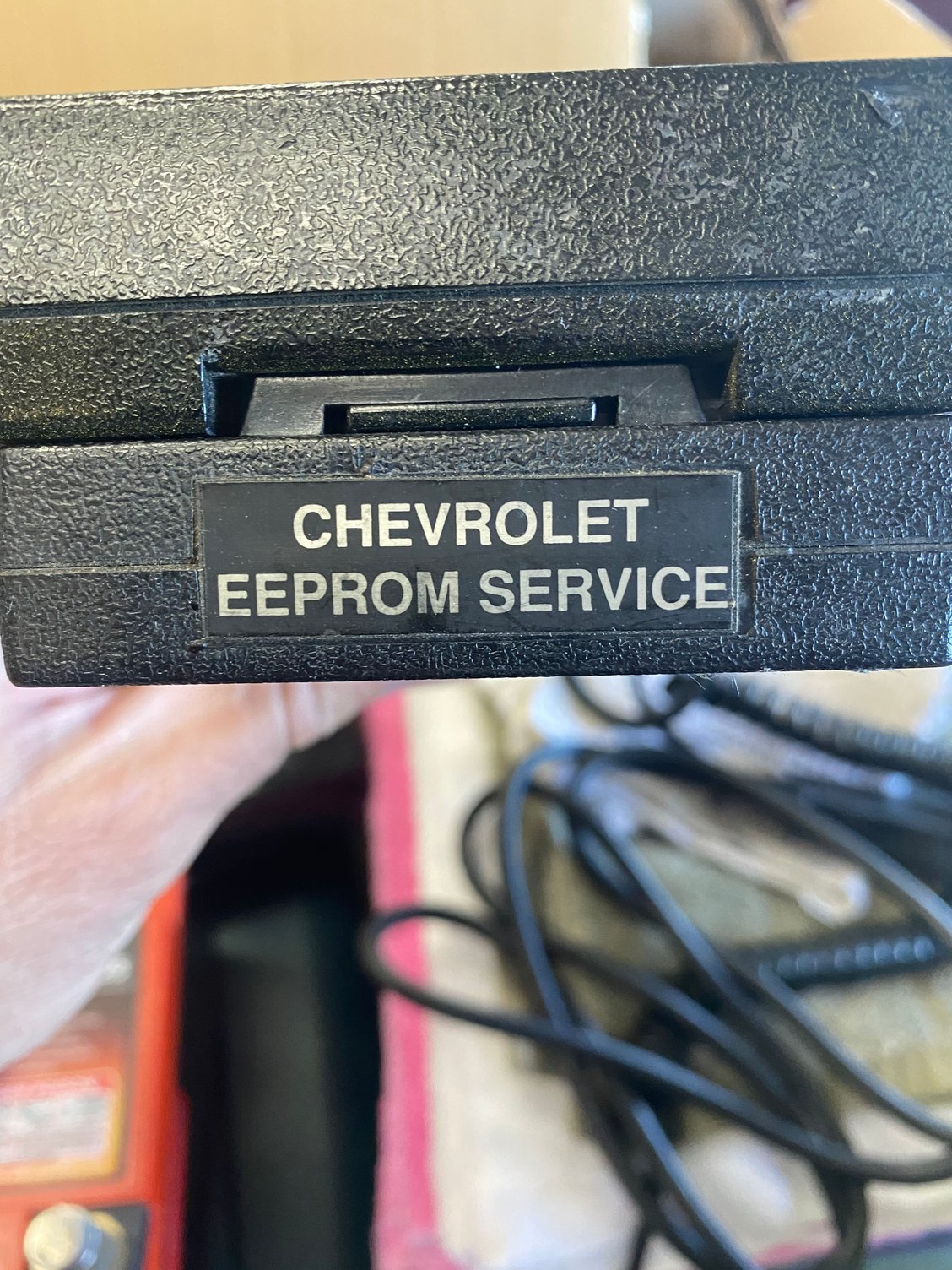

This would be the other cartridge to look for. It will be cheaper as most people don’t know what it is used for.

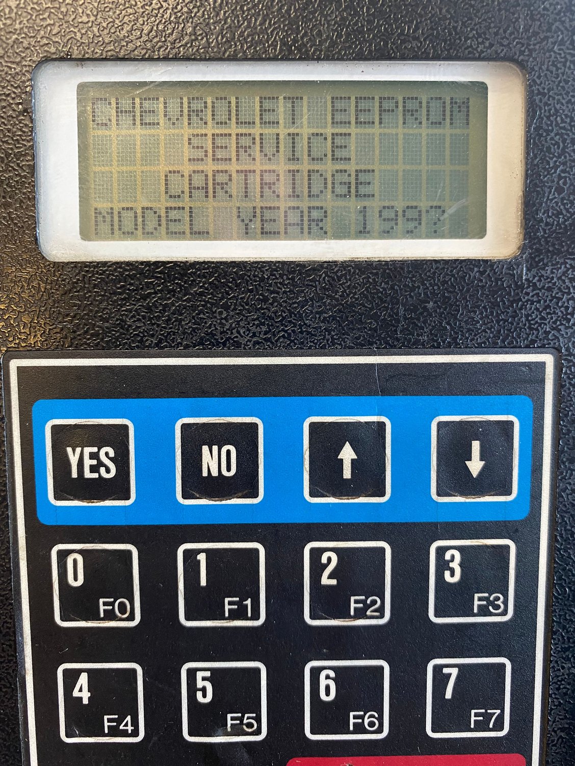

@ChumpVette what is the Cartridge Part Number for the EEPROM Service?
Old Jun 22, 2023 | 10:30 PM
ChumpVette's Avatar
ChumpVette
Joined: Jun 2010
Posts: 4,564
Likes: 1,676
TK06030
