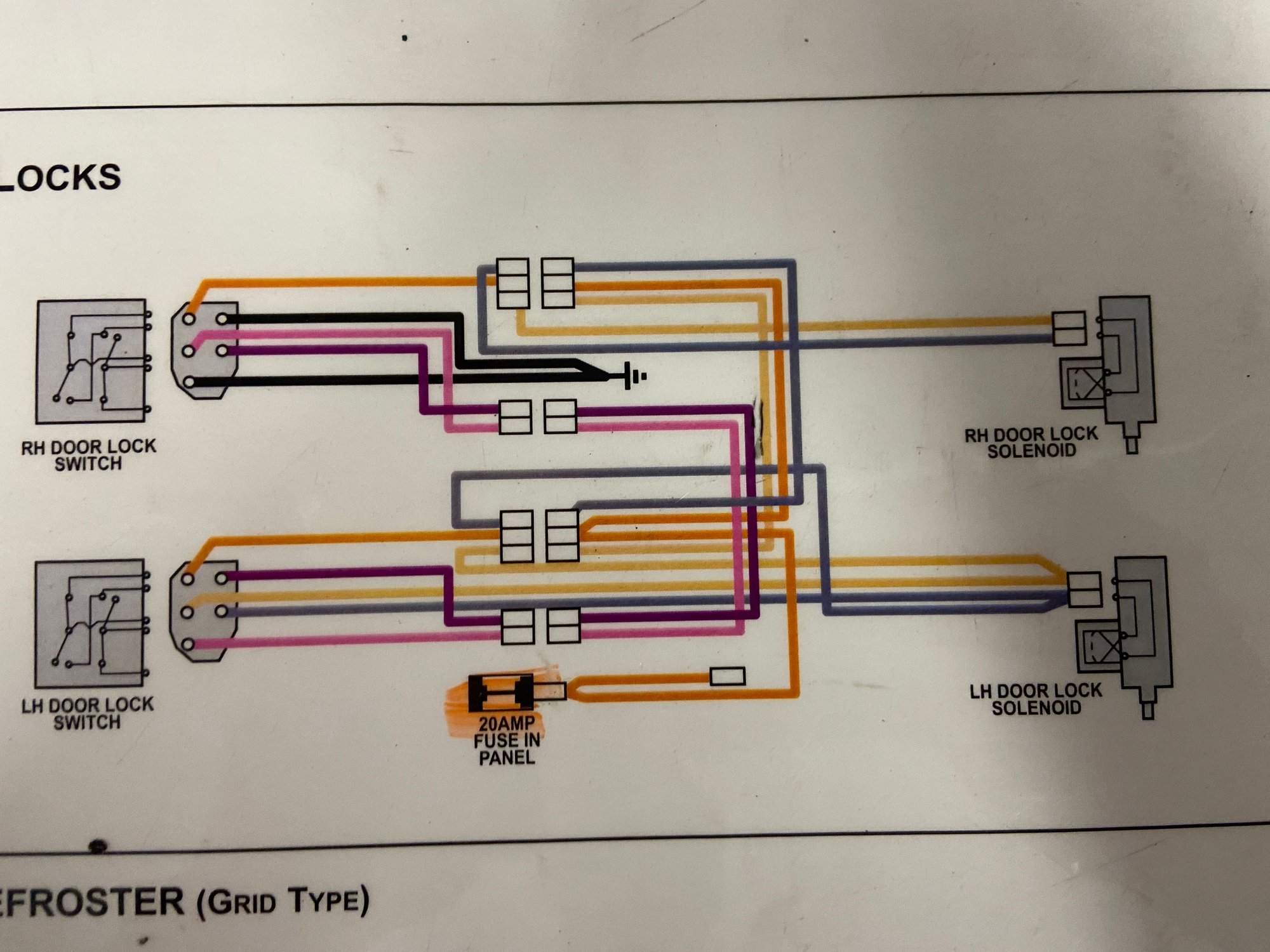

the set up I got from A1 electric ( post #5) came complete with new actuators and a relay and the wire harness. It was pretty straightforward you just needed a constant hot and a hot w/ key. It was about $100 or so. 2 remote fobs and I added a central switch for in the dash. I was redoing my door panels so no need for switches there. My understanding was it was very similar to a Viper set up. As for colors of wires, here are 2 schematics of my 78. Only blue wire in the door was for a power window.
