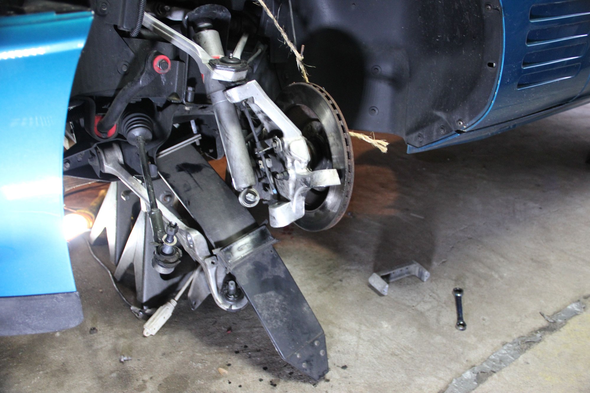

I used 11" lowering bolts on the rear and cut down the inner rubber pads on the front spring about two years ago. I recently just reversed all of that work and converted to stock Z51 springs and put the stock bolts back on. The ride quality and handling characteristics were horrible and the car was difficult to drive anywhere because it was so low. Did it look great, absolutely. Just be aware there is a pretty significant tradeoff depending on how low you go. I'm much happier having the car back at the factory ride height.

I did that kit on mine. You shave off the factory rubber mounts in the center of the front leaf. You then glue on the provided low profile urethane pieces. You also trim the 2 metal mount brackets the same amount. I got appx 1" to 1.25" in the front. The hardest part is getting the car up high enough off the ground to get the leaf out. Car needs to go up appx 2' or so. When the front leaf is relaxed, it has a pretty big arc to it, it slides out either side of vehicle.
The rear adjustable bolts are easy. I dropped the rear appx 2.0".

I did it the hard way yep was work cut the front pads 11in bolts in back, I replaced the front spring as well the rear also heavy springs back and in front poly sway bar bushings 28-28 mm bars F-R HD shocks ,handles like a slot car goes anywhere to point it at about any speed for a 31 year old Vette works for me .Drives great ..
