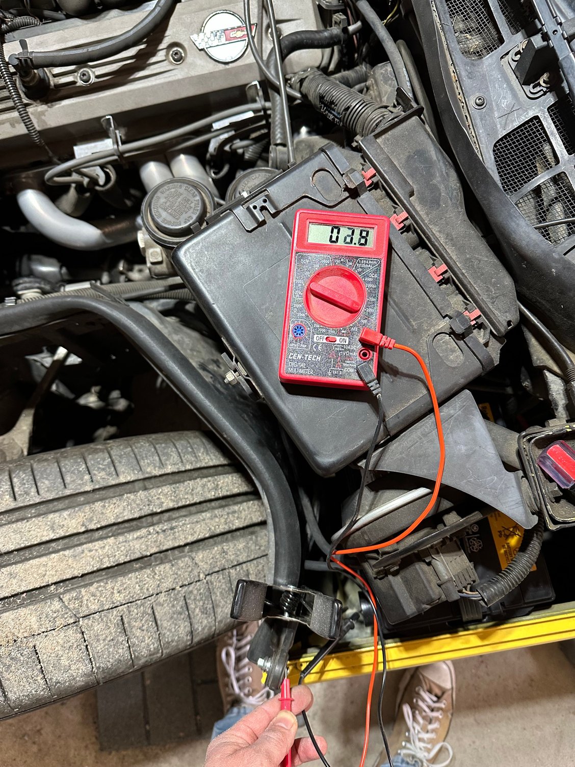

I have my multimeter set to 200m DCA. it is showing 1.8 in this photo safe to assume this is a reasonable draw? I believe this is 2 mA?

A parasitic drain of 1.8mA is trivial. A healthy battery would tolerate this for more than a week with no trouble. A battery tender is still a good idea.
Live well,
SJW
thanks! just wanted to make sure i was reading the meter correctly.

That Harbour Freight VOM is having a problem reading the draw. There's a reason they give them away as an incentive to come and shop. LOL
no clue where it’s from, my it’s my neighbor who typically had decent equipment, ¯\_(ツ)_/¯
