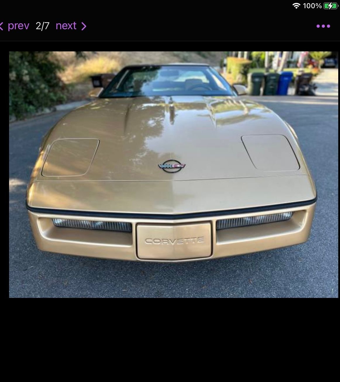

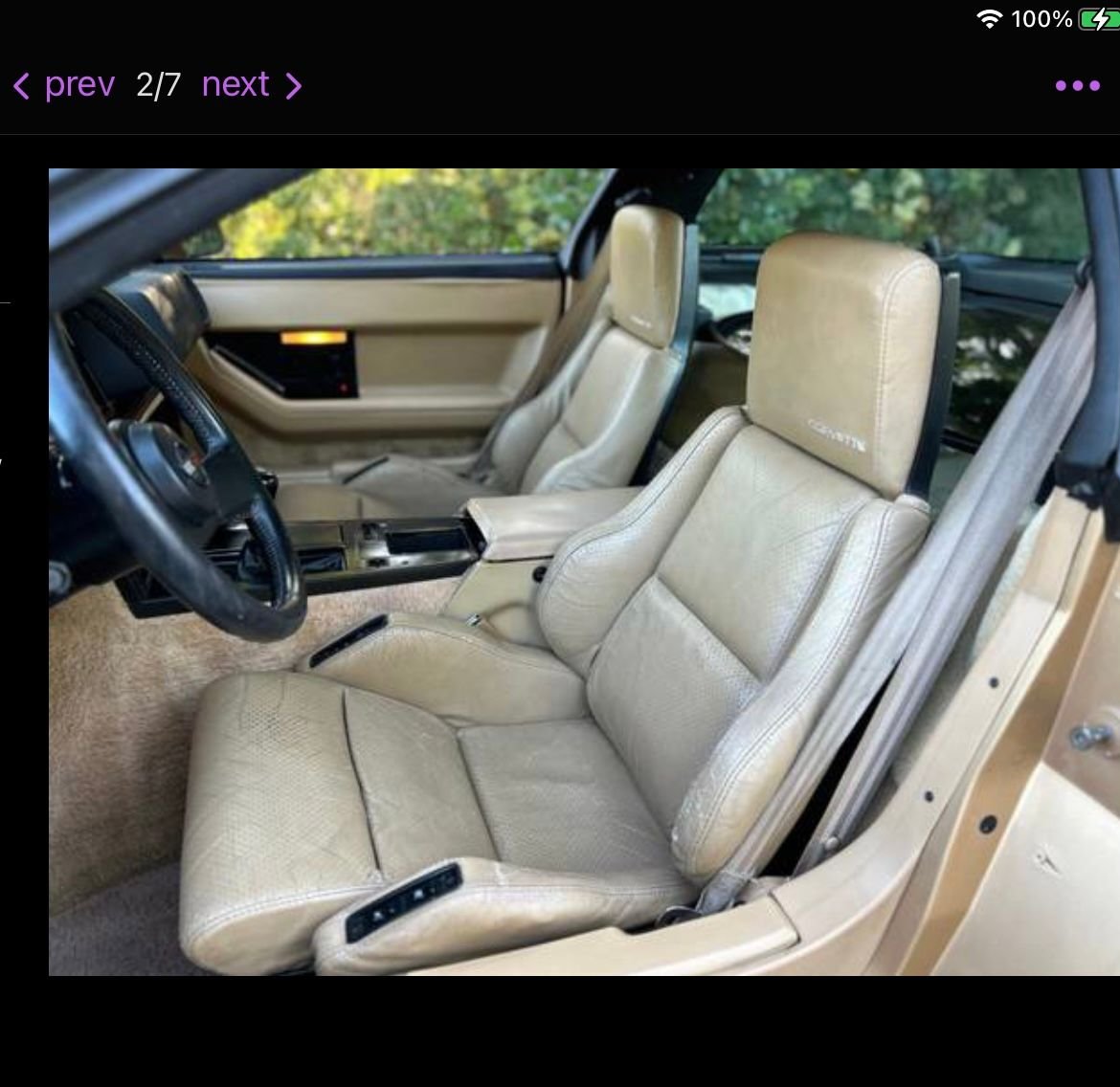

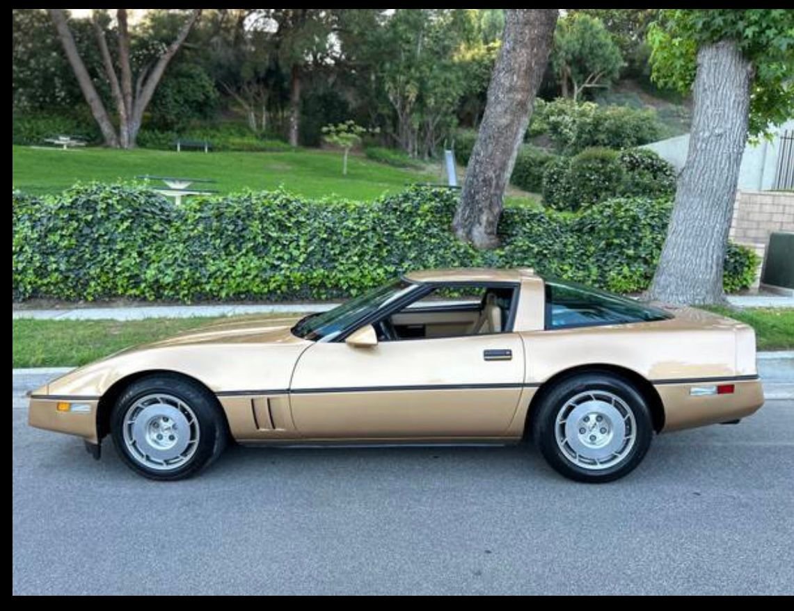

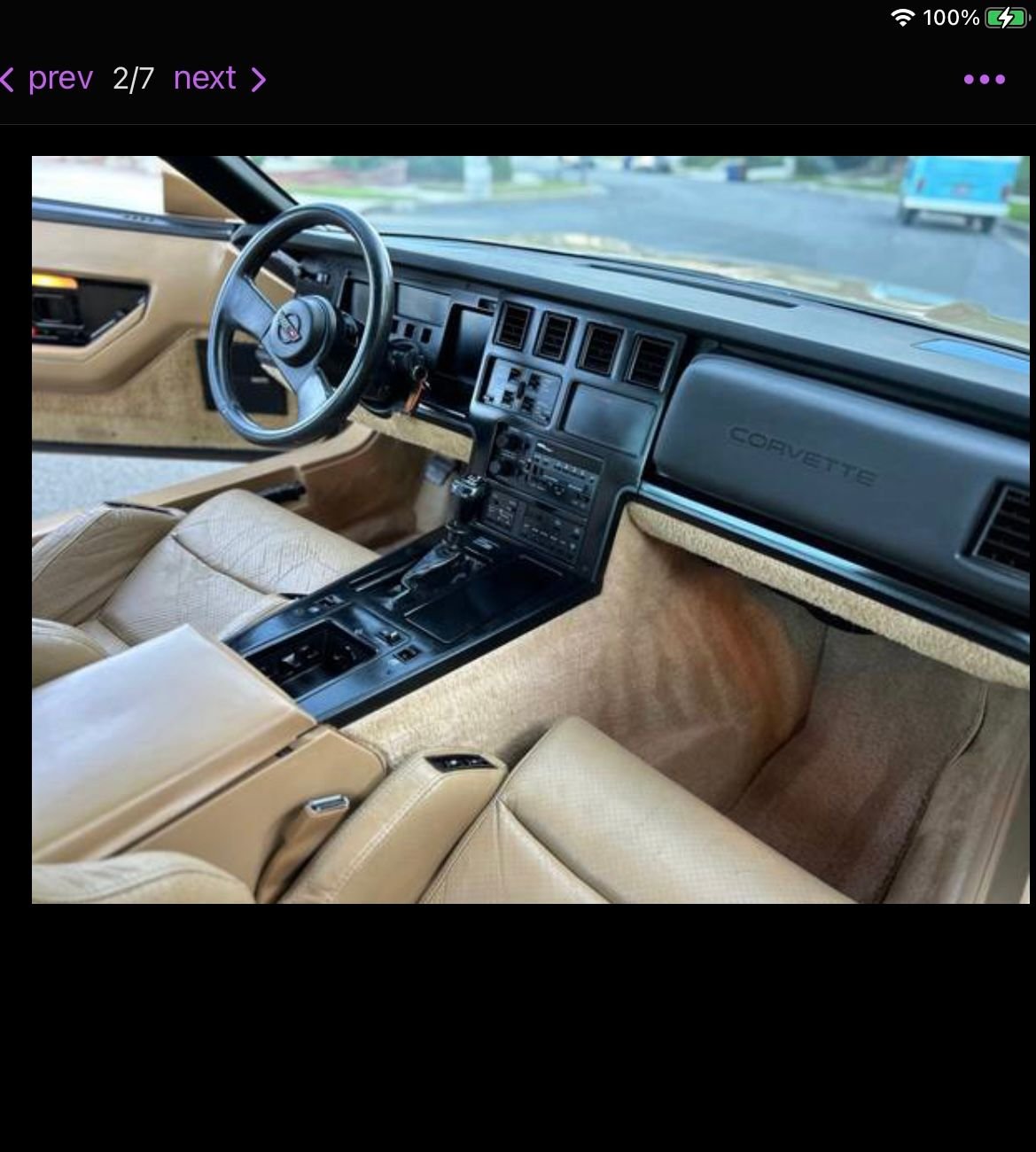

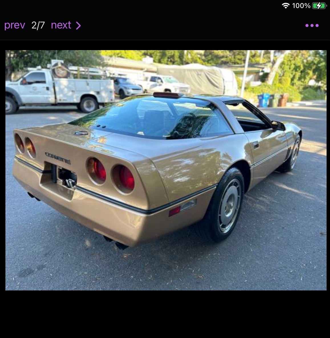

Default Pics of the 86
I had to crop these to get them to less than 10 megapixels…don’t think it’s a Z51.
