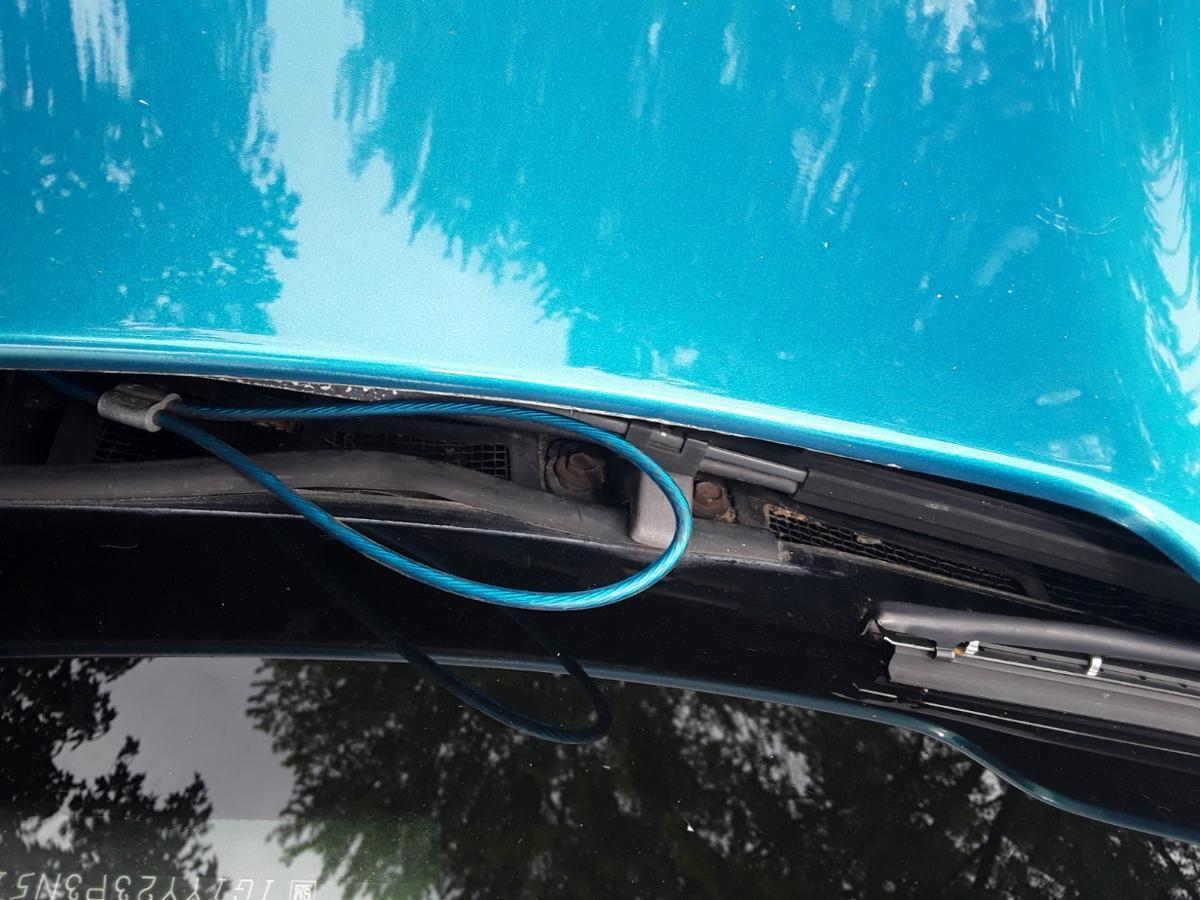

Ron, there are several threads on here over the years of how to make emergency hood release cables. Very briefly you can take plastic-covered braided wire and make a loop on each side. The loops can be tucked down out of sight. In the event the factory cable is broken or out of adjustment, you can reach your hand down and pull the loop manually to open the hood.
In my case I used a length of wire left over from an old above-ground swimming pool cover. Not only is it the right size, but it's the prefect match for my Vette's color! I thought I had pics of how it's attached to the factory release lever but can't find them at present. This will give you the idea and someone else will post better detail.

Thanks! That is why I was going to open the hood today, to install the safety cables.
