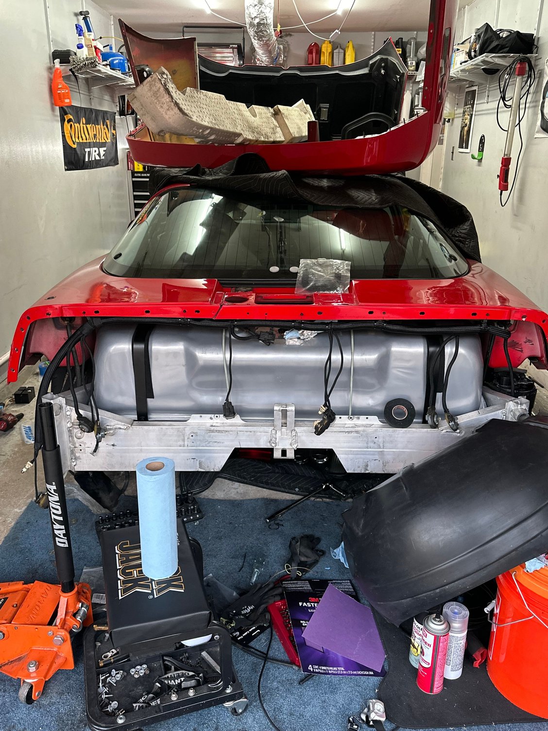

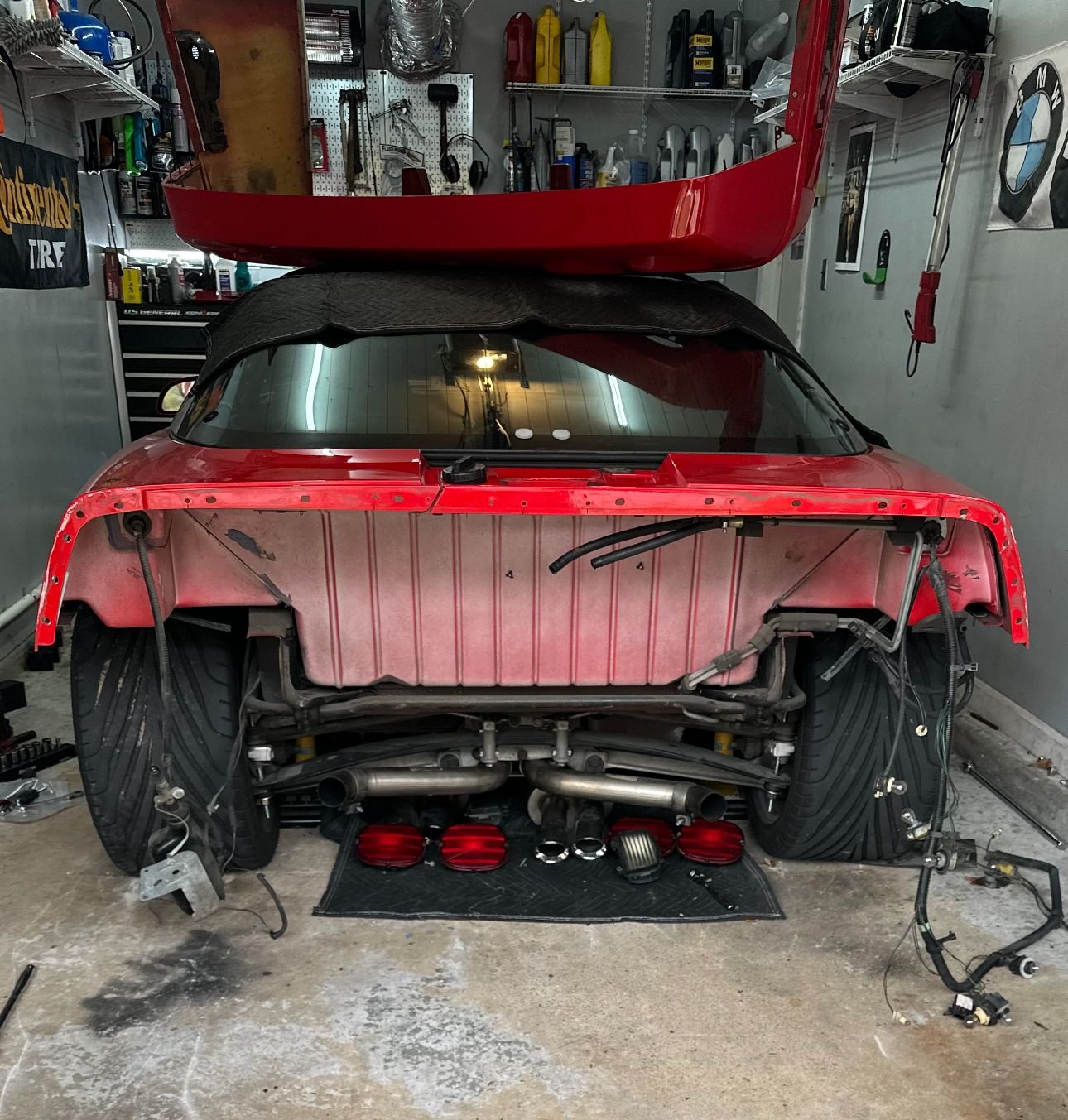

Well I got the old lady back together today from doing a gas tank swap. Must say it wasn’t nearly the PITA I was expecting it to be. Most tedious part is the bumper removal. Once that was out of the way everything went smoothly. I spent more time cleaning everything than I did actually turning wrenches. If anyone has any questions about doing this it’s still fresh in my head.

Nice looking tank.

Does certainly look good! For sure you slipped a copy of the 'Build Sheet' back secured by a tank strap?

Looks like a brand new car.

Where did you source your new tank from? Your impressions of it? Inquiring minds want to know👍

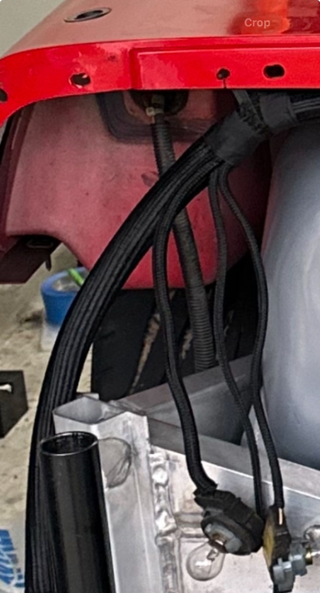

I cleaned the hell out of everything I could see lol. Also removed the cheap GM plastic wire protector and replaced it with some leftover BMW harness cover I had laying around. The wife couldn’t figure out why I’d make everything look so nice if I’ll never even see it. Because I can damn it! 😆.

So apparently there’s a few places that make reproduction tanks. I found one for sale on a Corvette parts site that was coated. Price was ridiculous. Found the same manufacturer on RockAuto. I wasn’t too nutty about it being made in a foreign country 😒…….but it fit perfectly. The suppled bolts for the sending unit were junk. I soaked the factory ones in brake cleaner, then painted the heads with black rust converter. Everything bolted right back up with no fitment issues.

Yeah, I noticed that initially. I tried to zoom in on it but couldn't really see what you used. It looks like good quality stuff.
The tape i used is a high heat harness tape also for BMW/Mercedes. Stuff is fantastic and light years ahead of anything I’ve seen on a GM car. 7 bucks a roll off Amazon. It’s glass cloth based. I always keep a spare roll around.
