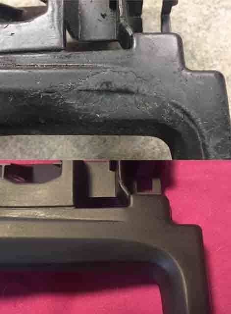

Did my several years ago. Stripped the coating, glass media blaster, then used trim coating. No paint. So nothing to scatch off later. Got the process from Joe C.
See this thread. Console restoration
Her's a before aftr from mine
