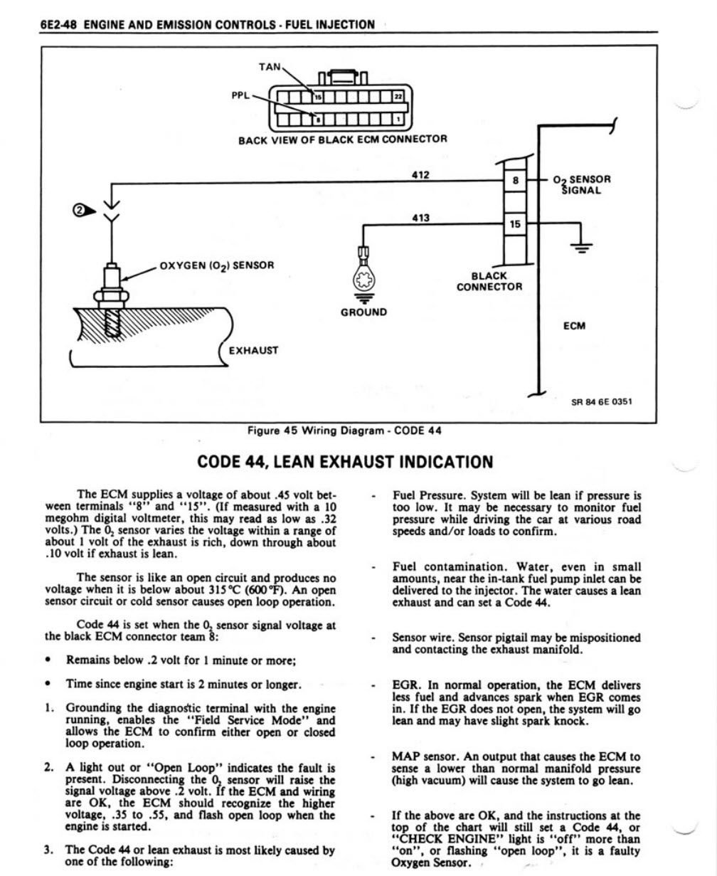

First thing is get a 84 GM service manual, but to shortcut that, here is your starting point and what you need to check right now...right out of my 84 GM manual. GL

One other thing. The 84 corvette wiring diagrams is a separate manual. The 82 corvette has everything in one book, the 84 does not. You may want to order this as well.
84 corvette electrical supplemental
