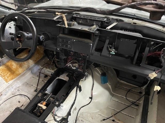

Finally at the point where I'm largely no longer disassembling and actually starting to put some stuff back together. The car was a northeast vehicle that appears to have spent some time as a boat. A lot of dirt, a lot of mud, rust, and animal nests. I had to completely pull the dash to find them all and neutralize all the urine.
The body is horrific. The car had been partially repainted at some point. I'm sanding it down and will be repainting it, hopefully by the end of February.

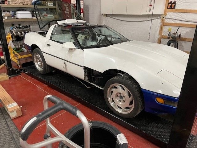

Starting to look like a car again. Replaced all the studs in the nose and tail that snapped off when I removed them with stainless jobbers:

Those should not be studs. The should be a fine thread bolt. Currently as it sits, your hood will get damaged when it closes.

Thanks! Been so long since I took the nose off, I forgot. Glad you spotted it so I didn't find out the hard way. All that hardware was corroded when I took it apart and they all just snapped off and I threw it all out. I ended up having to make new backing strips in a couple of spots from sheet metal because they were so rotted.
They are the same thread as the studs on the rear bumper, for reference. 5mm x 0.8.
