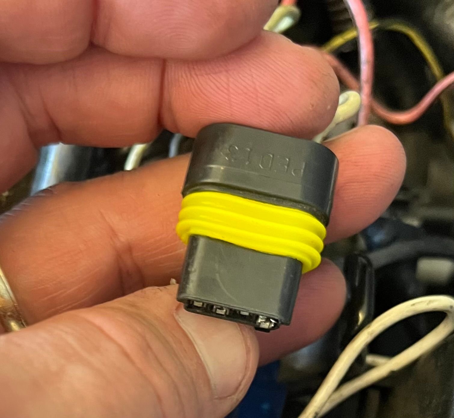

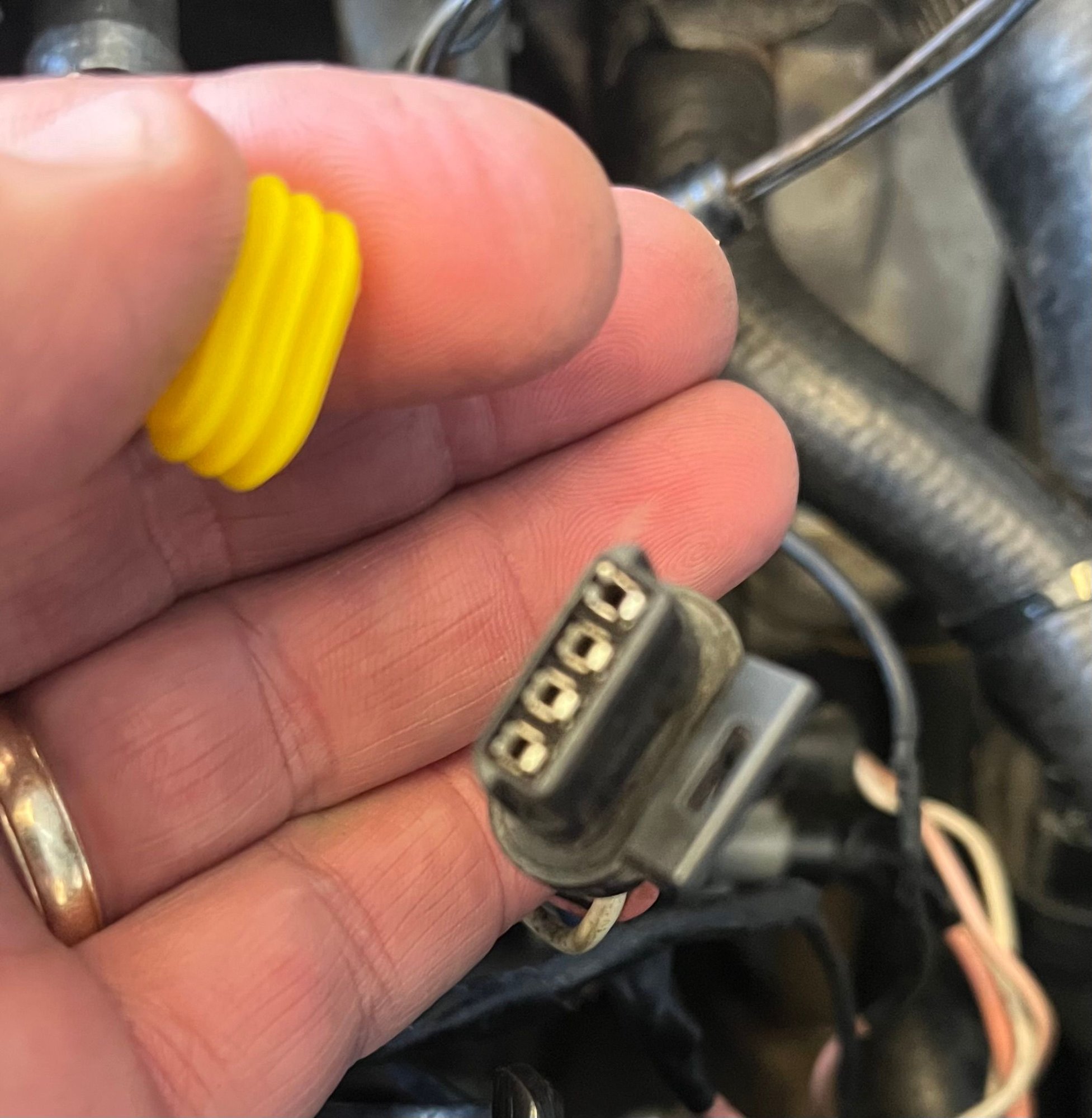

UPDATE!!! Fixed. I replaced the ignition control module Monday. Well I didn’t realize when connecting the connector to the module, the weather pack seal fell off. The connection was loose and contributed to the stalling and no crank. Put a new weather pack seal on the connector and so far so good. 🤞🏼
Was driving home from work and it just died in me. Cranks but no start.
paper clip the ibd1 and got h62-engine oil temp sensor. Would a failing/bad sensor cause this issue?
