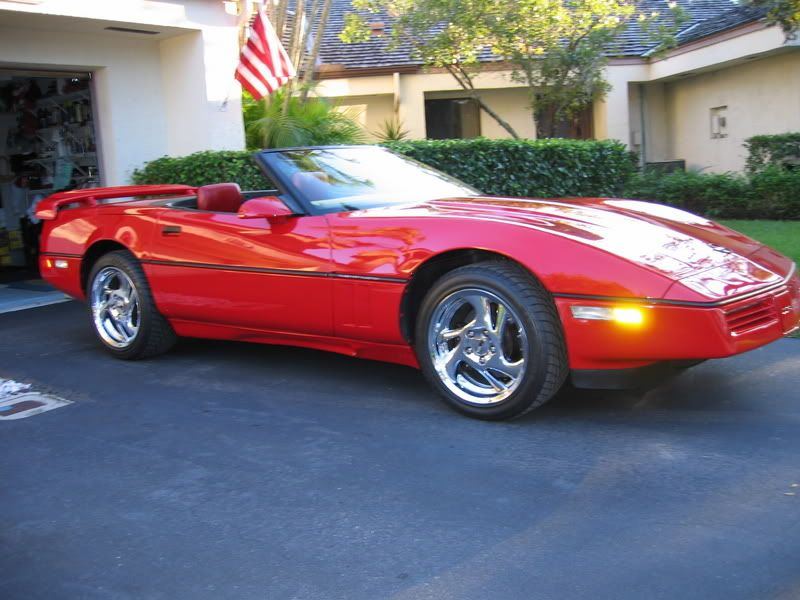

Here is my car I had to show you not blowing smoke?
