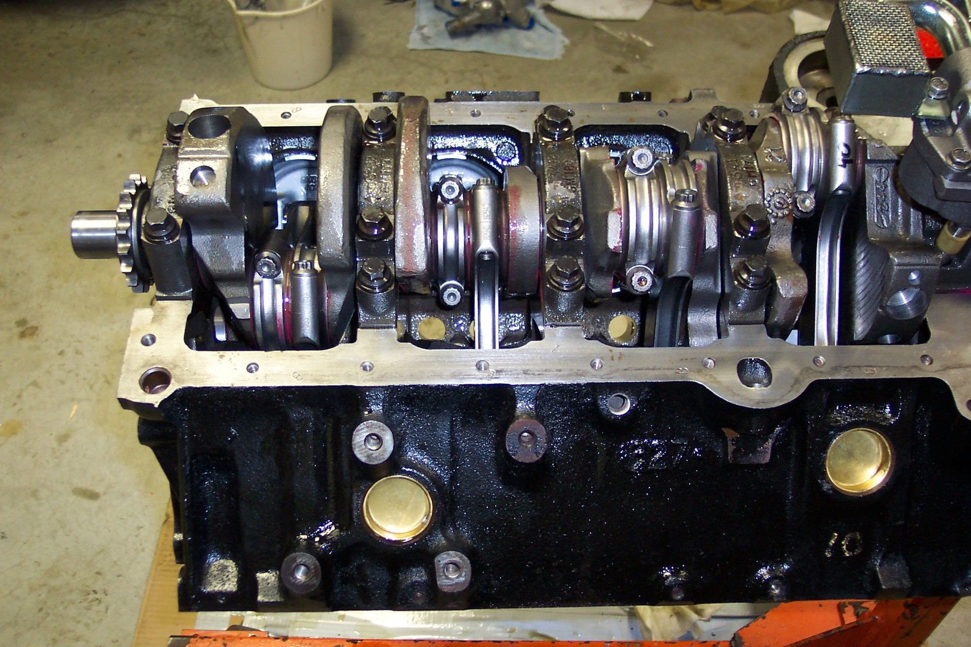

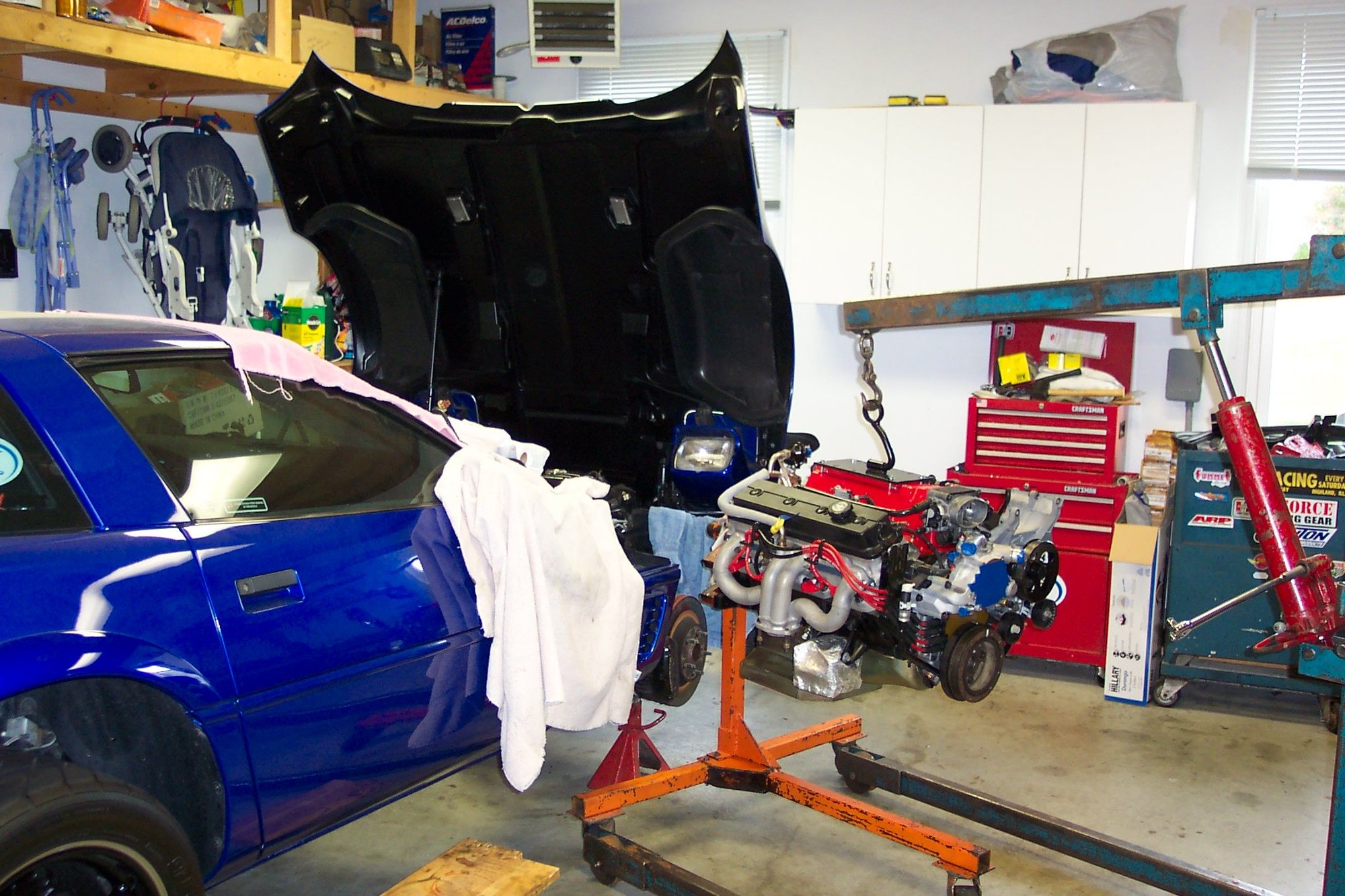

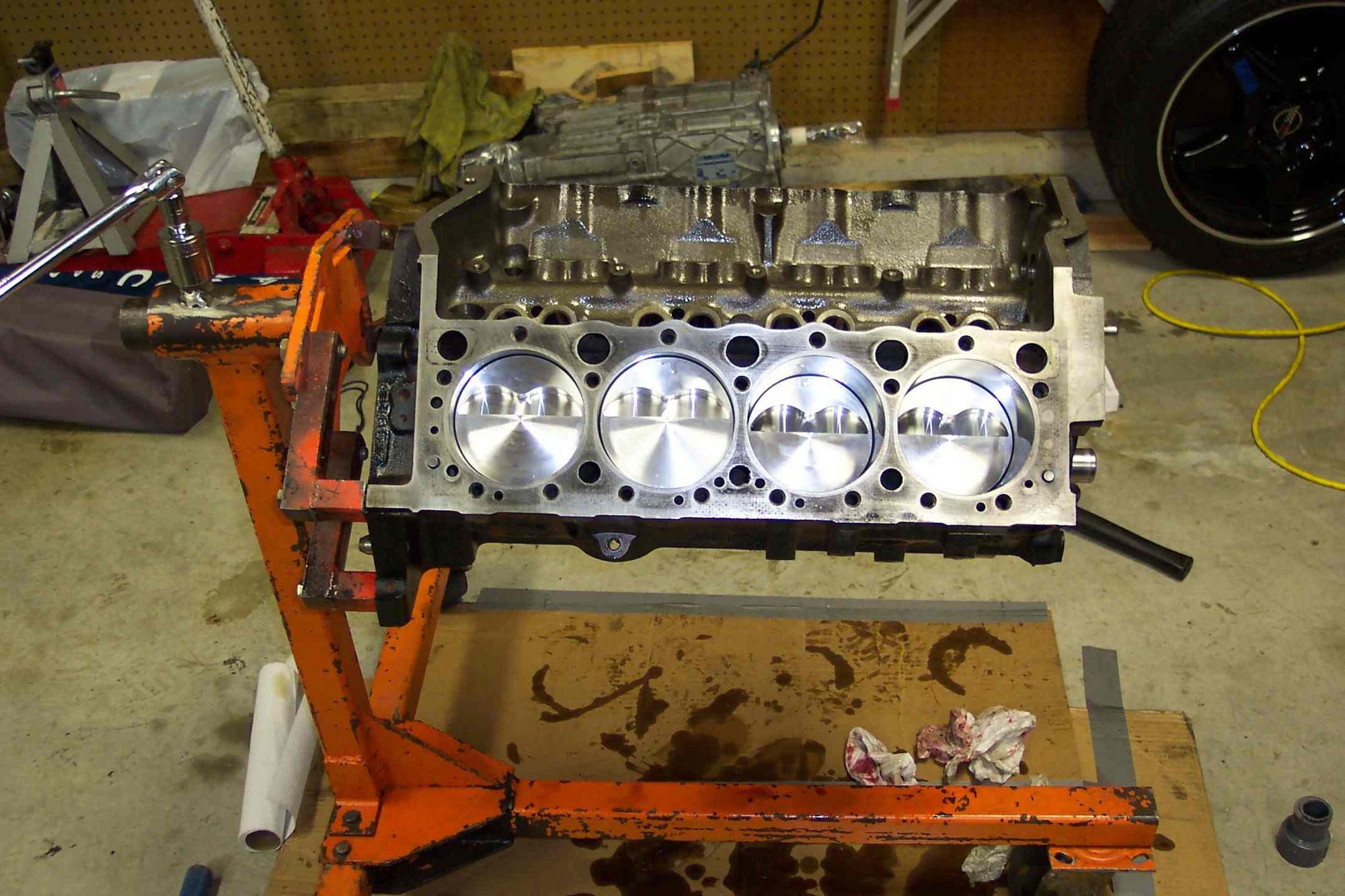

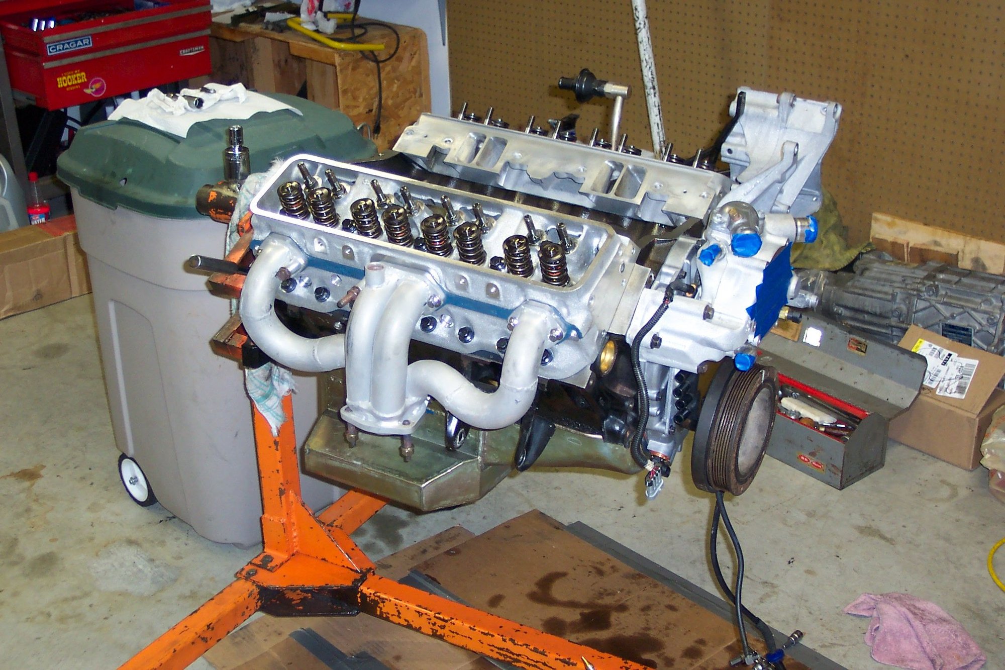

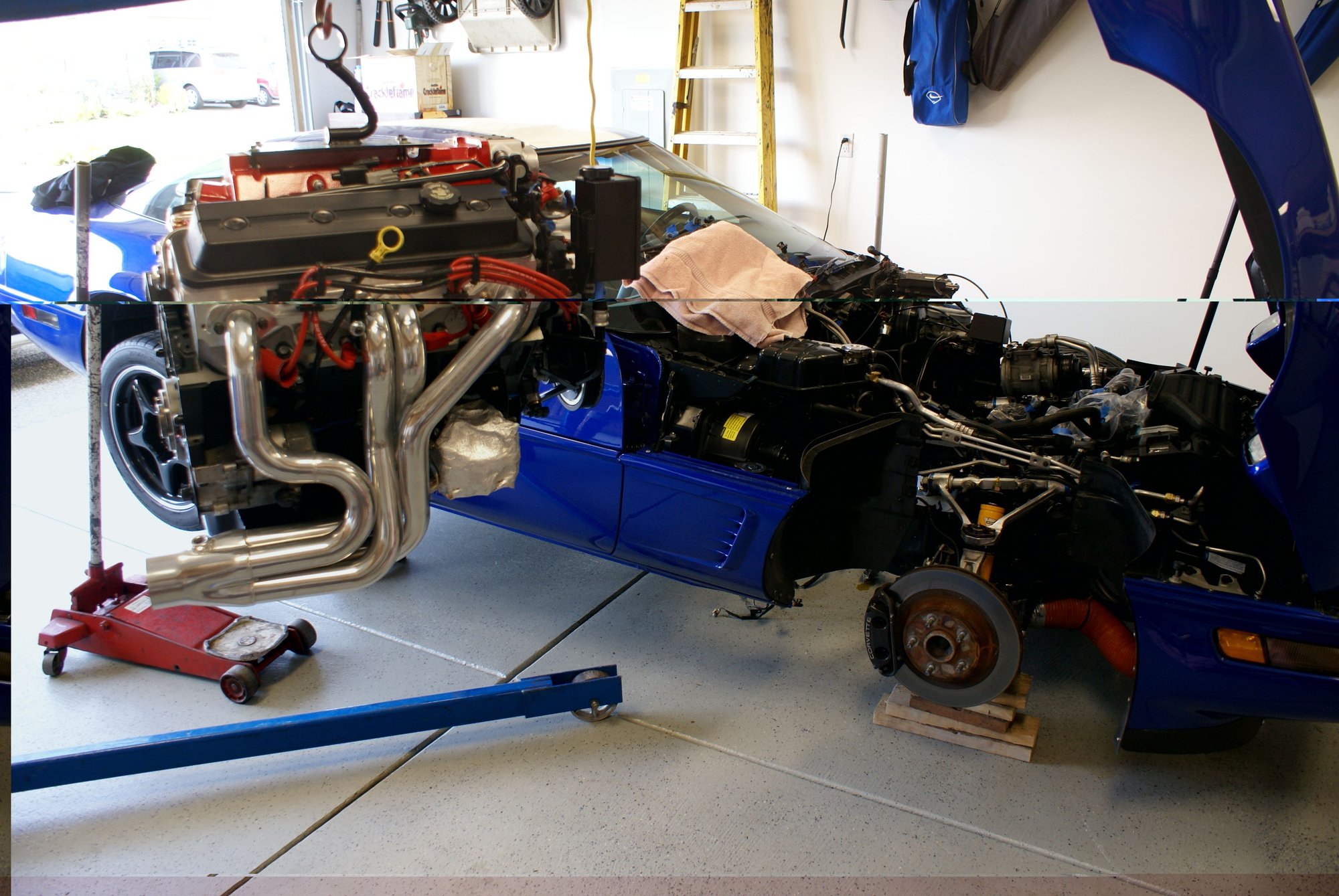

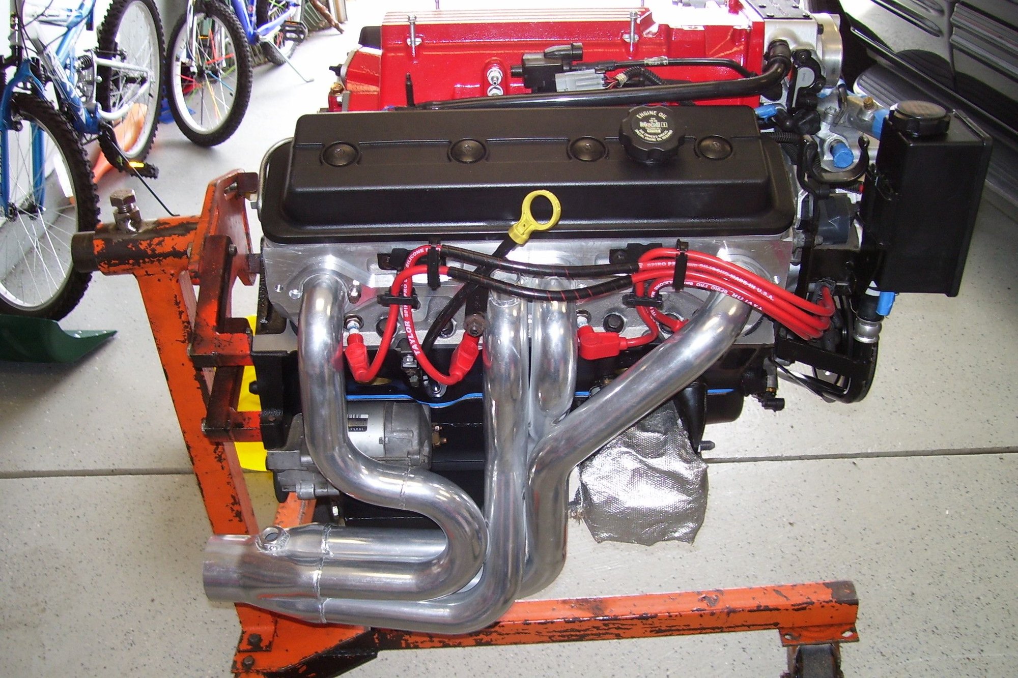

For what you'd spend on a reman, if you can do some of the work yourself you could rebuild the existing engine (unless of course you put a rod through the block).
Take it out, tear it down, have the block, heads, crank, and rods/pistons gone through and cleaned up/refreshed at a machine shop. Add new rings and bearings, and then reassemble. There's a little more to it than that.....but not much.
Just to give you an idea of what you're up against....

96 GS, really nice job on that build. Looks great.

Where did you get that engine lifting plate? Sweet!
Also, which headers are those?

Wondering the same thing about that sweet plate

The plate was from "TPIS" and it was called the "Happy Hooker". I don't think they sell them anymore but they're probably still out there used via eBay or similar.
The shorty headers were Hooker shorty headers.
When I built the 383, I went to full length Exotic Muscle headers
