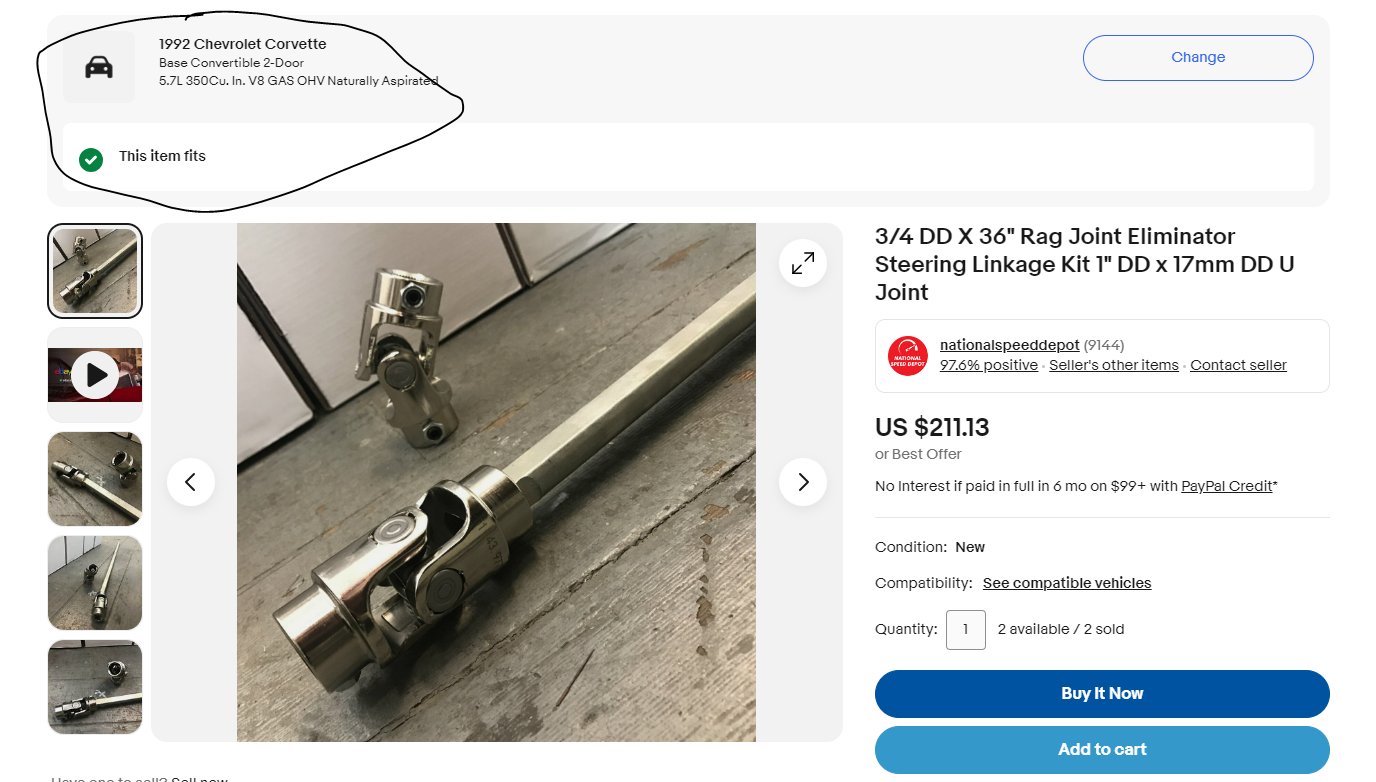

That said, there's nothing special about this linkage. Some time with a steering linkage manufacturer's catalog and a tape measure should be able to produce a remedy and eliminate that rag joint. Or something like this where somebody's already done the homework:
https://www.ebay.com/itm/254716118109

Originally Posted by turbo6inky
I stand corrected, I hadn't removed the plastic cover yet. Thank you!
That isn't necessarily a 'solution' .
That depends on the problem definition, right?
"Is the part available from GM?" If yes and you want the car original, replace it with those parts.
"Is the part not available from GM but I still want it to look stock?" If yes, then maybe take the joint apart and replace the fabric with a disc from somewhere else? Looks like you'll need a pretty big rivet gun to pull it off.
If the the problem is, "I want my steering to not be mushy and full of parts that I can't replace." then eliminating that section of the linkage in favor of OTS parts from the aftermarket is a solution. Saginaw steering parts are not hard to find, even the metric ones. The Hot Rod industry has a solution for all of this, but there may be some cutting and grinding involved. YMMV.
Any time you're dealing with a machine that's been out of production for thirty years, you're eventually going to have to resort to making your own parts or paying somebody else to make them for you if you want to keep it going.
Agreed. Doesn’t look to be a true bolt in fix solution. There are better alternatives out there that are a tenth of the cost.
Well now we've gone off into crazy town.
Where are you going to get two U joints and a few lengths of D tubing for $21?
