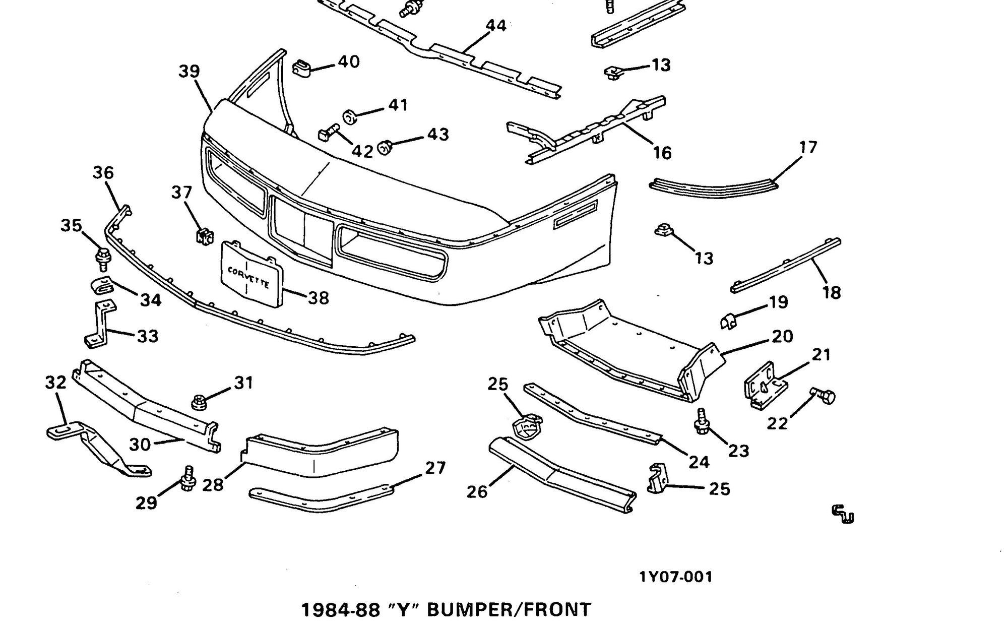

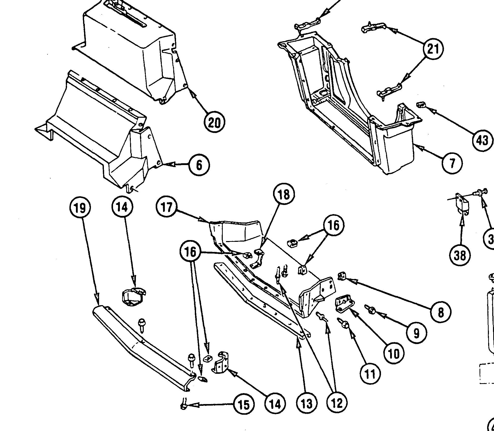

In this image what do you believe is missing?
Or this one maybe?

thank u i believe number 20 is the part i am looking for thank you again !! z/28

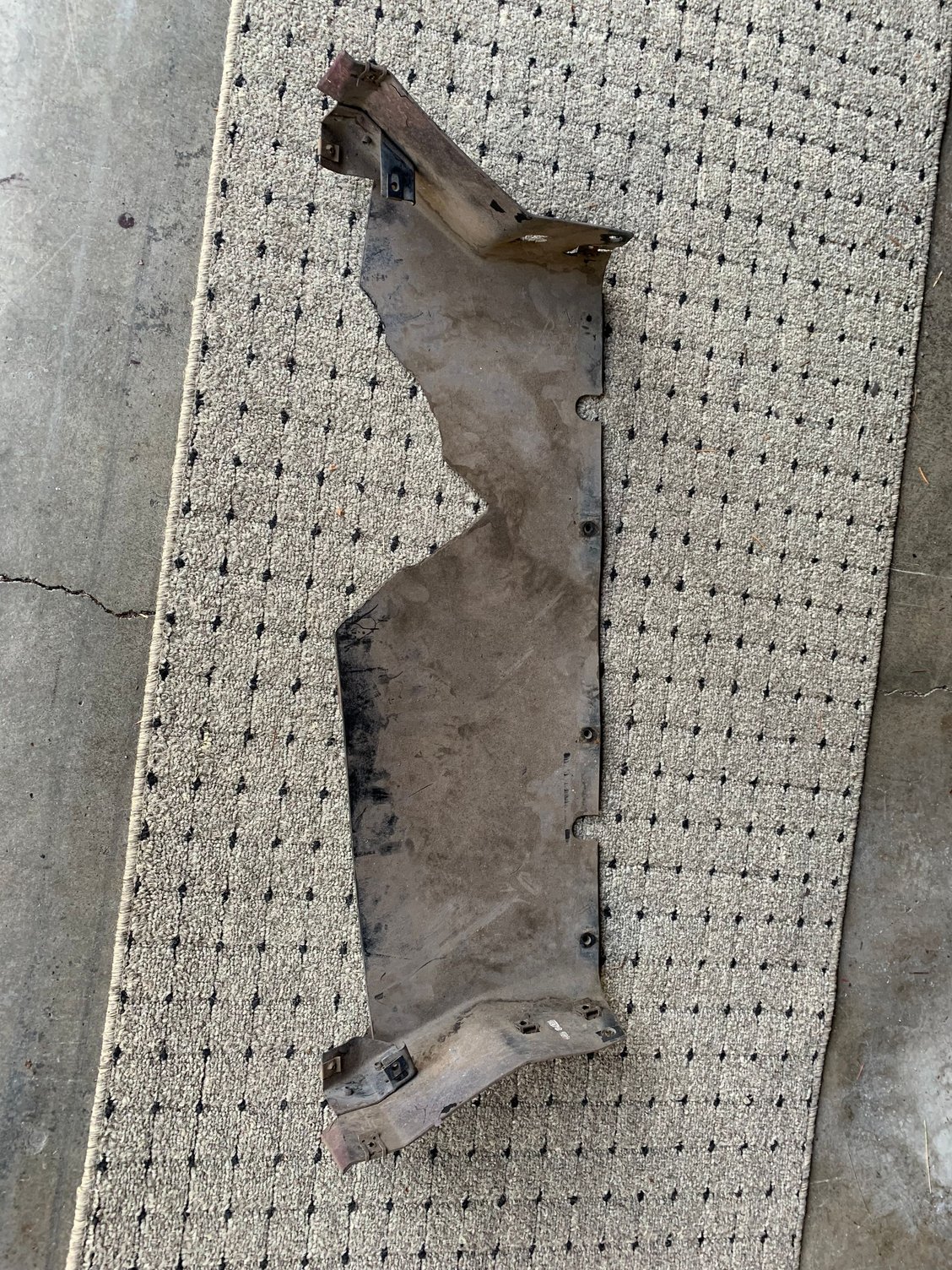

I had to replace the trashed lower baffle on my '84. The part number is different than 85-89. You will also need the 84-96 lower air dam center retainer. I found a used baffle on Ebay and it had the original retainer still attached. Lucky me.
Old broken one.

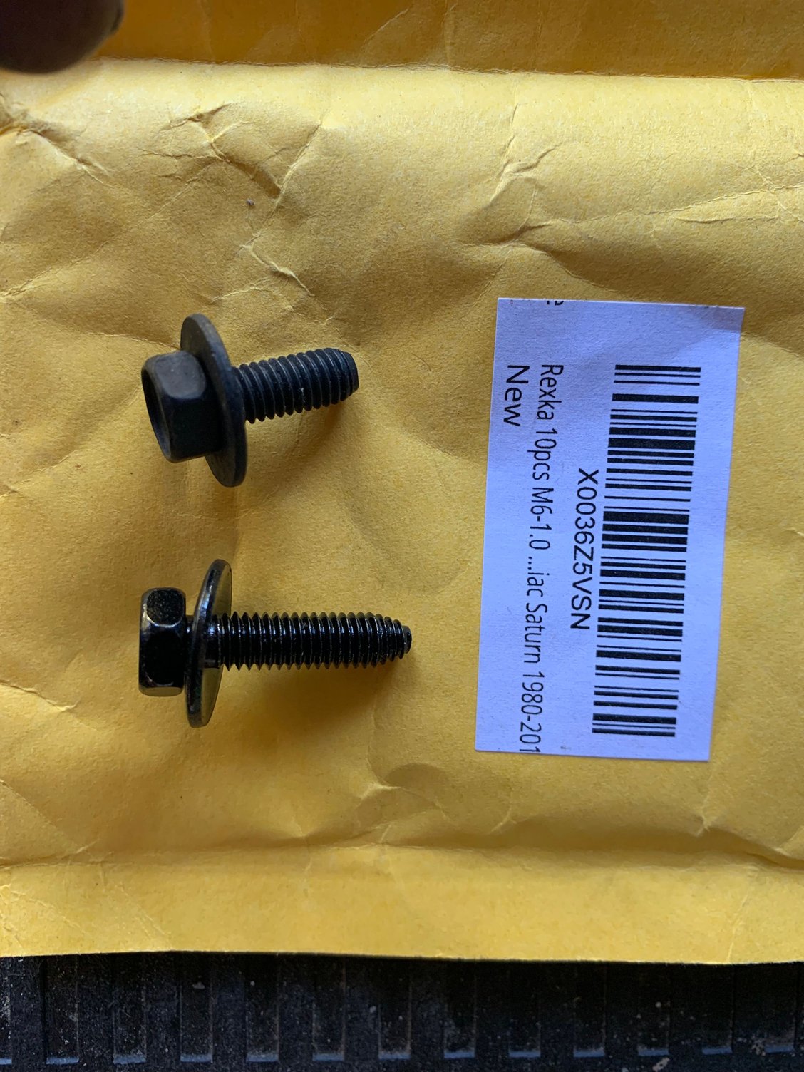

If you're thinking of buying the air dam retaining nuts and bolts from Zip they were too short. I found these longer ones on Amazon.
Much Better!

#20 as mentioned by@typical boomer is different. The '84 part number is 14030214. That is something to keep in mind. I believe a correct '84 part would have that number molded in to it. #26 in that image would be 'car color.

It's different, not because of the upper and lower radiator support pieces, it's because of the upper baffle/housing part that holds the lug wrench ('84 only). The "vertical" ends of the lower baffle are different to attach to the upper "lug wrench" baffle.👍
edit: Another difference, is the molding/holes of the center to accommodate the bottom arm of the auxiliary pusher cooling fan.

Ok so I'm confused. OP do you need the bottom of the air dam or the plastic block off that holds the lug nut wrench on an 84? I have the piece that holds the wrench but not the air dam floor.
Do you need #20 from the first or the second picture?
He should need #20 from the first.

Ok. I don't have that one. I have #20 from the second pic.
