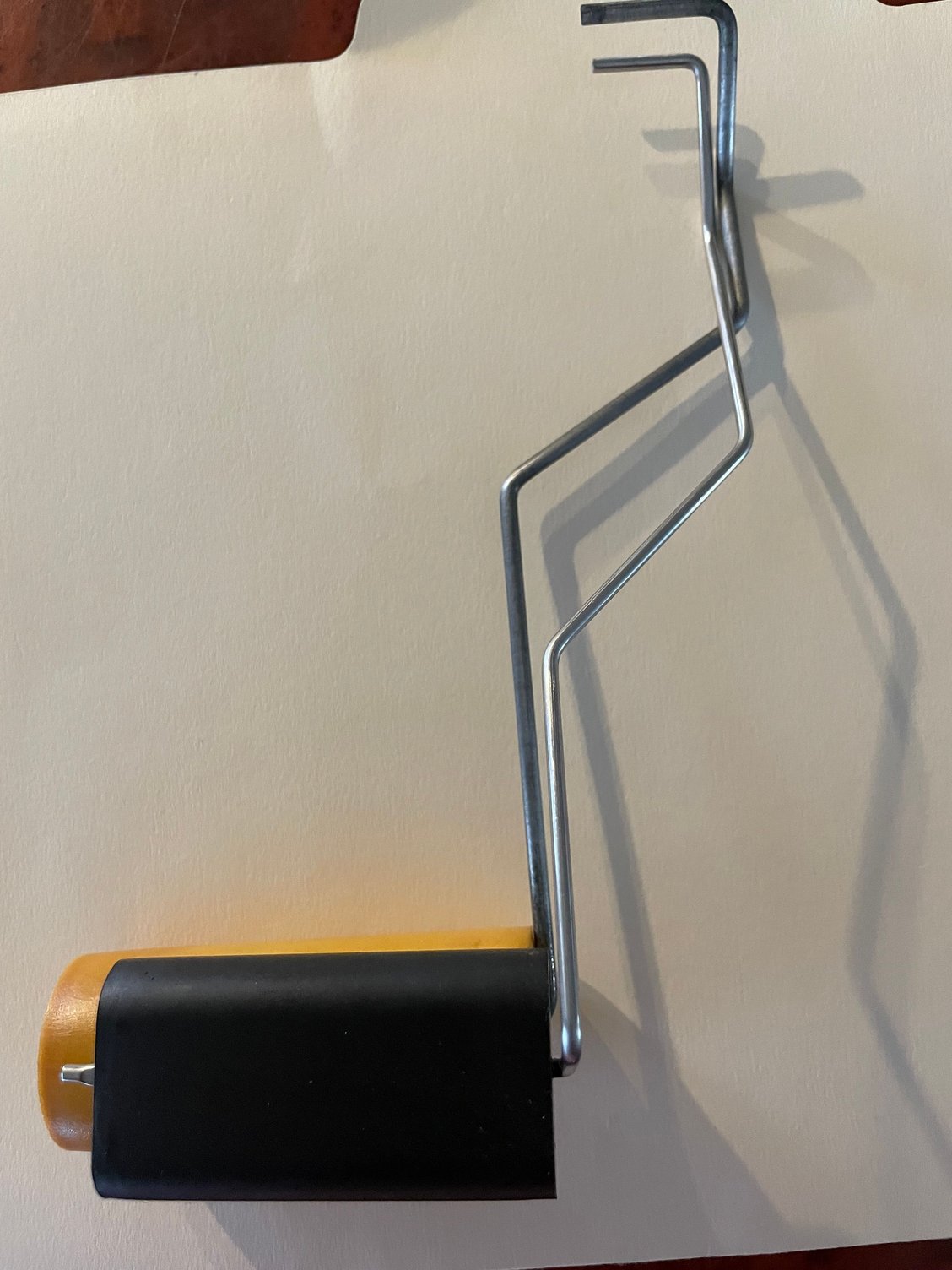

Yes, I did see what you did. Well, here’s what happened yesterday. When I took the old unit out it was registering a 1/4 of a tank of gas. I was expecting to see something similar with the new one. But it was always empty, reserve, check gauges on the instrument panel. I had tried everything including comparing the float arm from the old to the new.
As you can see, they were very different. So I bent the new one to match the old one. Put it back on and installed the new assembly. No difference, same as before. I had exhausted all my ideas, so I decided I would go and fill the tank and see what happens. $75.00 later the gauge was working and reading full. There was never a problem, just a big difference in the reading when I took the old one out and put the new one in.
so now I will keep and eye on the gauge and refill to get an idea how accurate the gauge is reading.
Thanks for all the help.

I think the aftermarket units are actually made to work perfectly in a different car. Which one I have no idea. Someone figured out they kinda work in a C4 so they started selling them for C4"s. The one I bought was closer to stock than the one you bought. I repeat, none of them work perfectly out of the box. With that said, I have seen posts where someone bought an aftermarket that did read correctly. Sounds like a crapshoot. Hope it reads right for you. Dan
Old Apr 14, 2024 | 08:20 AM
powerplaytwo's Avatar
powerplaytwo
Joined: Jun 2019
Posts: 276
Likes: 69
From: Florida
Dan, you hit the nail on the head, “it’s a crap shoot”. Aftermarket parts never fit, function, or are as good as OEM.
I will have to see how it goes.
Thanks again.
