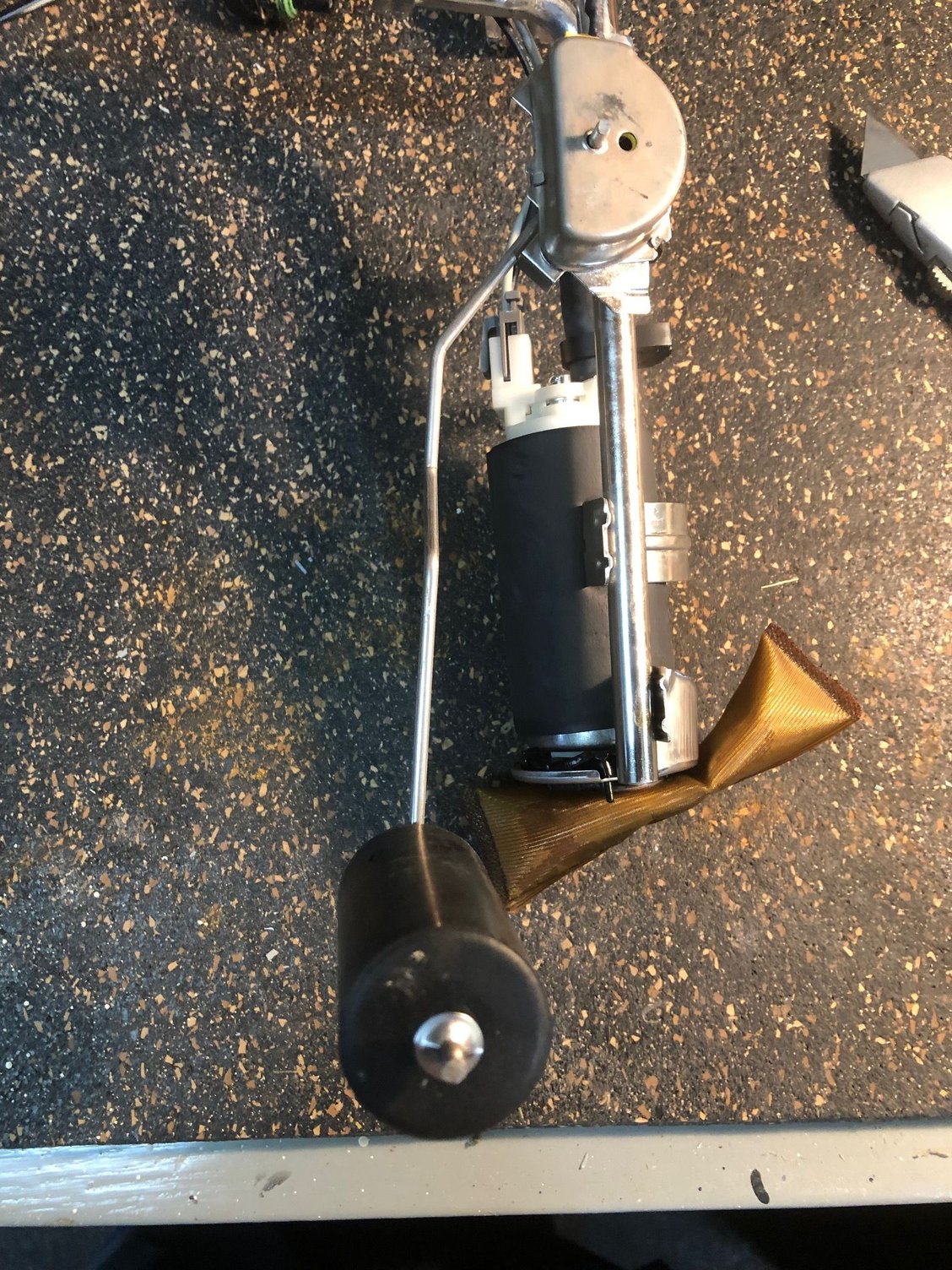

I got a new fuel level sender for my 96 a couple of years ago. I was happy that I at least got a signal from it. After keeping track of the level shown on the dash and the amount of gas needed to fill I knew I was reading about 3 1/2 - 4 1/4 Gallon low. When I got on reserve I still had over 5 gallons. Rainy day and since it is so simple to pull I pulled it out and bent the arm. My tank measures about 12" deep so at 20 gallons each inch is 1.66 gallon. So I did not want to overshoot I shot for about 2" change of the float level. Attached are starting photo, picture of untouched float and after bending. See after bending the sensor is not on the stop but will still move down to the stop. Before I started I had 2 bars and the reserve was lit. After bending I show a solid 1/4 tank. I disconnected the battery so I lost my trip on that tank (dumb) but I will check it out over the next year. Dan

Truthfully I would keep it a good inch above sock, better to fill early then be wishing you had that extra

Thanks, I think I am OK. If not I will know early next Spring. Just got tired of having one bar, reserve lit up and "Check Your Gauges" all lit up with only 14 1/2 gallon used. Dan

Yah you're float needs a little tweek, but if you're in the position again with sending unit in hand take a feel inside tank and see if inner bladder seems to fit contours of tank Not bulging into tank. If it is that would show inner plastic liner has shrunk reducing tank volume.

Mr. s carter, Are you like 100% positive my 1996 has a liner? Every time I have looked in it just looked like metal. Thanks, Dan
