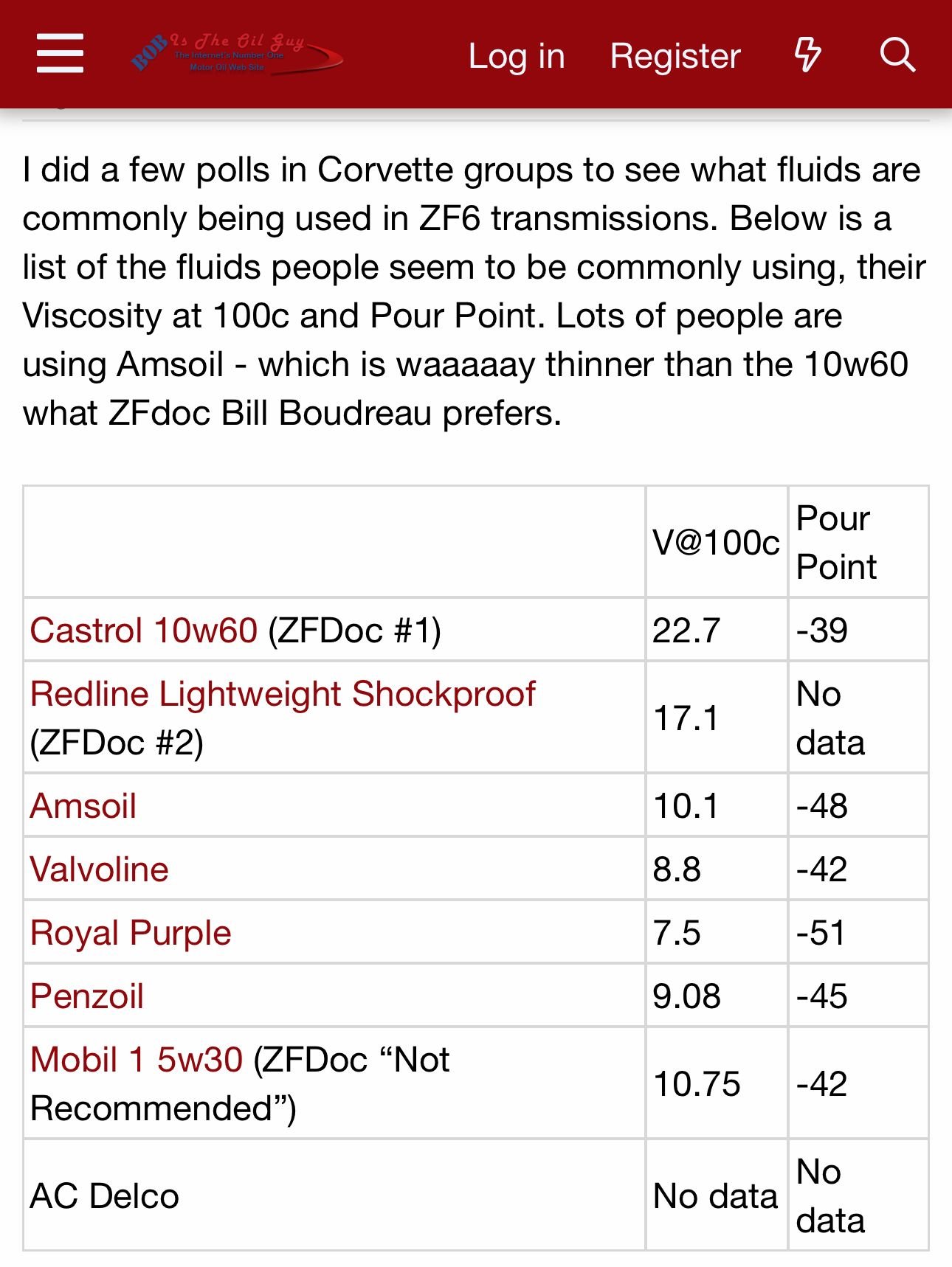

I agree. I’ve read this trans was also used in the Viper. Not sure how correct my info is. Very odd they don’t officially list an updated fluid recommendation. I did see this on
the BOBISTHEOILGUY site. It’s what made me hesitant to go with Amsoil.
