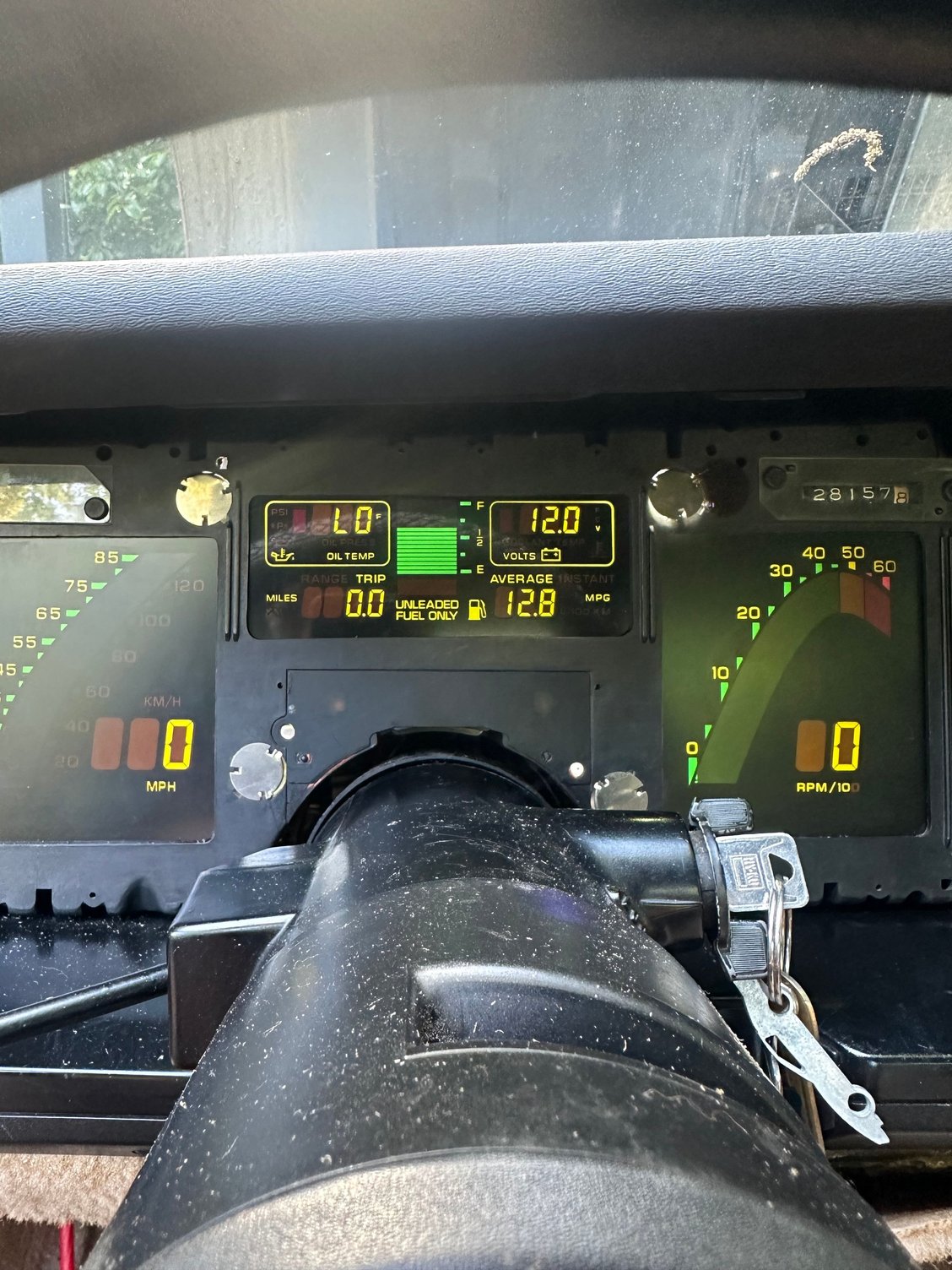

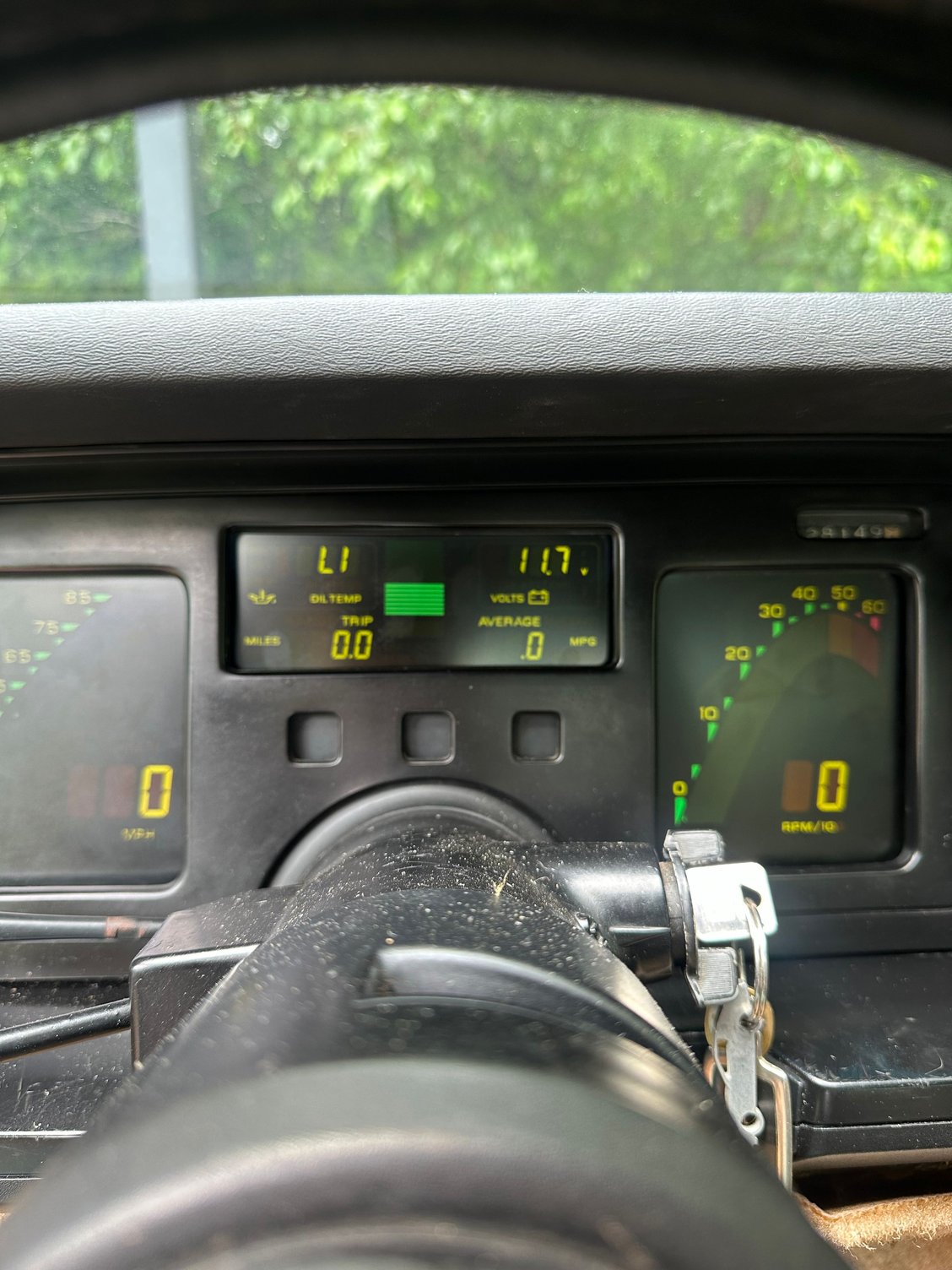

I replaced my 85’s RPM gauge with a new LCD a few years ago, and it went smoothly and turned out fine. I just got around to replacing the middle screen, the last one that was original, and i replaced the bulbs with led ones at the same time. Now, the screen is missing a lot of things, like the “unleaded fuel only” and the outlines to the different segments, and there’s a problem with the last number of the oil temp reading. I’ve taken it apart and everything looks to be in place, but i’m no expert. Could this be a faulty screen, or faulty bulbs, or something with the circuit board itself? Any help would be appreciated!

I had an issue like that as well. The solution, in my case, was that little spring that holds the middle panel was pushing the wrong way. I had it pushing down, and the side to side alignment was off. Here is a video showing how to reassemble, and at 5:50 he explains how to install the center panel.

It may be different on an '85, but on my dash the outlines and "Unleaded Fuel Only" are printed on, not illuminated.

Thanks for the response, I got another screen and installed it and it’s back to its former glory now, guess that’s a lesson to stay away from cheap chinese parts😂
