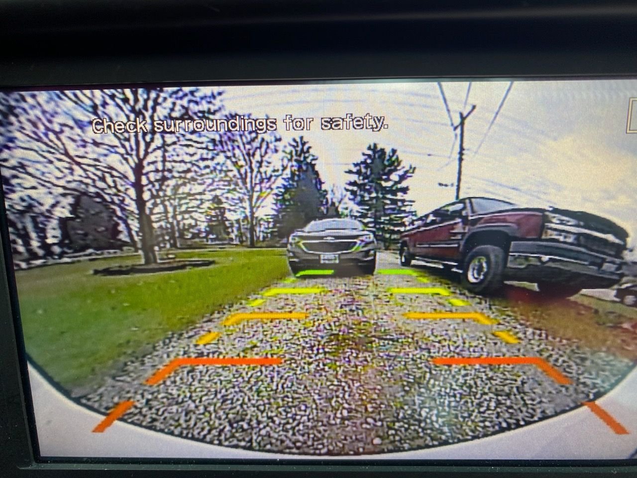

This is a view of our wired backup camera, the picture is actually better than the OEM one in our 2018 Chevrolet Equinox.
Keep in mind, this is a picture of a picture, so you lose some resolution

Thanks for the feedback mrlnd and drcook. Love that engine bay mrlnd. I appreciate there are wireless options, I lean toward a wired solution, just preference on my part. Roger that on your name Dave....I figured you were an MD; nice to meet you, I'm Barry. Appreciate the pics of the camera view, and your sony receiver. I'm going to install a kenwood head unit in mine while I have my interior pulled out.
