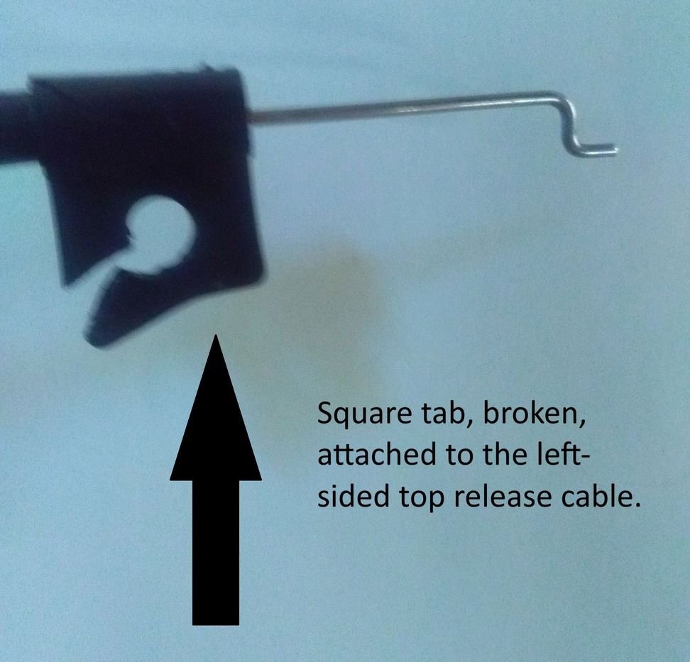

So I have managed to release the top by manually pushing on the mechanism that actually frees the pins from the latches on each side. I was then able to expose the underside of the deck lid and see that the cables are no longer secured to the underside of the lid properly. This mechanism was unique to the 1986 - 1988 convertibles, and was modified for the 1989 convertible. The plastic "squares" that hold the cables on each side are broken, and I do not see any OEM-style replacement parts available after an informal search of several parts vendors. I can include pictures of this soon, but would like to see if anyone familar with the 1986 -88 top release is familiar with the product pictured below - eBay claims it will work on the 1988, but I am skeptical as it bears little resemblance to the stock parts: https://www.ebay.com/itm/202560056444

Moreover, if the square tabs that secure the cable to the underside of the deck lid are not repaired by this kit somehow, are these the wrong part? my cables are not broken, just free from being secured to the deck lid.

Default Pictures of the problem
Here are some pictures. Am I correct that the square ends attached to the screws prior to breaking? Can I order replacement cables that have these squares and their cylinders intact? Can these ends be repaired?

That ebay cable kit you show doesn't seem complete, when I replaced mine because of a broken release lever it came with 3 cables and the squared part you refer to is made of metal not plastic.
