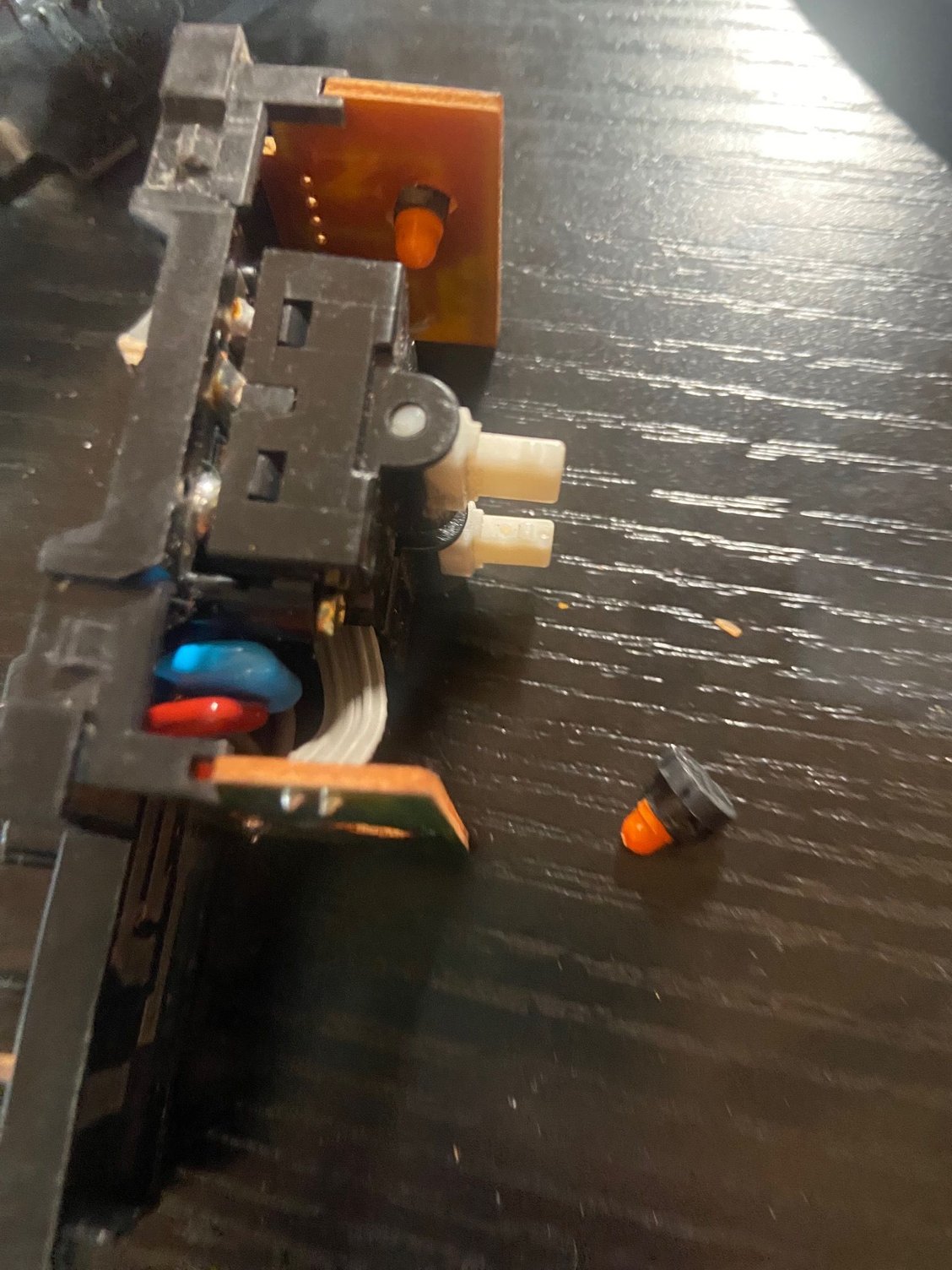

seeking a source for these lamps.
Prefer to not buy an entire switch, and new not used.

Use the cap/filter that I believe will lift off of your bulbs and I believe a T1 neo-wedge bulb is correct. If you would like to just try a bulb then maybe a generic 7219 wire terminal bulb and your socket could work.
Mouser shows obsolete as a JKL CNW1-7219 but there's a 14V potential CNW1-23 that could maybe do. I've no idea.
