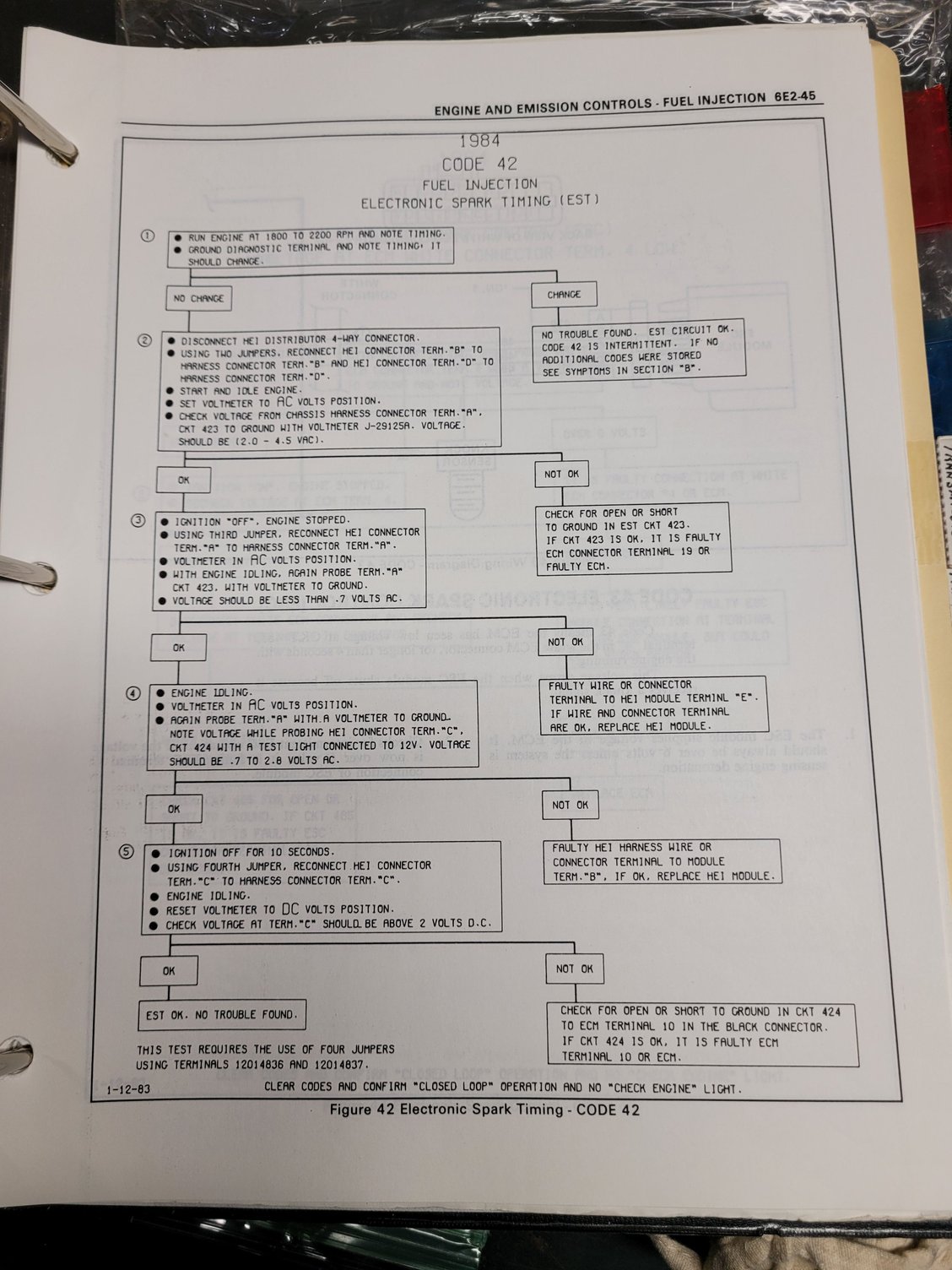

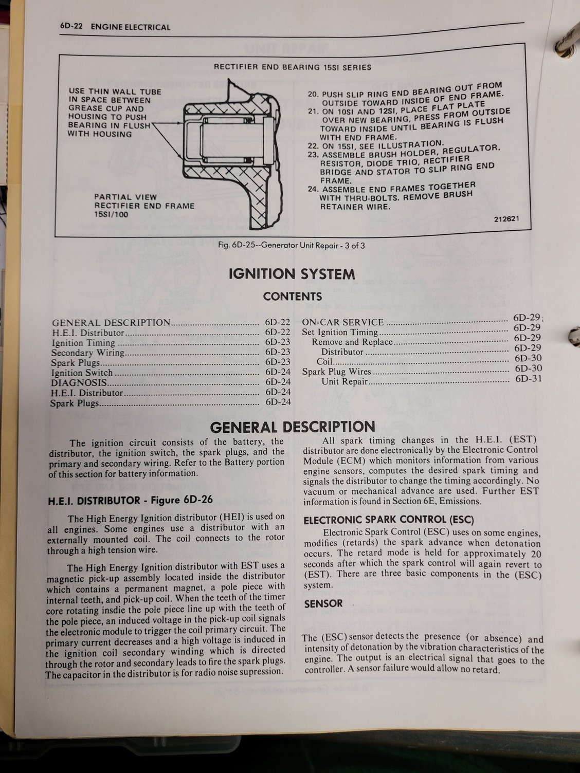

The ESC Module is only used to retard spark if the knock sensor detects engine detonation. Engine spark timing is controlled by the ECM through the HEI module in the distributor. I would highly recommend getting the factory service manual (FSM) as it gives detailed operation information and troubleshooting. Attempting anything else is a waste of time and money IMHO. Manuals can be found on eBay and other sources. Digital copies are also available if you don’t want to spend the money on a hard copy.

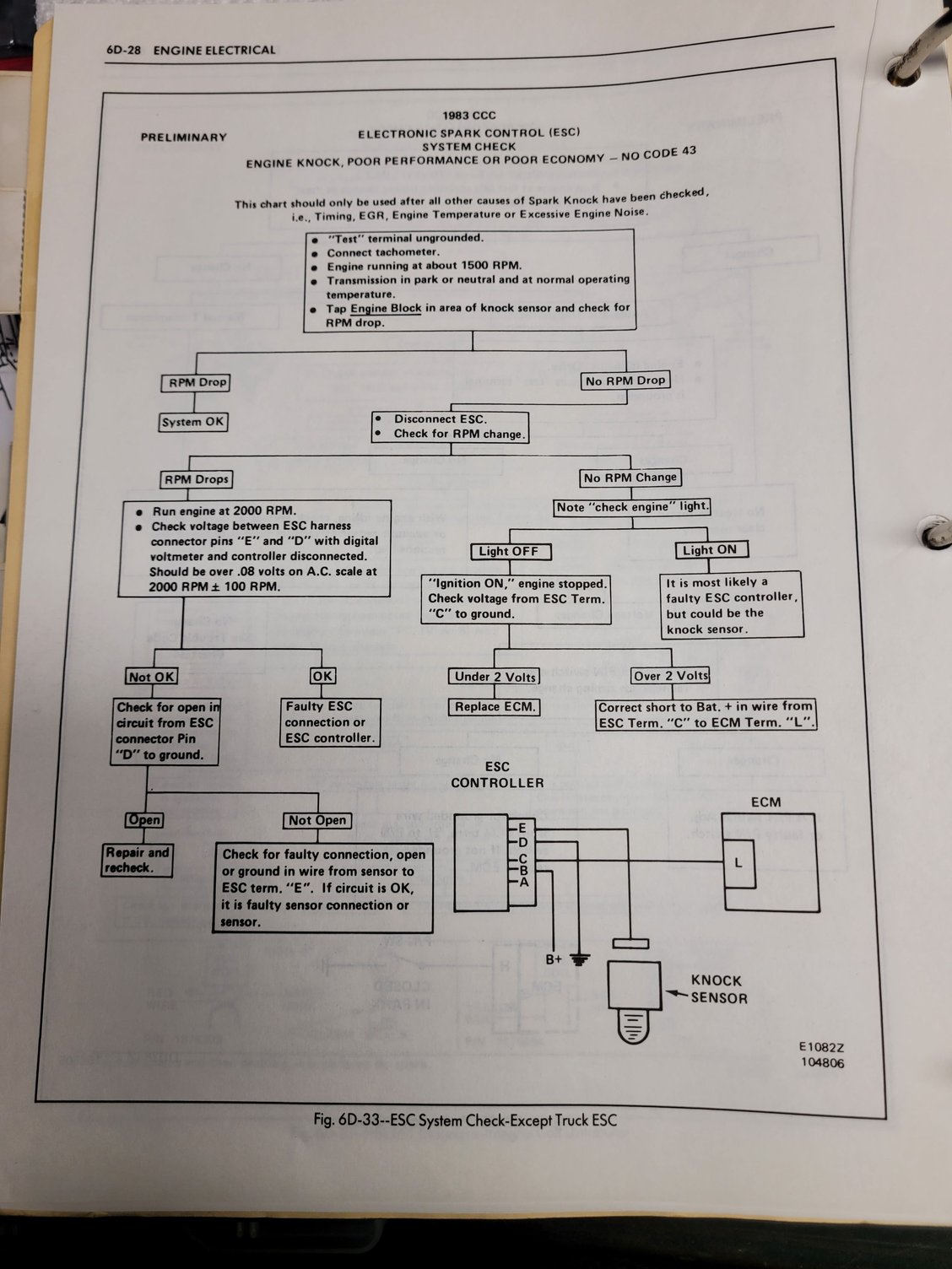

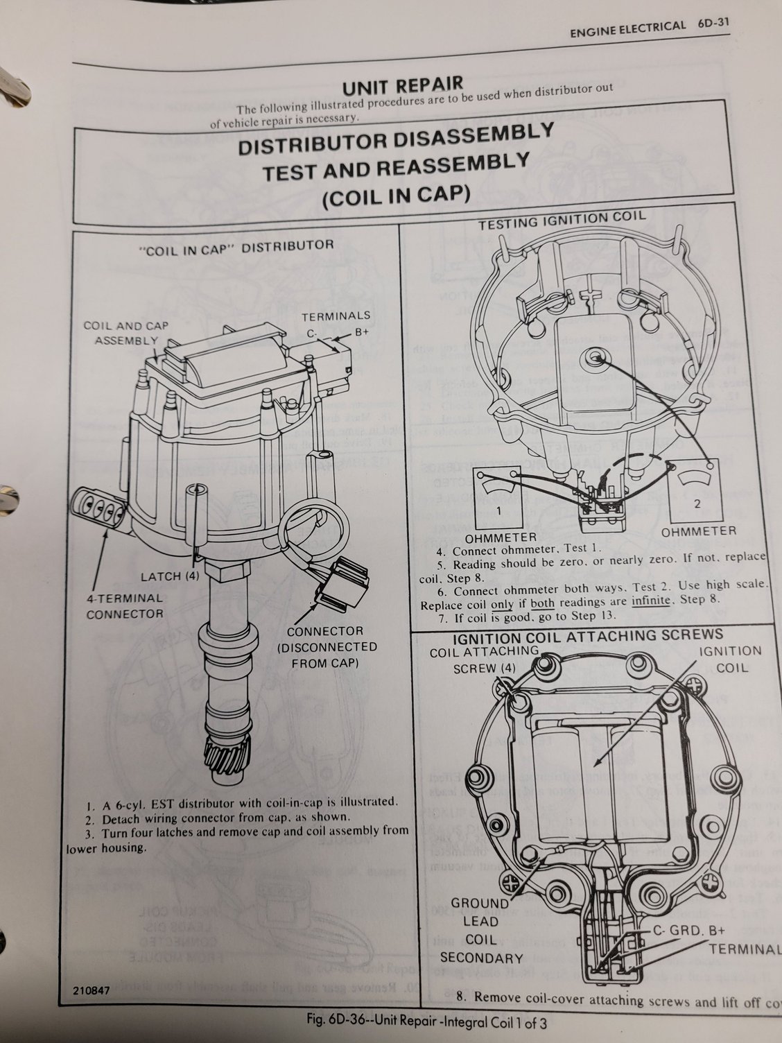

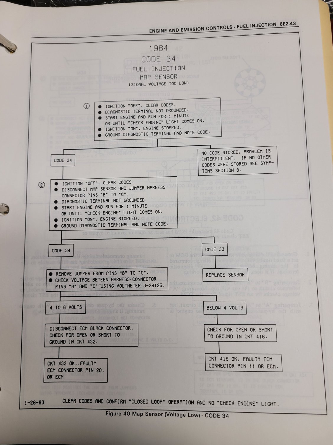

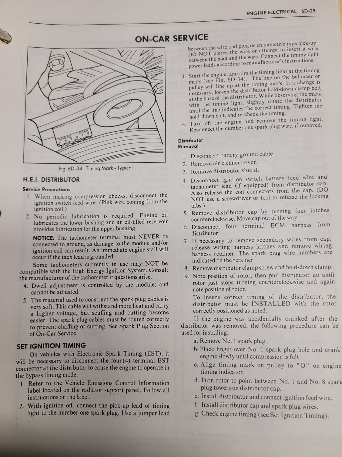

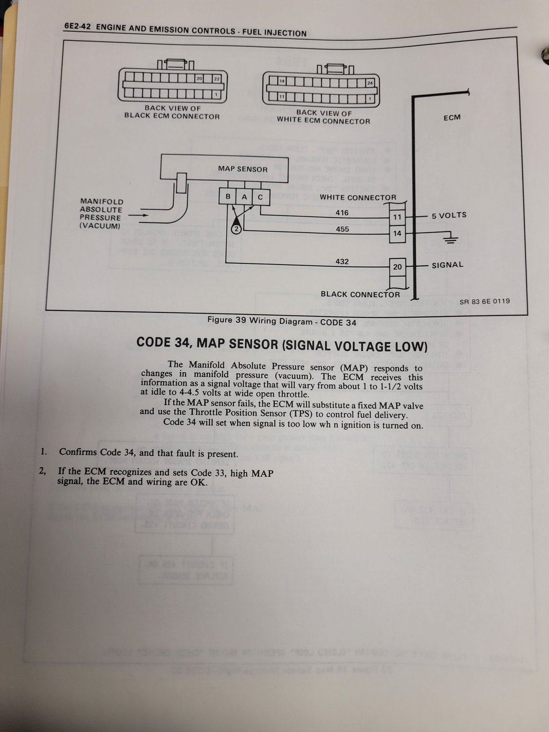

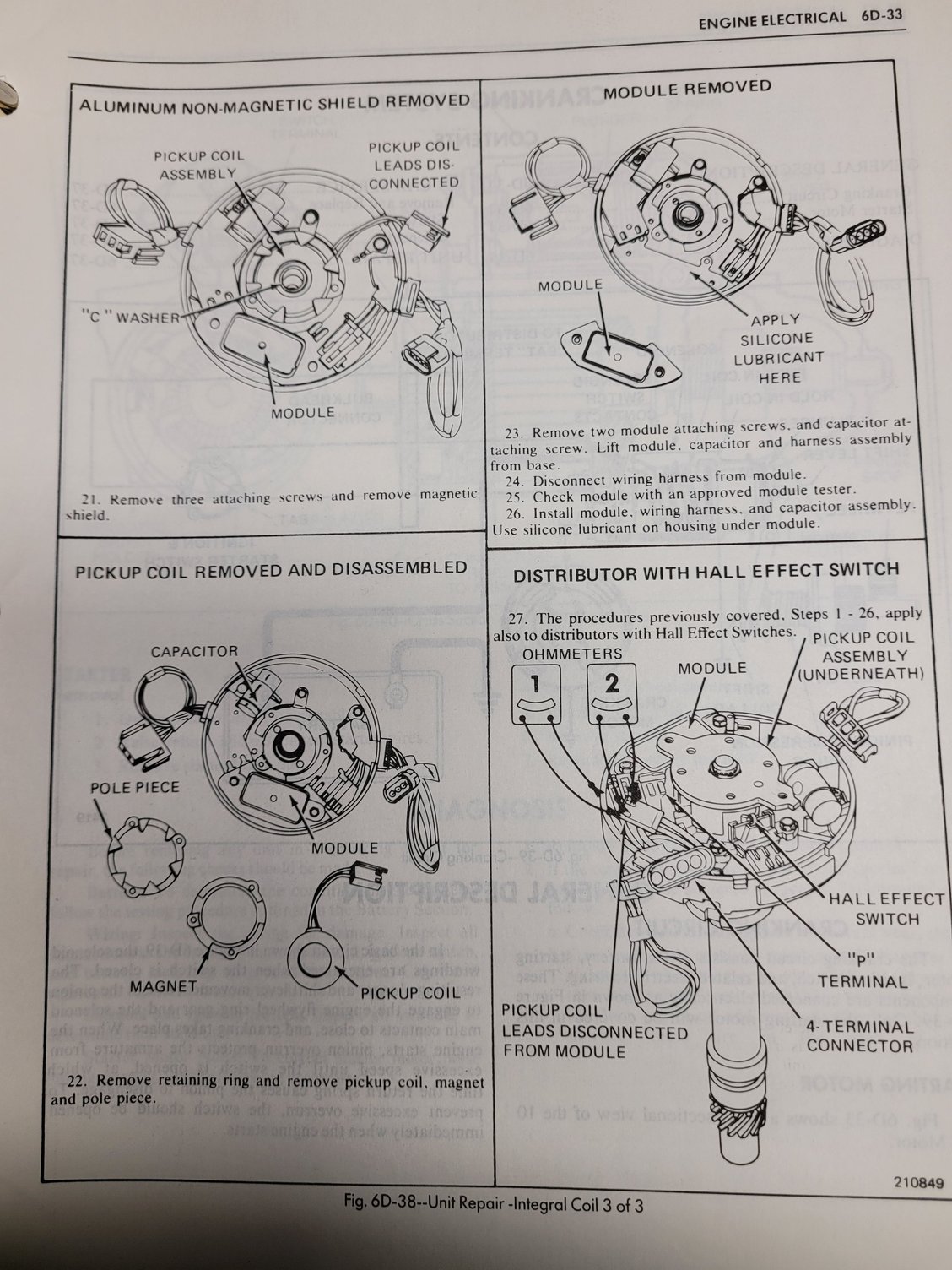

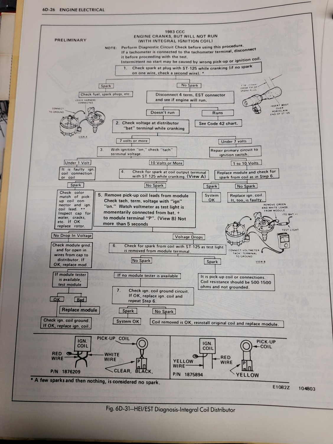

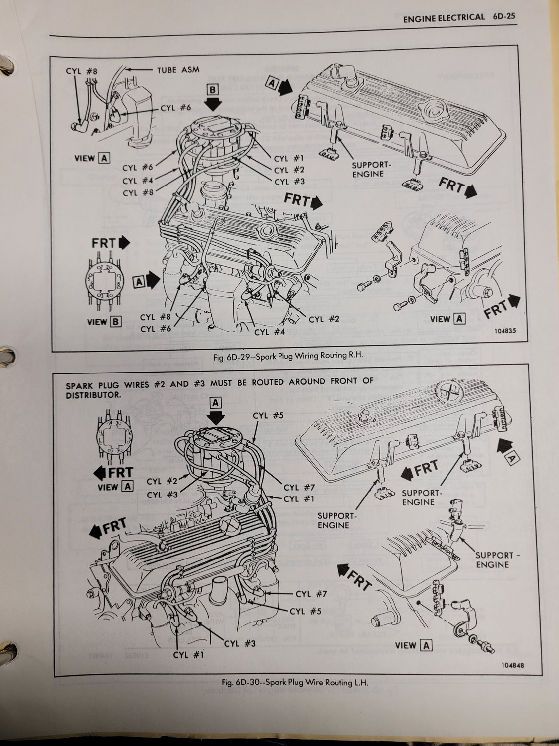

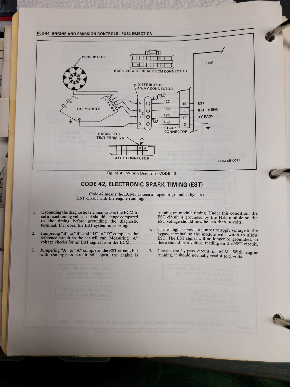

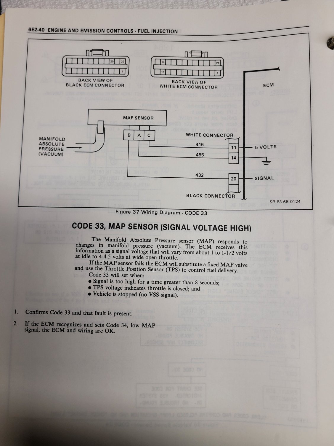

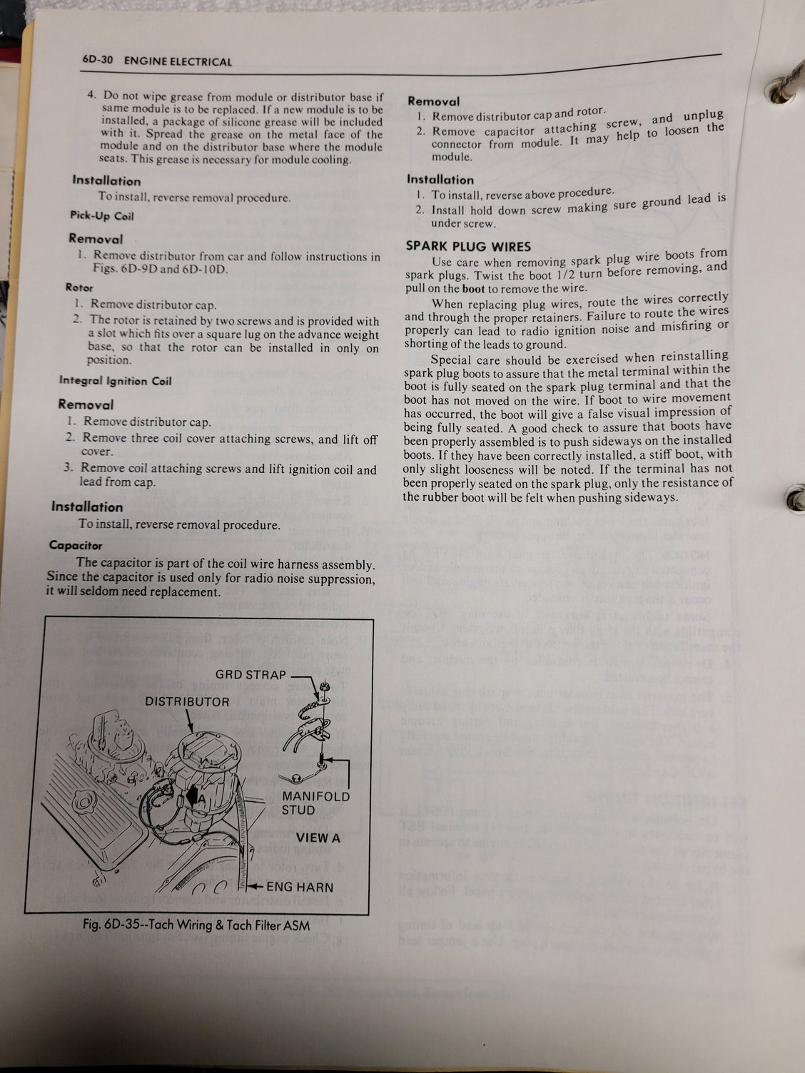

Here's probably a few too many, but hopefully some pictures of information you will need to diagnose your issues! Click on photos for better resolution! Most are in order, mixed up a couple....take note of page #'s! Good luck👍

Ok, that makes a lot of sense then. I know back in the day, they had an ESC system for carbureted cars... somewhere around 1977-1980, before they started implementing TBI, etc. But it was blowing my mind to think they had a little ESC system in that little module. Makes total sense what you said.
I'm embarrassed to admit that I actually already have the factory service manual (or as this one is called, the Shop Manual). I bought it from The Motorbook Store. I'm so used to asking questions on the forums, that I completely forgot I had it. I use them religiously on my Fiero, but have to use the Parts Book for better diagrams.

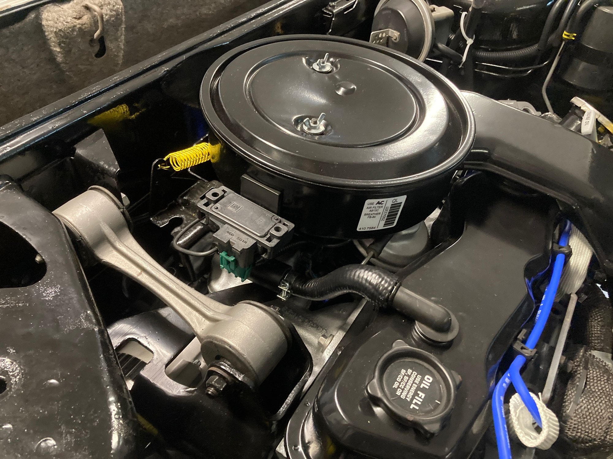

When she's done with it, it'll look as good as this engine bay does... she's really particular about making everything look as stock as possible, and painting every little thing... she even remade that little sticker on the air cleaner by finding all the pictures she could of factory Fieros from the 80s, haha...
Anyway, thanks guyss, I really appreciate it. MAP is fixed now... (vacuum line was unplugged), so when the new ESC module comes in, I'll test it out.
