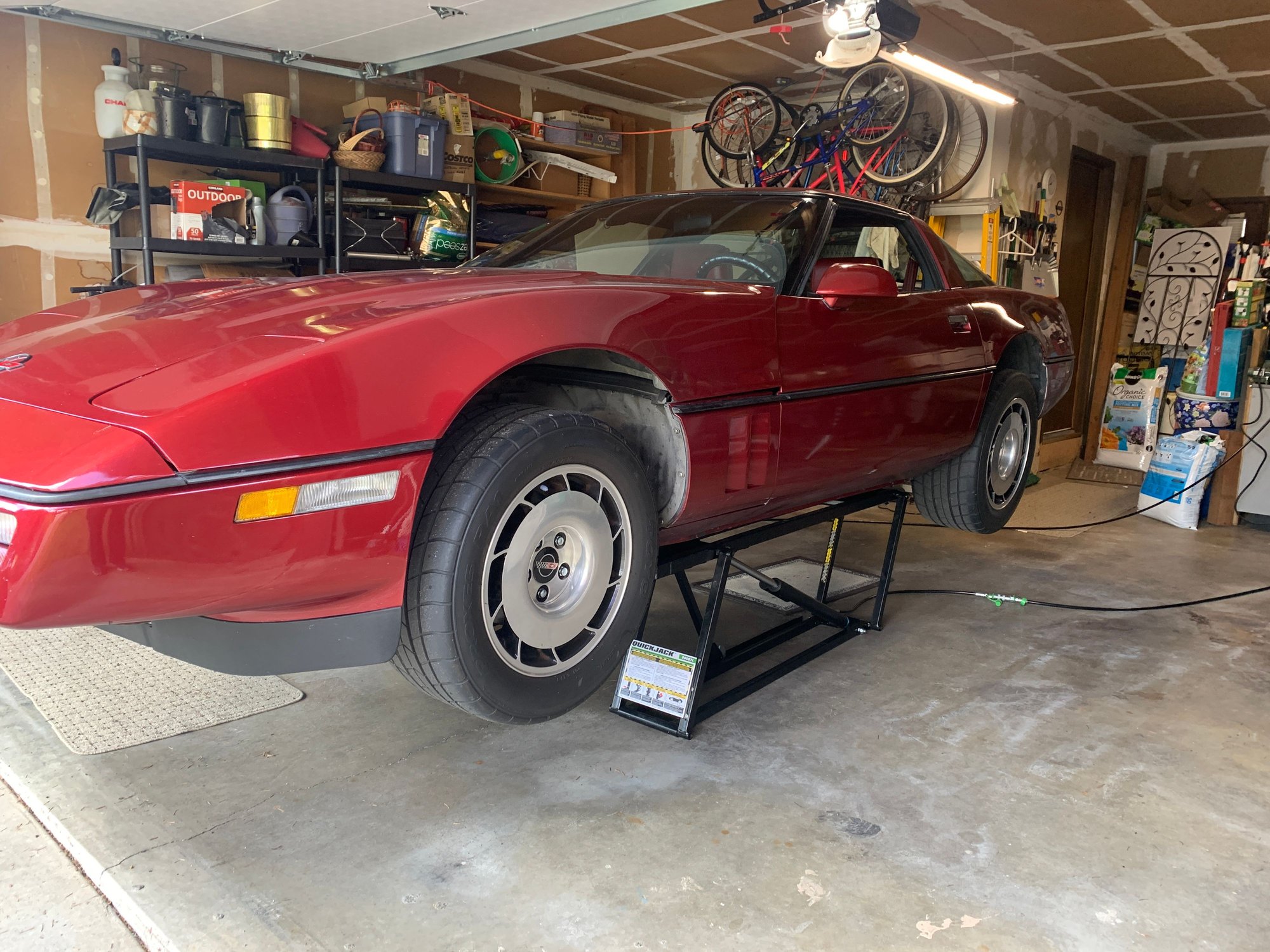

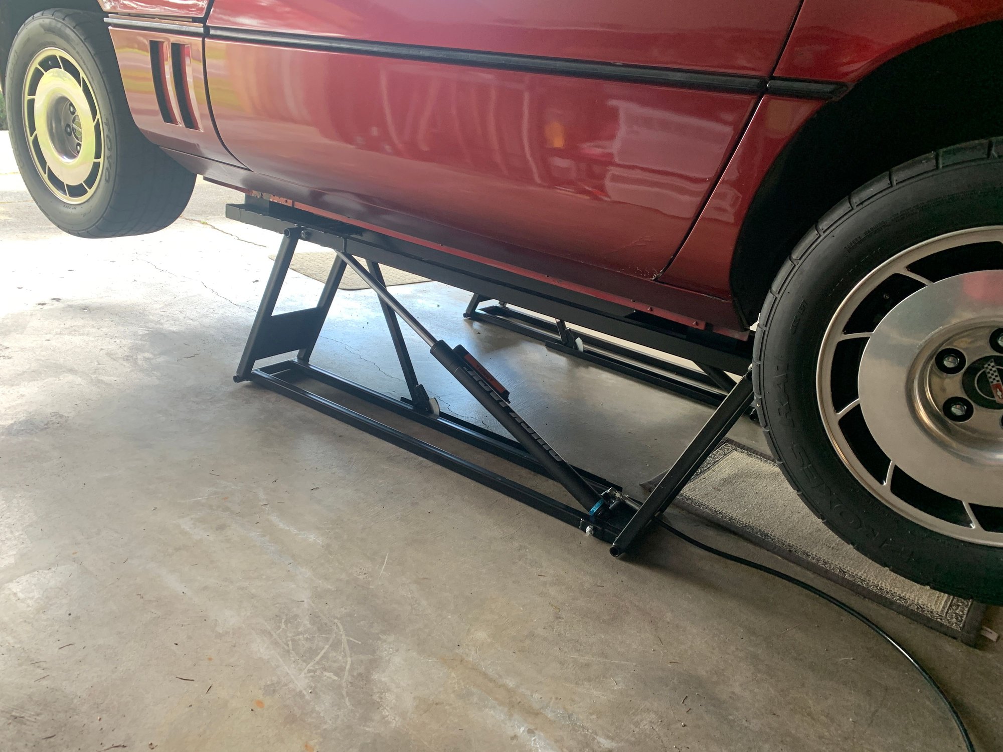

I use the standard blocks that came with the QuickJack, they work great.
From QuickJack's website ( https://quickjack.com/pinch-weld-blocks/ ): "Supporting cars on pinch-weld rails creates excessive pressure points which can gouge or tear the standard rubber blocks and damage delicate body rails on unibody vehicles."
I haven't found gouging or tearing of the standard blocks to be an issue after multiple lifts, nor, in my opinion, do the blocks have the potential to "damage delicate body rails."
The pic is clickable.
The rubber is very grippy. The blocks deform just a bit in use and do a perfect job of "cradling" the pinch welds, without deforming excessively.
I should note that I place the blocks where the frame turns inward just ahead of the rear tires, and just behind the front tires. In fact, the lifting trays on the 5000TL model are spaced too far apart to lift the car at the factory jacking points.

100% agree with all of this. Same experience here.

One more thing to add...I am not sure of the difference between C2 and C4 wheelbases, but watch the arc swing of the rear of the lift as it is rising. It can run into the rear wheel so just work with the spacing and carefully watch. I lay down on the ground and watch from the side as it raises. Also watch (since it swings forward while raising) that the car does not run into your garage wall or any obstructions, depending on which way you are lifting. It probably moves laterally around a foot at full lift height.
