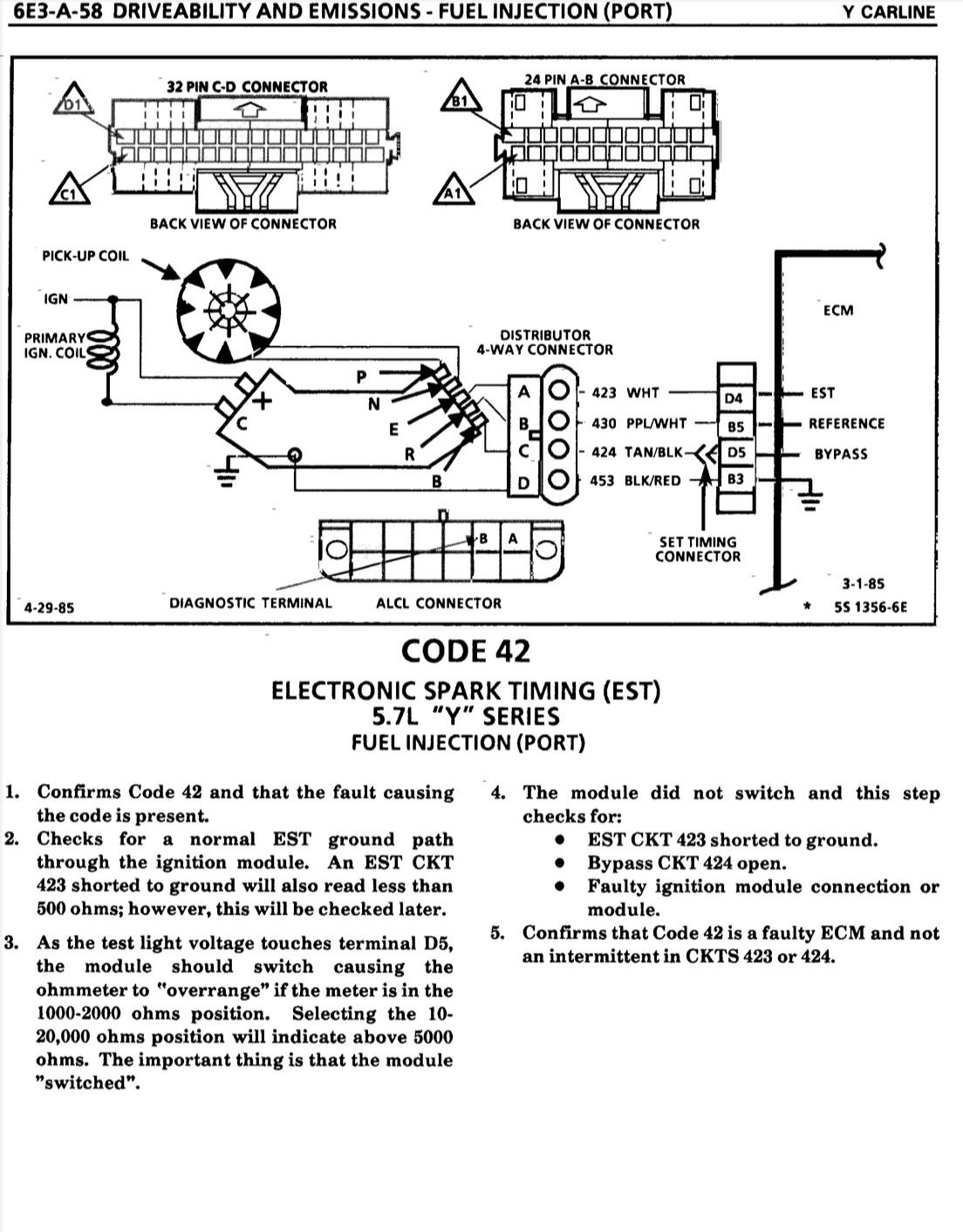

Code 42 can be set by the "Set Timing Connector" being disconnected. Did the shop happen to check the ignition timing for some reason such as emissions testing or something?
The Set Timing Connector is a single tan/blk wire connector in the vicinity of the wiper motor. Be sure it isn't disconnected. The connector is shown in the diagram above in the "Bypass" circuit adjacent to the ECM, although the actual connector is in the engine compartment.

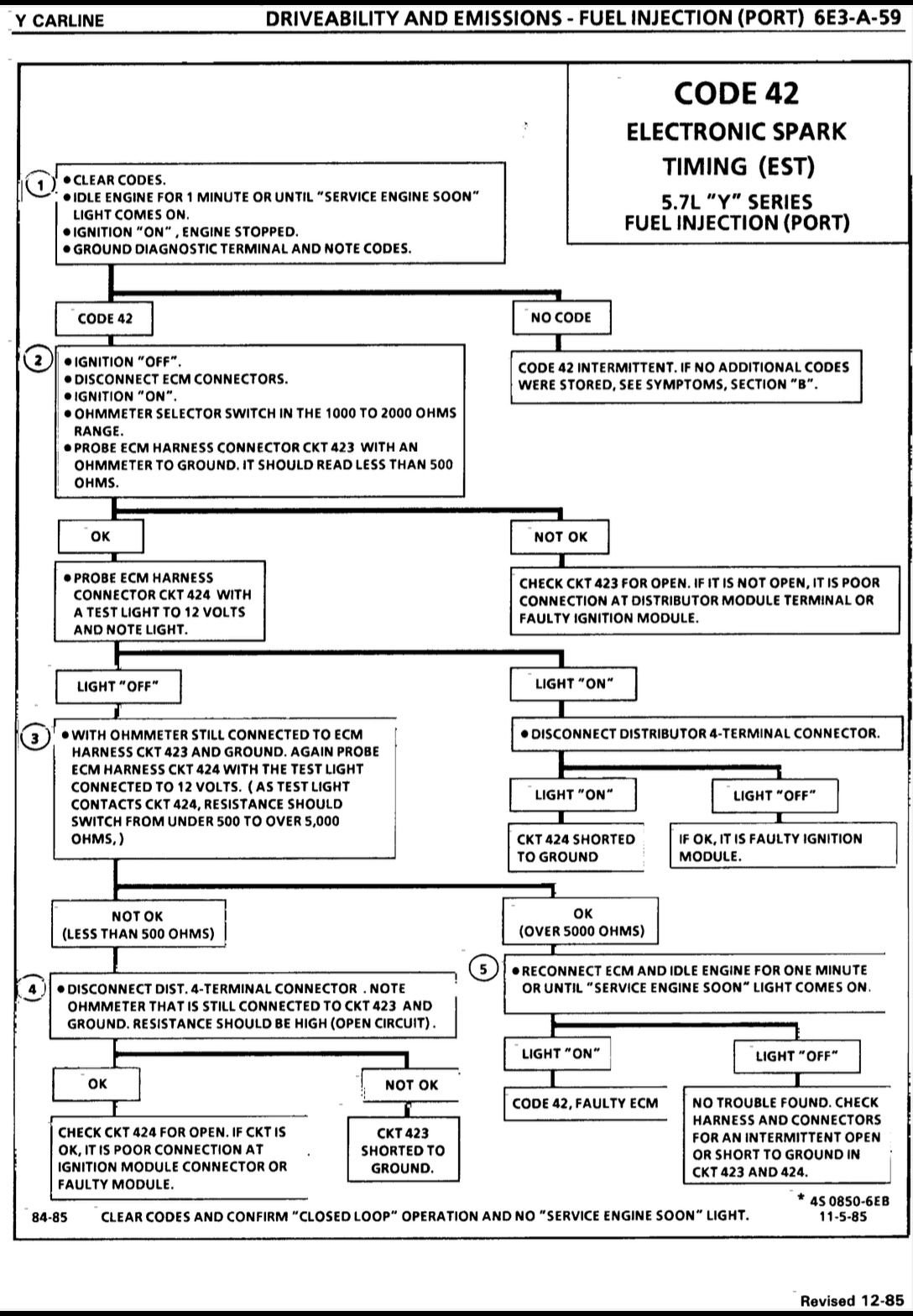

I don't think it is the ignition module. I changed it 2 years ago with a ACDelco one when I had previously got a code 42. When I did, it didn't make a difference. I really think this has everything to do with the shop changing the turn signal flasher which is above the ECM. I don't really understand the above schematic and the shop did not take responsibility for this situation, so I have to figure this out myself. What should I do first? Thanks.

All I can suggest is to follow the flow chart.
If you’re not savvy with a multi meter, find a friend that is.
