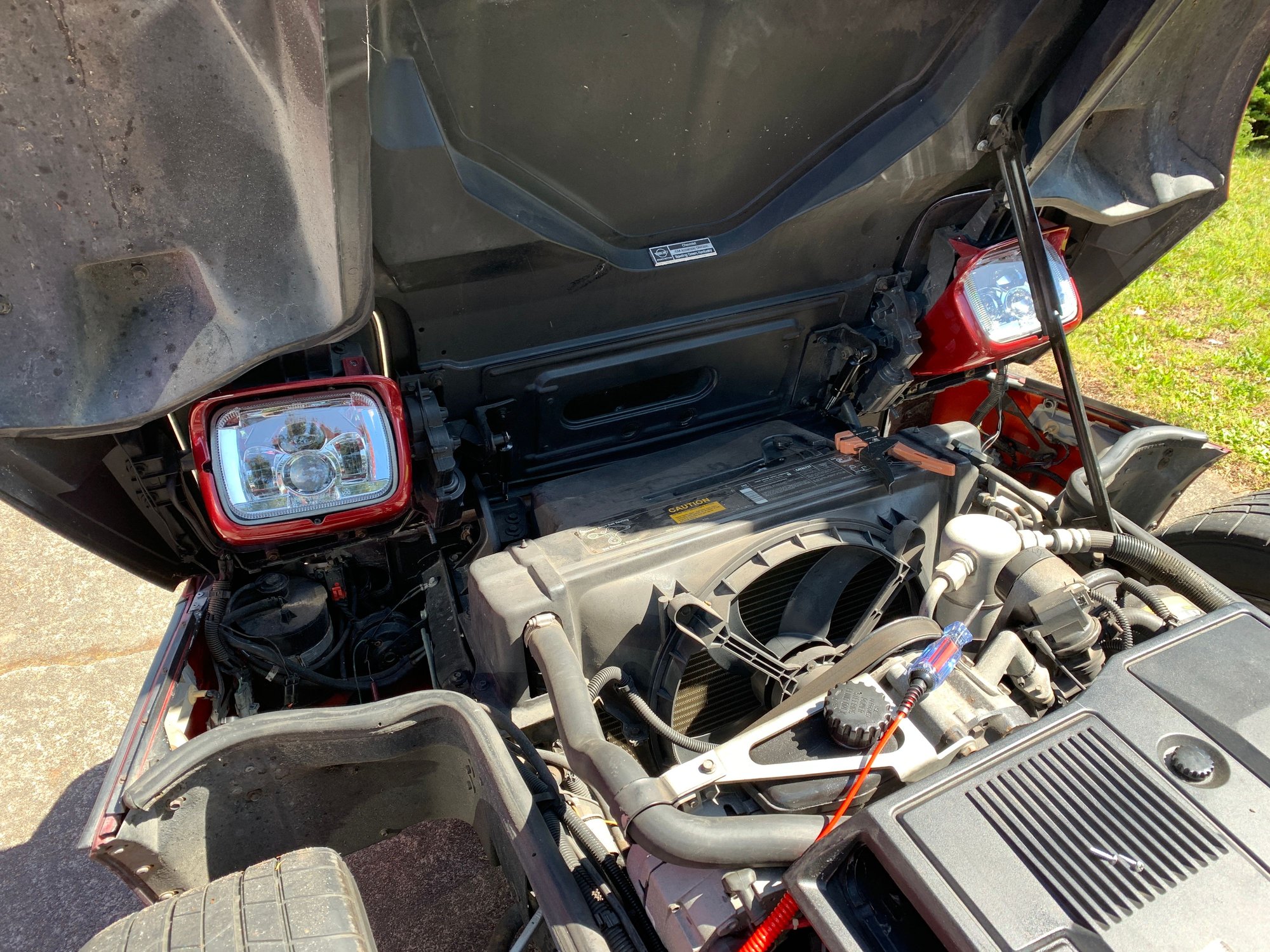

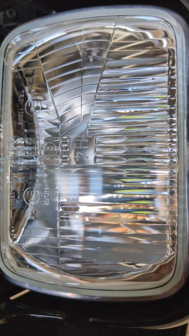

​​​​​​The LED light assemblys I had here is a pic of them, the body did not fit into the bucket needing a section cut out to fit them. They were slightly better in light output to standard, however nothing compared to the H4 hi lo LED globes in the normal headlights.
The LED hi lo globes in standard headlight housings reach further, because they are much brighter than the LED lights I tried.
And a few from my dash cam, be warned we drive on other side of the road here in OZ so don't be too startled
But its a good real world example of LED globes in standard semi sealed H4 lights on low beam, with other light sources and other cars headlights for comparison..

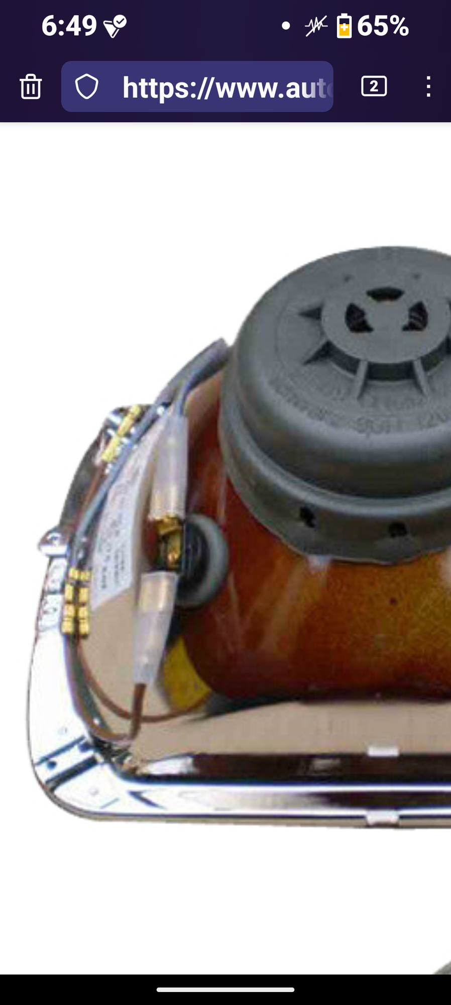

The Hella H4 light housings had a park globe (see pic above) which I used on my 91, connected that across the black and green drivers headlight wiring. That did the job of grounding the fog light through that small park lamp, which would otherwise not have been used.
