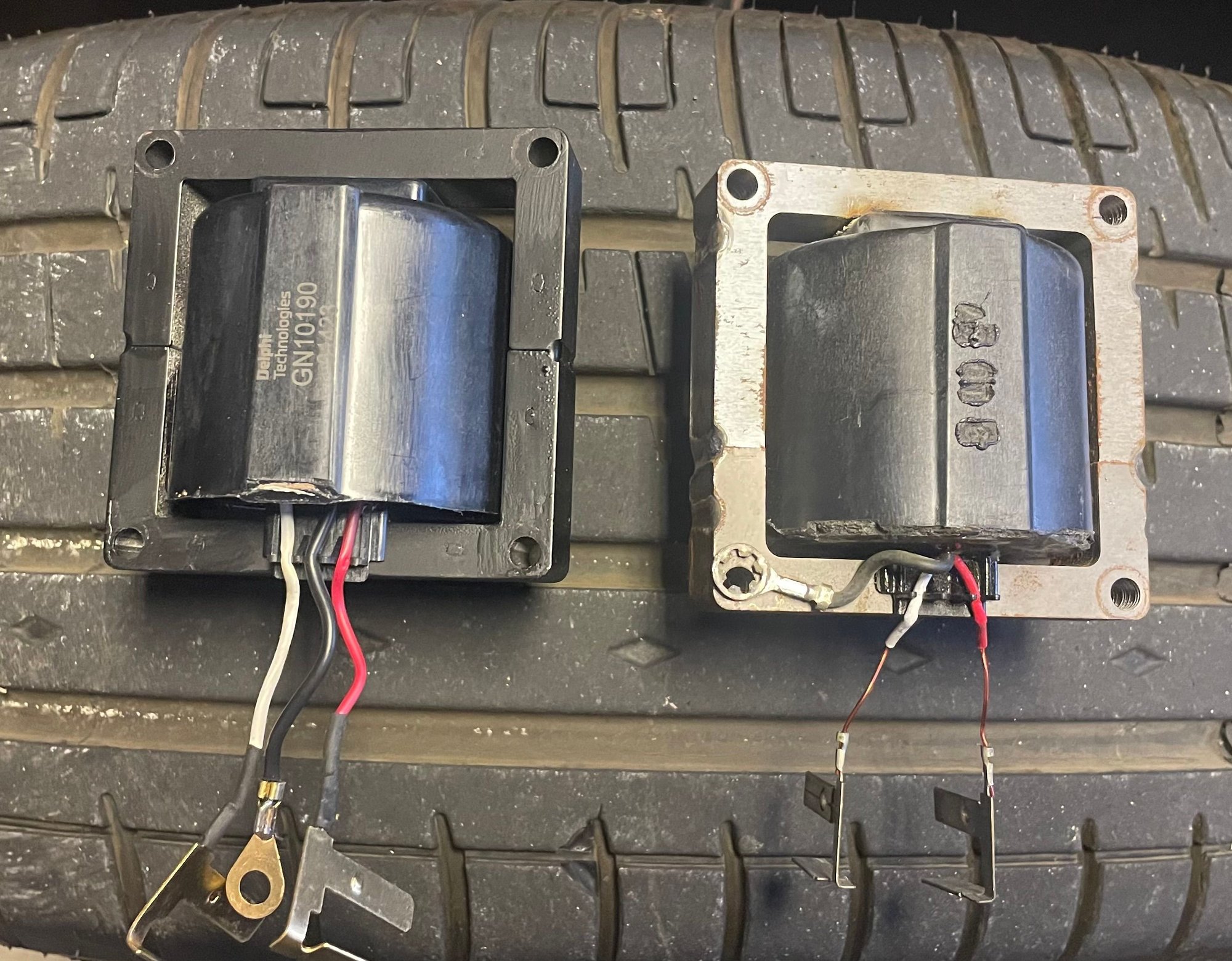

Hi All,
My current coil seemed a little crispy although was running alright so I decided I could probably change it. I ordered two Delco coils and they both produced the same problem. Once installed and the car turned on, the digital dash and AC controls began rapidly flashing along with the speedometer reading it was going 80 miles an hour while standing still. The coil was also making a rapid ticking noise - the first replacement I installed had a couple burn marks on the wiring where I assumed it was arcing. But the second replacement didn't have those marks but exhibited the same strange behavior. Once I replaced the original coil, all the flickering and sparking stopped. Below is a comparative picture of the two coils with the original on the right. I noticed the original that works ok has exposed areas of wiring that don't seem to be a problem and the red and white wires are actually crossed right where they exit the potting material. Has anyone encountered this issue and if so, any thoughts on what may be causing it? Two Delco Coils in a row from Rock Auto have done it!

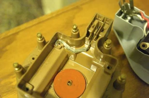

Last time I replaced my coil, which was actually recently, I had also replaced the cap and rotor at the same time.
I forgot to swap out the ground strap from the old cap and installed the new coil and cap and rotor without it.
The digital dash went haywire and did the exact same thing you describe here.
Thankfully I hadn't yet tossed the old cap so noticed the ground strap was still in there.
Swapped it over and that resolved that issue.
Did you replace your cap and rotor while you were in there and maybe forgot the same thing?
If not, I dunno what elese it would be.

If you didn't swap out the cap and rotor while you were swapping out the coil, maybe double check to make sure that strap is seated and screwed down properly and making full contact with the connector.
Example...
​​​​​​https://www.corvetteforum.com/forums...post1581680312

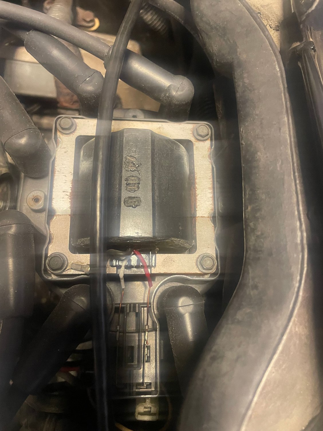

Natty, your feedback is quite helpful here but there is an interesting plot twist. I did not replace the cap or rotor, however upon closer inspection it appears that there is a ground strap that is of a different design than the replacement cap you pictured there. The exposed portions of the coil wires seem to make contact with it. The new coil did not have exposed portions of wire and therefore didn't make contact with the ground wire. See the picture below and see if you agree with this assessment.

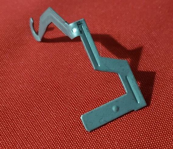

Yeah, your ground strap is missing.
Should look like this...
The ground strap is the one in the middle there. It installs under the coil like this...
Make sure it's pushed all the way down into its slot when you get one. That way your connection to the "C- and Bat -IGN Module'' is good.

So, yeah, that's why your digital dash is going haywire...
