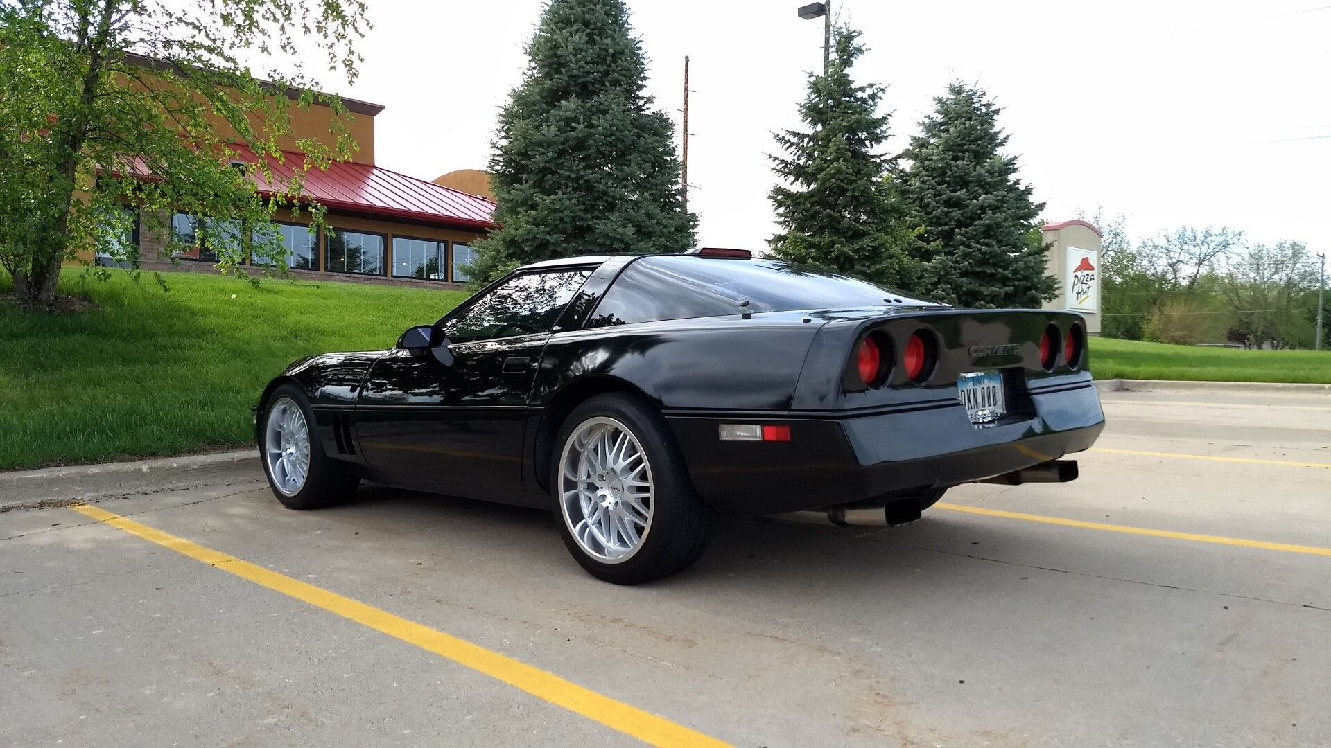

Additional consideration, move to 17" or 18" rims, plenty of tires options for those. Fun part is finding what rims will fit, see https://mirrockcorvette.com/c4-parts-guide/wheels/ for the stock specs over the years. Big item is the offset, earlier had higher offset than later years.
My '87, I switched to 18x9.5" rims with +40 offset, typical for a C6 Corvette (can't recall if front or back), seven years ago. Allowed me to upgrade the front brakes to C5 rotors and calipers as well. Tires are 255/40R18. I switched to Continental Extreme Contact DWS06+ tires last year, very happy.
