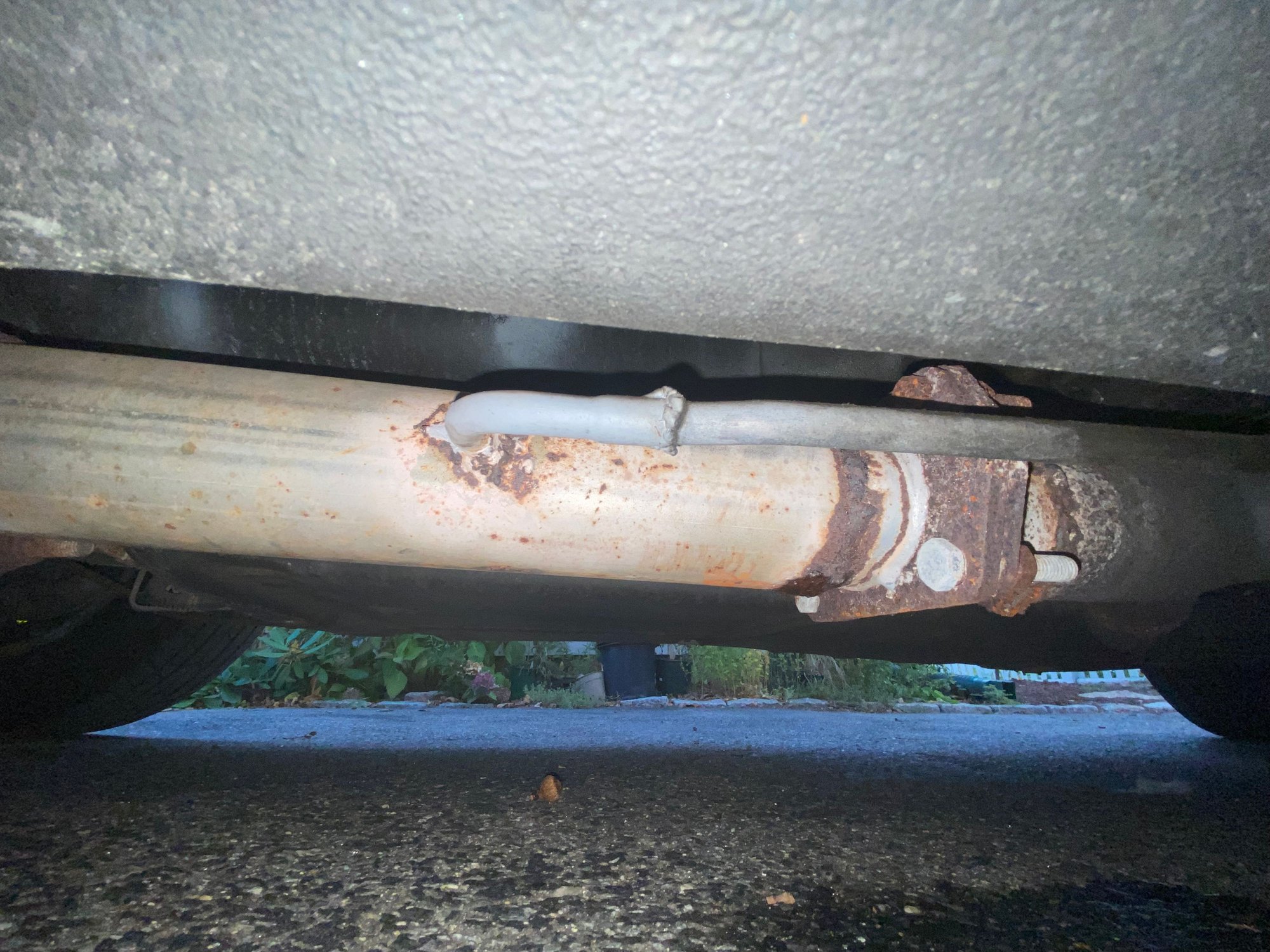

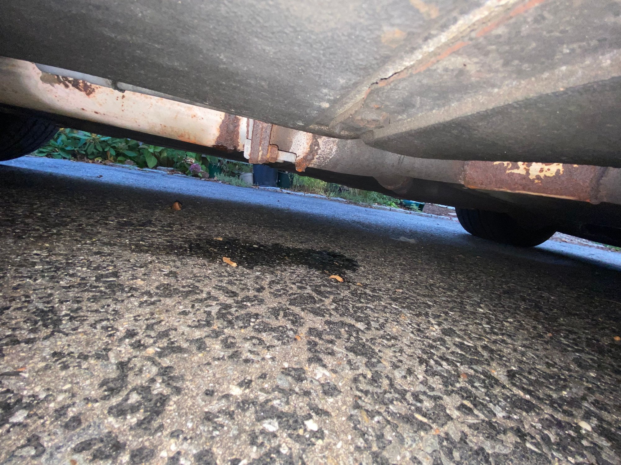

Hello. Just picked up a 1986 corvette looking to work on it, but am new to corvettes and am having a leaking issue. Would anyone know where this is coming from or how to fix. Again, I am a complete newbie with corvettes looking to learn anything I can. Thanks.

what is the fluid? what color is it?

The liquid was mainly clear but it had a hint of brown. I am not too sure what the liquid is.

It isnt really oily feeling and doesnt smell like anything. It just kinda feels like water

Condensate from the exhaust??

I am thinking the same thing. Is the car (engine) cold when this happens? If so, and it goes away after driving for a few minutes, it is normal.

After reviewing the pictures, it appears to be dripping water from the exhaust system. You likely have a weak seal at a weld. The exhaust appears to have been modified or repaired and the section thats leaking the water is likely at a low point or is the lowest point in the exhaust system. The water will pool in the mufflers at times and the LT1 and LT4 cars have drain holes in the mufflers specifically to drain the accumulated condensation in the exhaust system. When you accurate at full throttle, it will blow the water out. Doesn't hurt to blow it out on the on ramp now and again. At any rate, this is normal and if the exhaust were original and unmodified, you would not see too much of the water on the ground.

Its water.... a by-product of the internal combustion process is water. It might be brownish from the rust in your exhaust
Burning one gallon of gasoline produces approximately 1 to 1.05 gallons of water in the form of water vapor, with the exact amount depending on the fuel's composition and the efficiency of the combustion process. This water vapor is a natural byproduct of the chemical reaction, where the hydrogen in the fuel combines with oxygen from the air.

Great post, I didn't know it was one gallon of water produced but certainly remember my chemistry. C8H18 + O2 => H2O + CO2 (not balanced I know) I suppose due to the location of the leak, there is probably some leak in the exhaust system due to what looks like rust?

I would replace that exhaust pipe if it were me.
It's starting to rot away, particularly there at the connection where the condensation is leaking.

Thanks so much everyone for the tips! Im thinking of replacing the exhaust anyway because it does appear to be rotting so its probably the best. Thanks again!
