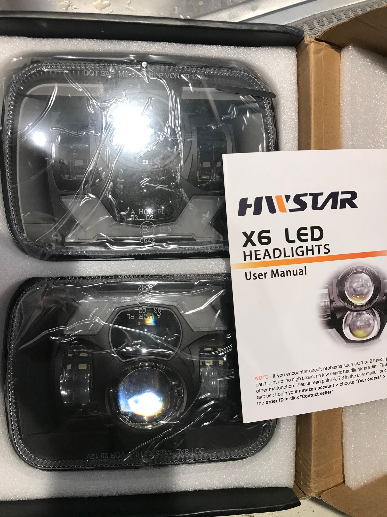

These HWStar projector LEDs are just as bright and clear as OEM LED/HID headlights. One of the best upgrades I've made to my car.

It's basically plug and play. The only additional parts I used were D-Lumina LED CANBUS decoders, which eliminate the high beam/foglight issue some have after installing LED headlights. The decoders plug in directly between the headlight and the car's wiring harness. Here's the Amazon link for the decoders:

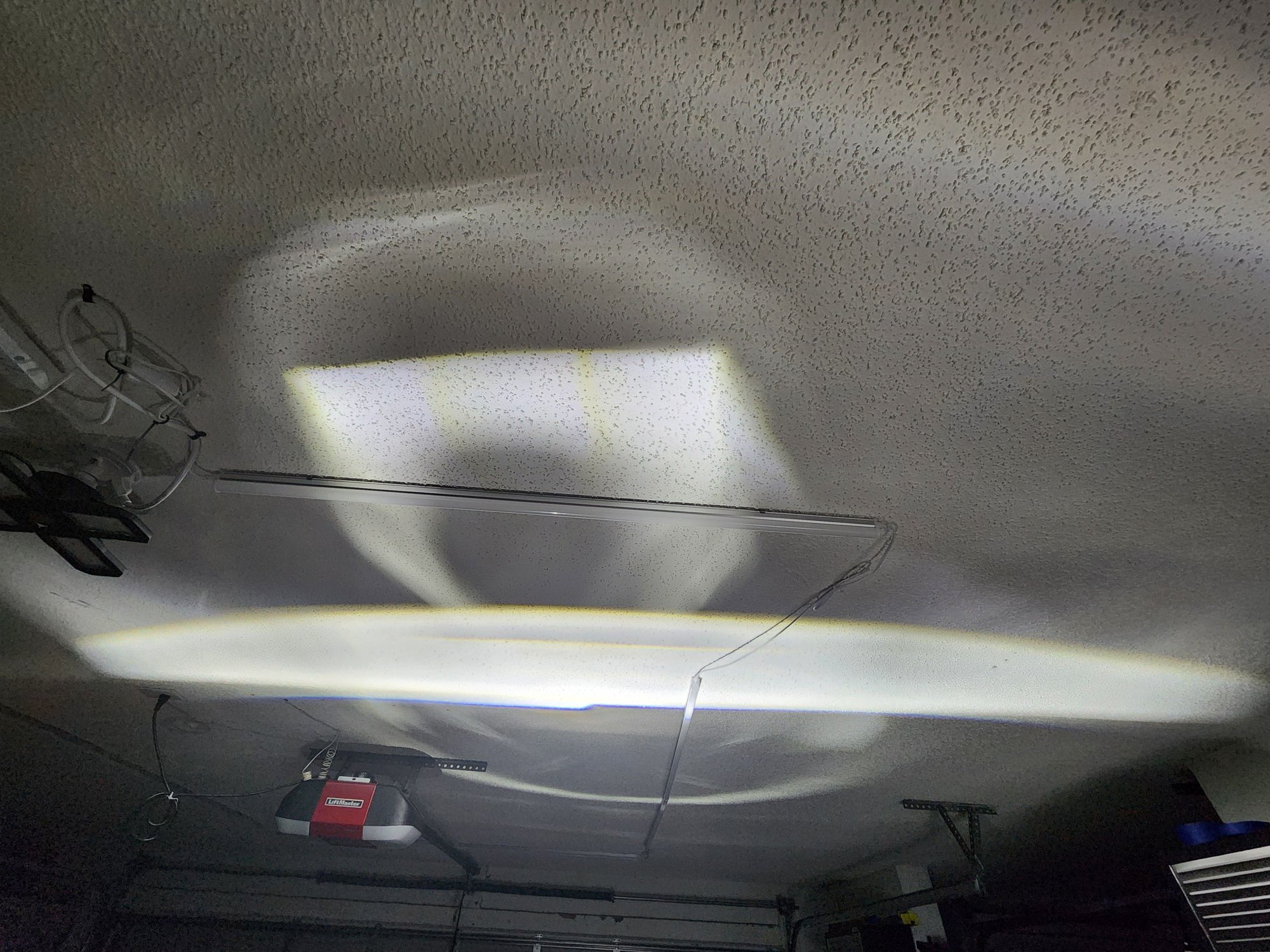

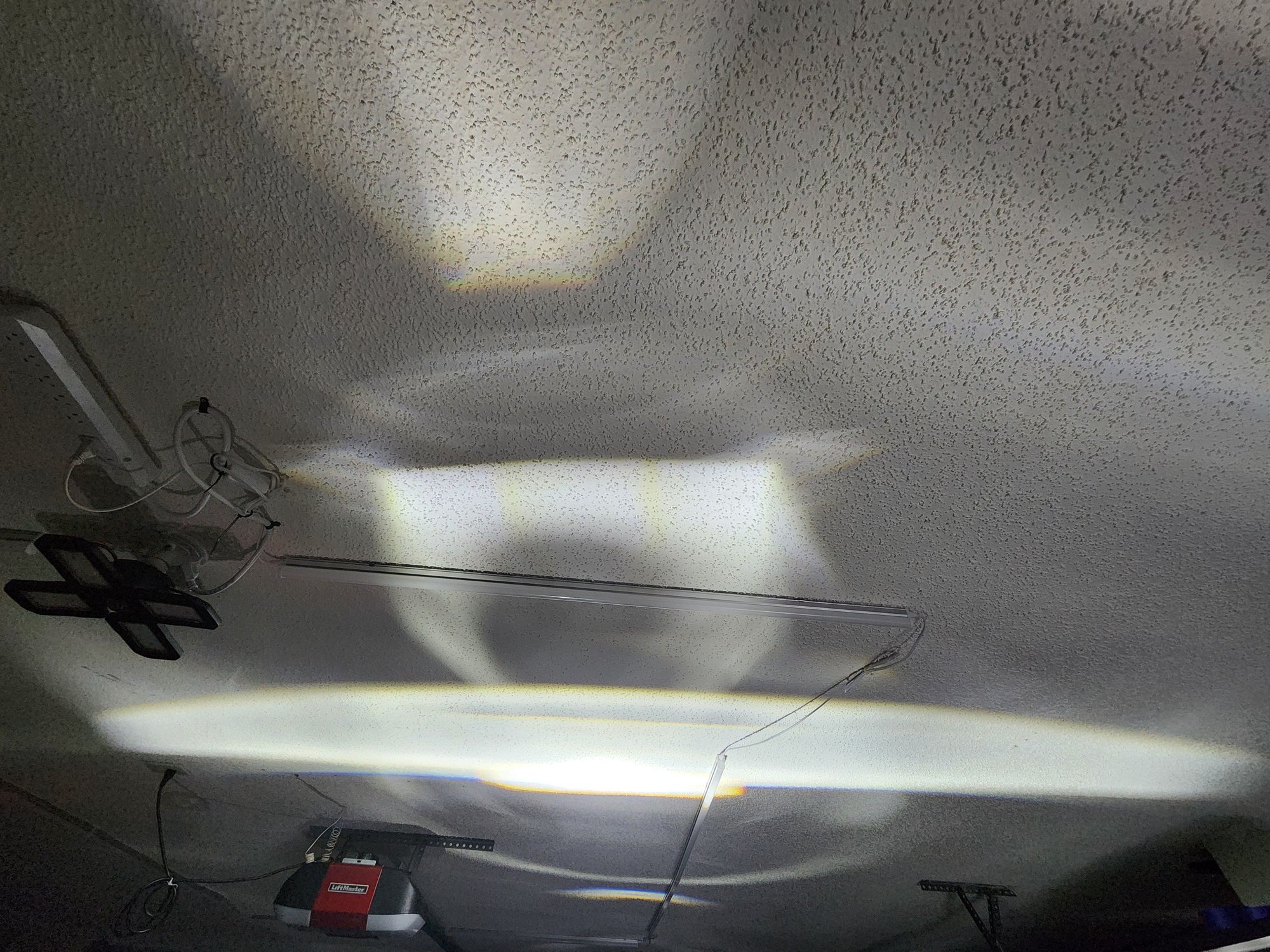

I got the HWSTAR Volcanic series (the ones that are about $80) today. I'm not super impressed with them to be honest. Compared to the Auxbeam light I was also not impressed with, they're noticeably less bright (still pretty bright though), and don't have as nice of a light spread. They have noticeably less beam width, but the high beam is wider. It's still fairly narrow though, but it's better.
It also has some very strange stuff going on optically at the bottom, there's two distinct odd light patterns pointed fairly low that appear to just be screw ups in the design, and wasted light.
Points for the high beam being a bit wider than the auxbeams, but it's inferior to those in every other way. I don't think it's gonna be my pick for my car. I think I'd be inclined to try the auxbeams over them.
Pictures are on the roof of my garage, and they're upside down. This one is the HB picture, you can see the HB is box shaped which is nice, but still not super duper wide.
This is the low beam. All kinds of weird optical aberrations going on with what would be the bottom of the beam.
