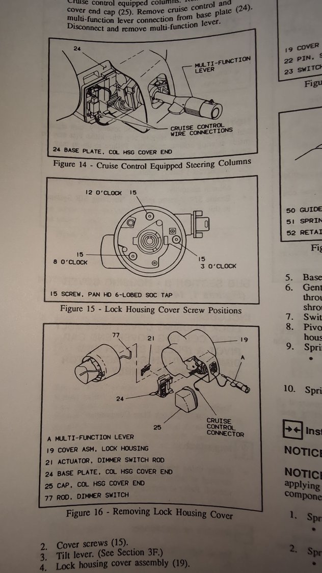

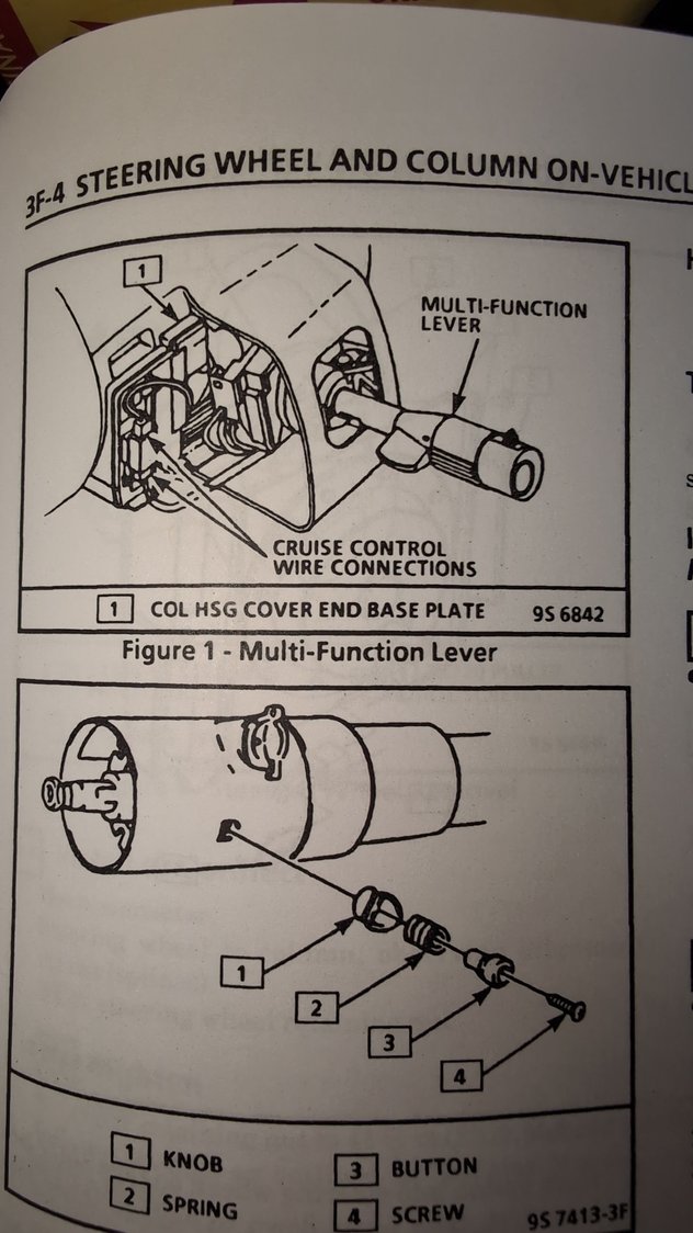

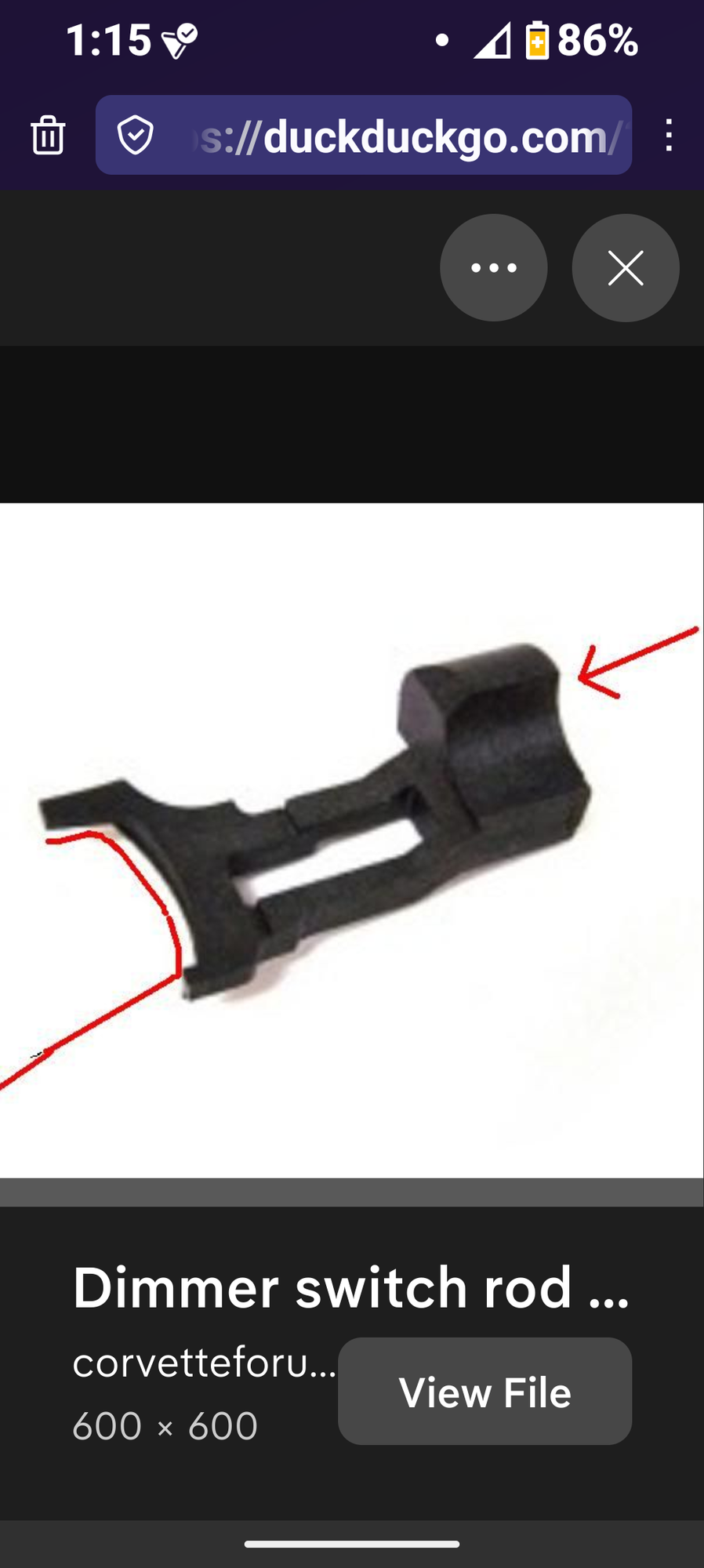

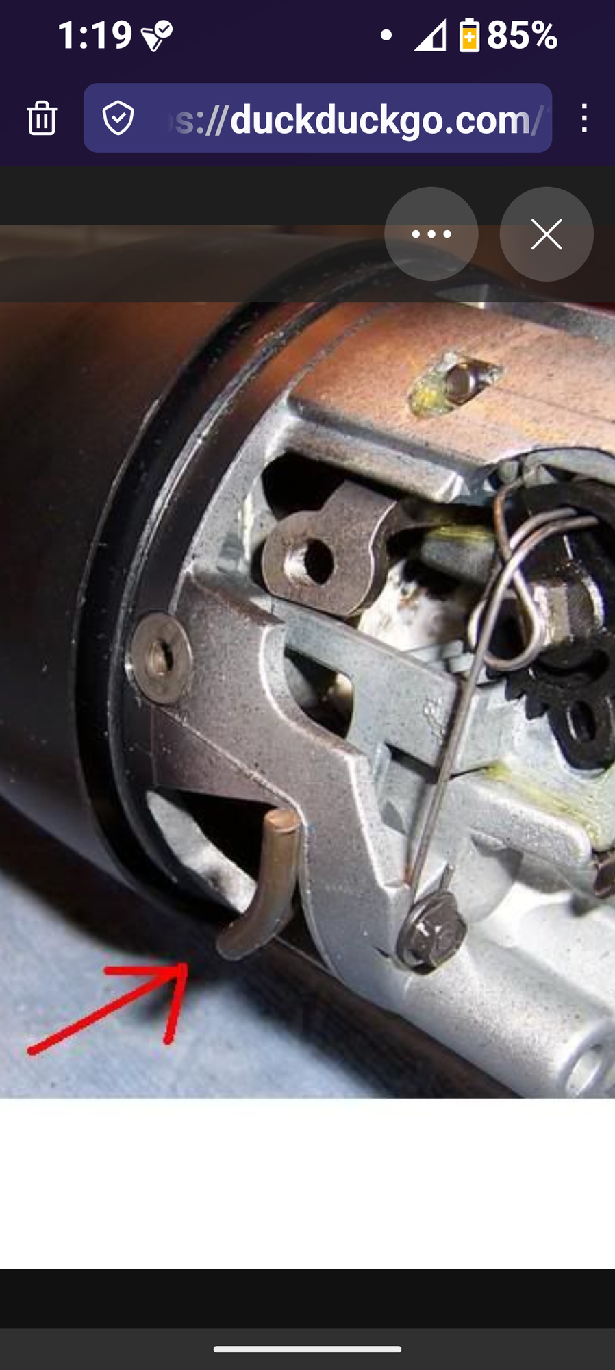

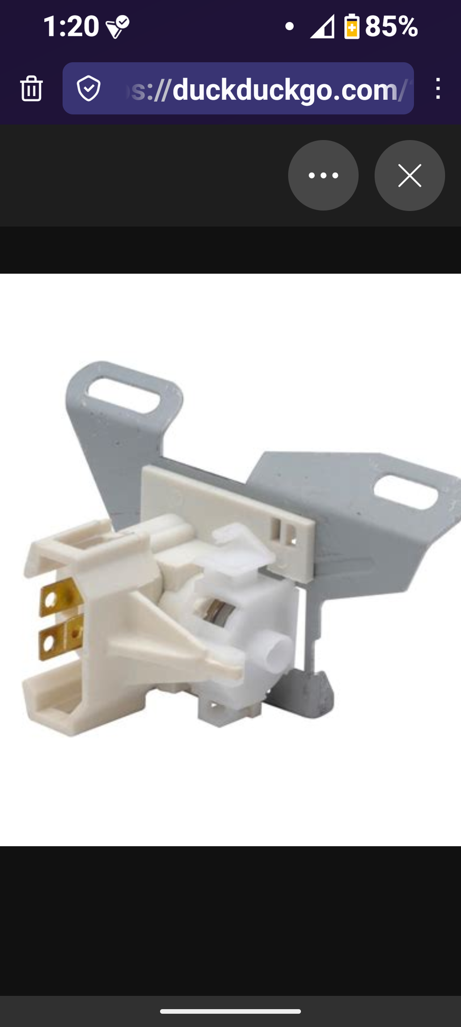

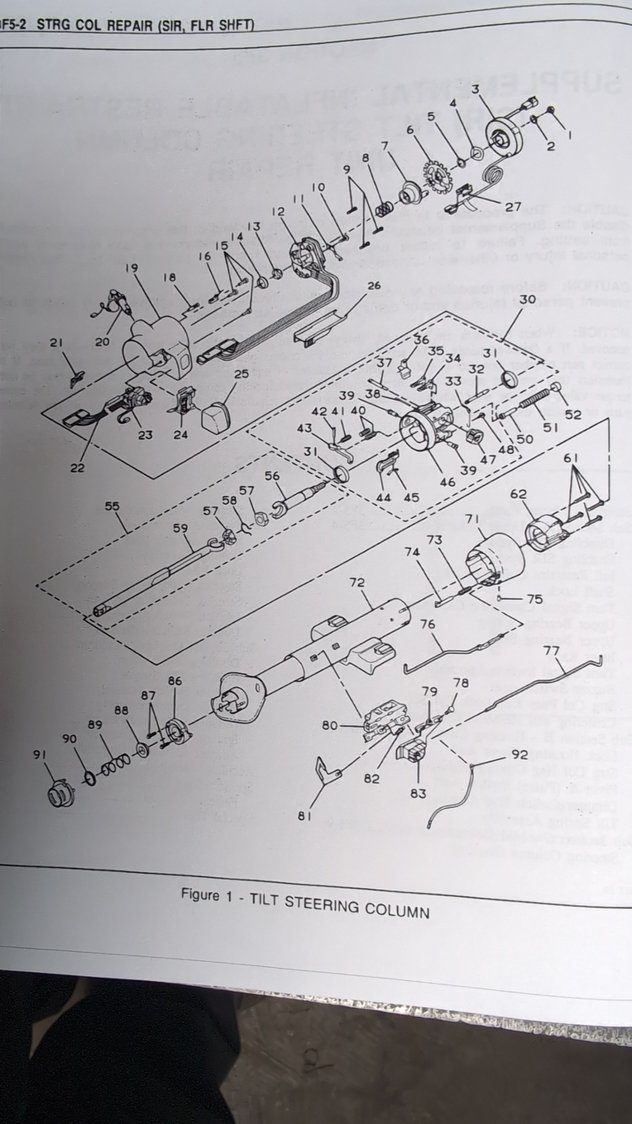

Hi your high beam switch is under the dash at steering column near the ignition switch where all the wiring connects, there is a "rod" that fits in the high low beam switch under dash which goes up alongside and into the column where the high low beam wiper combo assembly is.
When removing the access cover you can access the rod and high low beam plastic slider that pushes on that rod, to operate that high low beam switch on column under dash. See the images below from my manual and some screenshots that show that rod and black plastic thing that slides from high low indicator stalk operation. Its a pain in the *** to fit together there is a slot in the cover below access panel that holds it all together, that rod can easily dislocate from switch under dash so keep an eye on that when assembling it.
See screenshot of rod the black plastic slider needs to press against, its a fiddly job to align and assemble it correctly. You need to lower the column to remove the access cover in front of turn signal / wiper assembly, then remove the black plastic cover to access the black plastic slide assembly that connects the indicator / high beam stalk to that rod that goes to high beam switch under dash on column near the main switch connector. That main switch also has a rod that actuates it from ignition switch, it can be adjusted up and down to operate starter etc ... Good luck 🙂👍

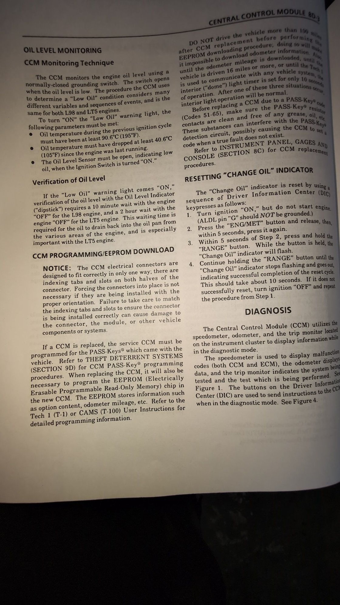

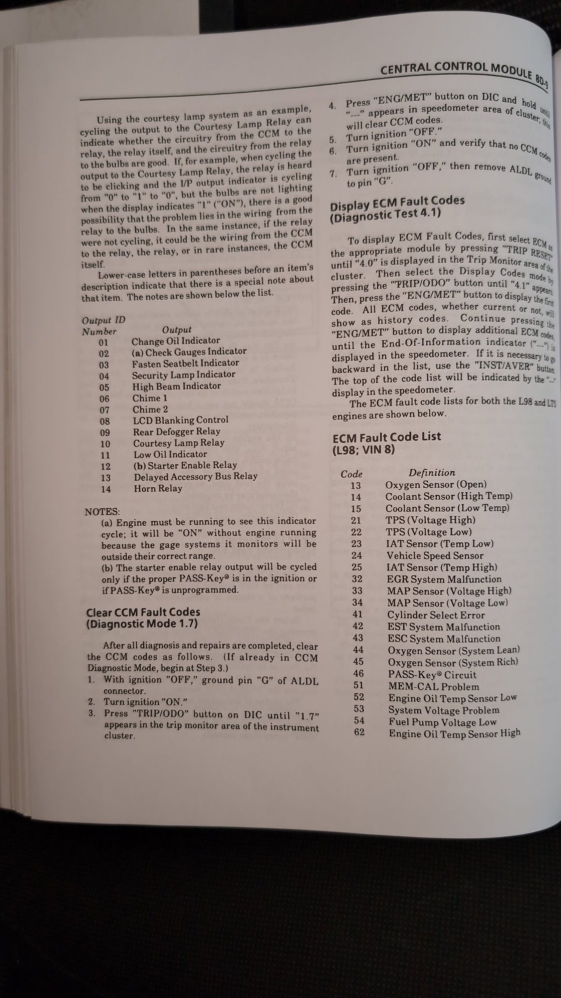

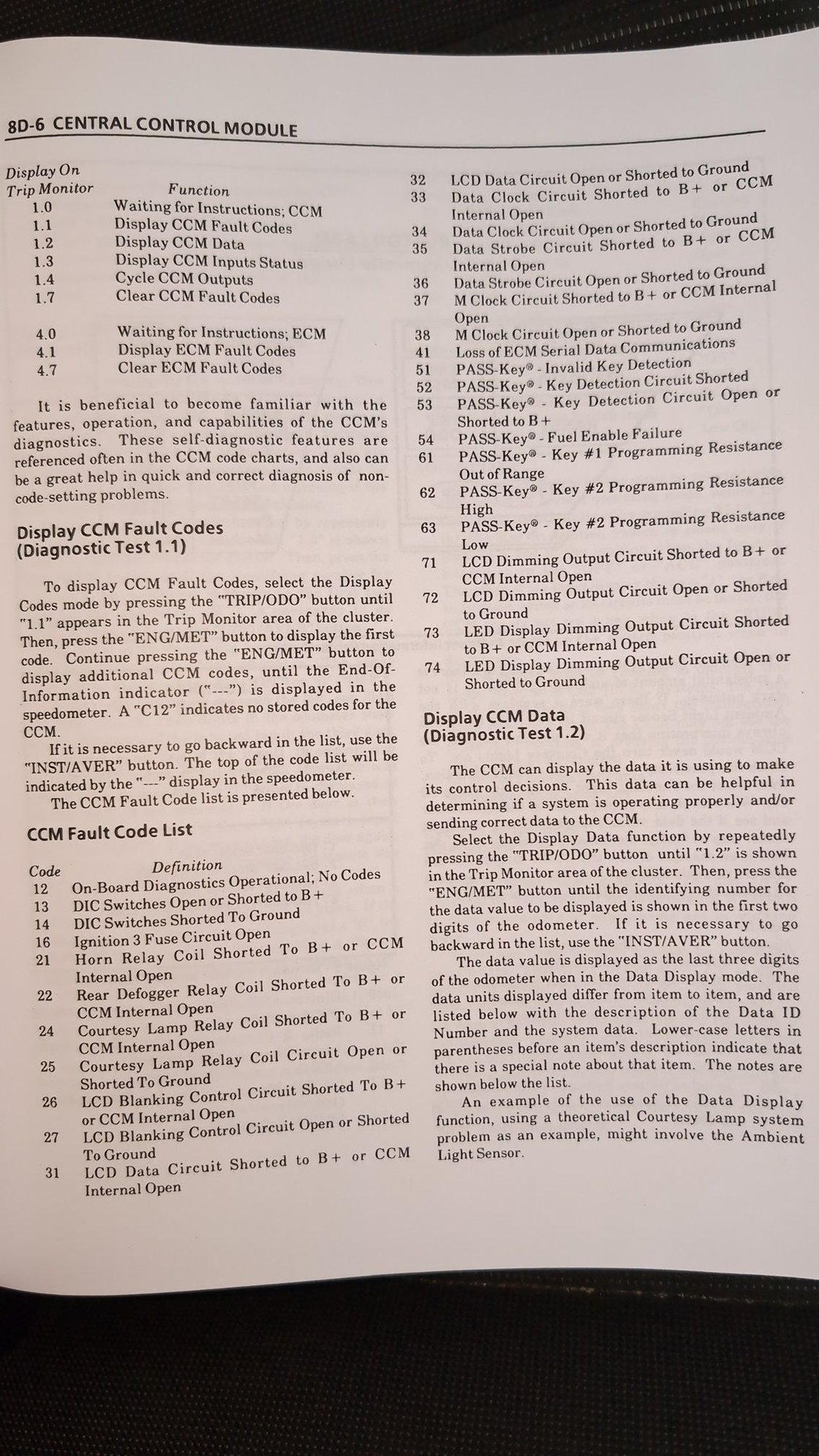

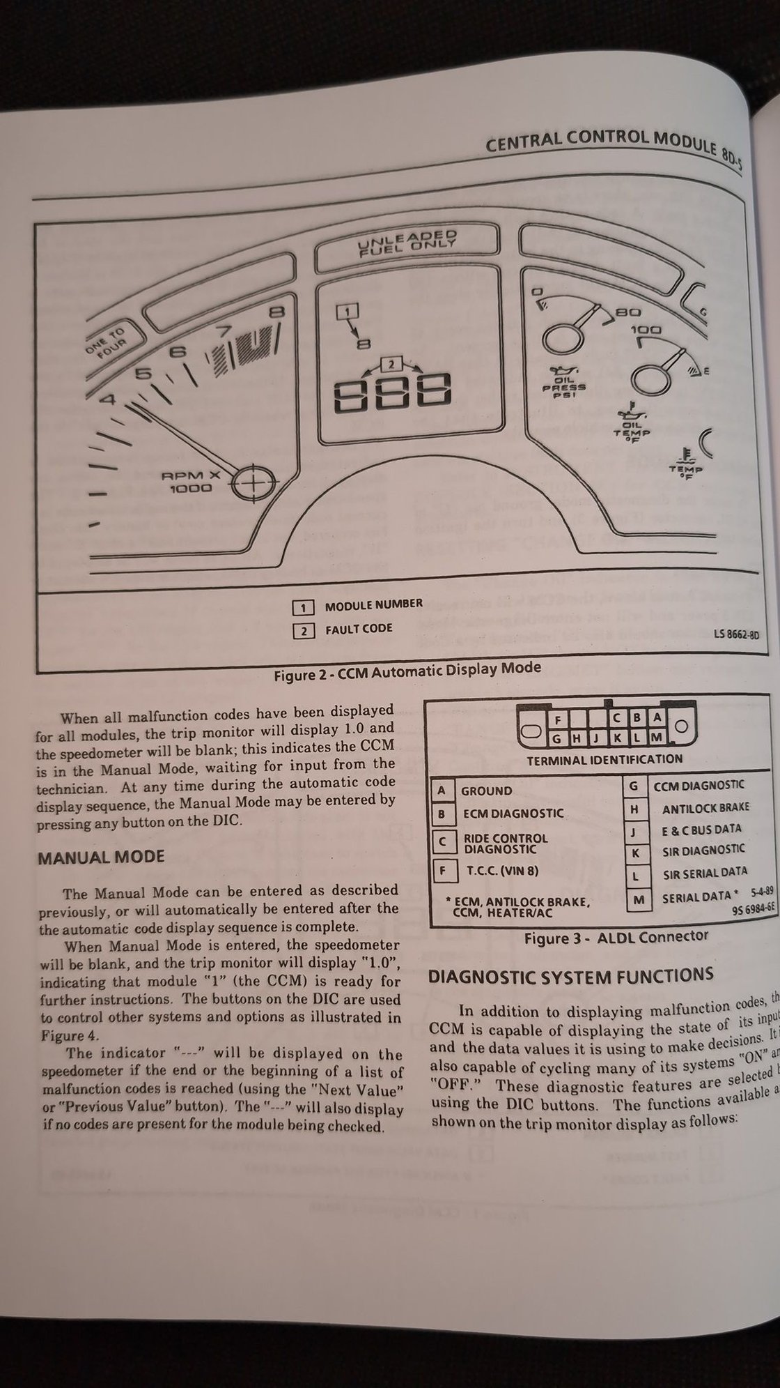

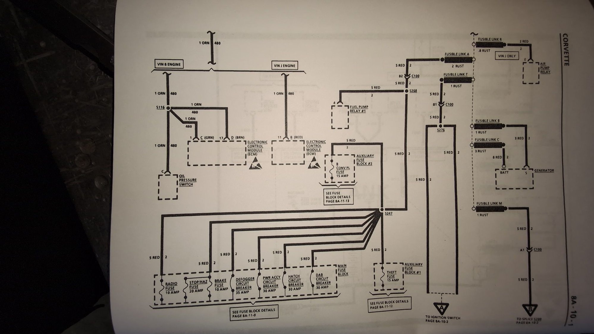

Hi sorry for the late reply, have attached some wiring diagrams for you, page 1 has battery and fusible links diagram also the continued page 2 has more fusible links diagram and then page 3 has the ignition switch on steering column under dash wiring diagram.
Hope it helps you locate where the power supply to ignition switch has been lost,

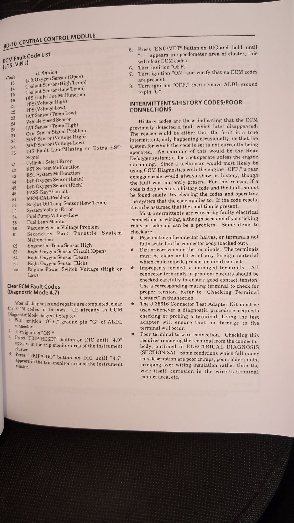

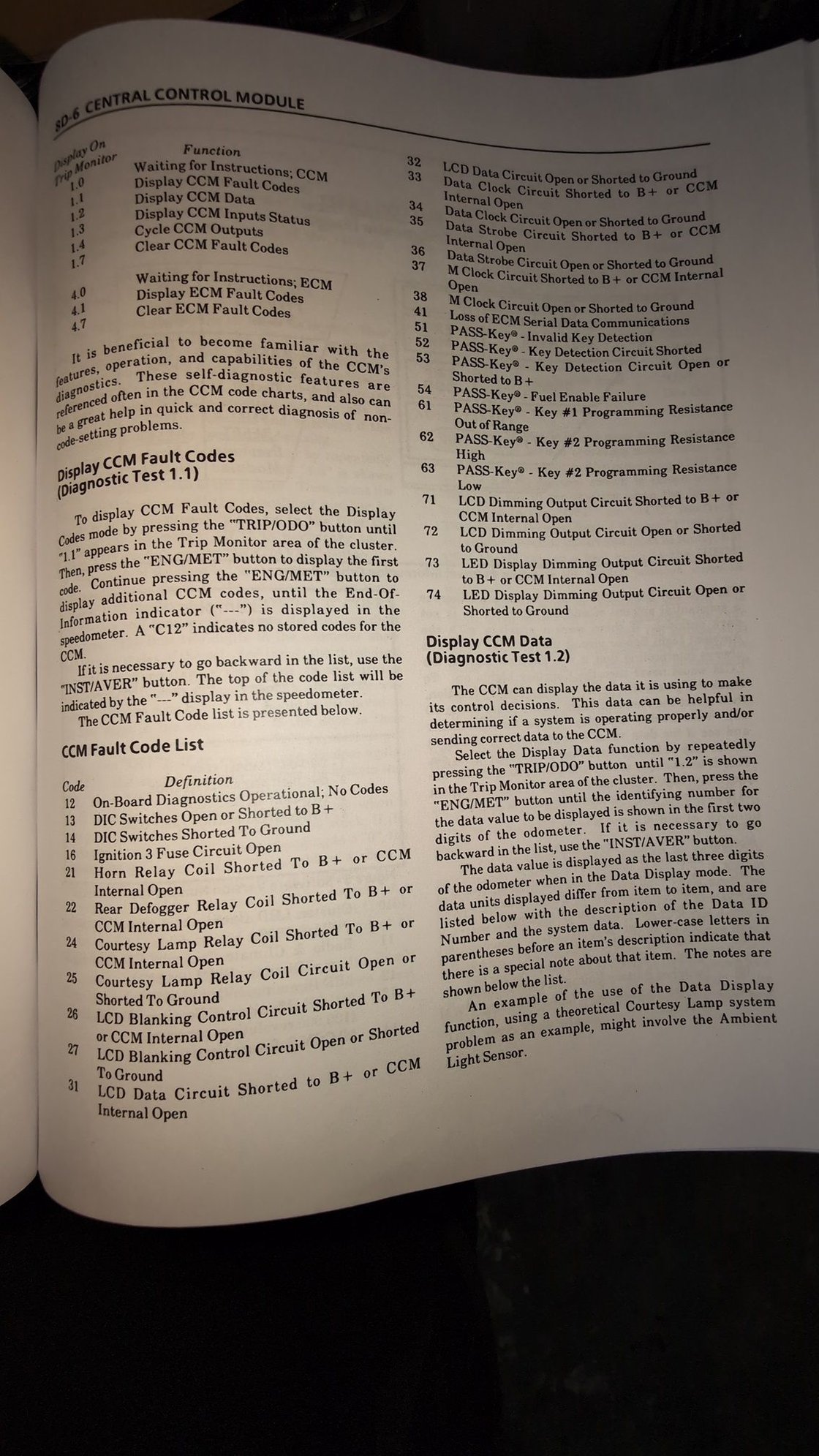

Also attached is info how to check the CCM module for codes when you have power to dash from ignition switch, should your Vats be stopping you starting the car.
