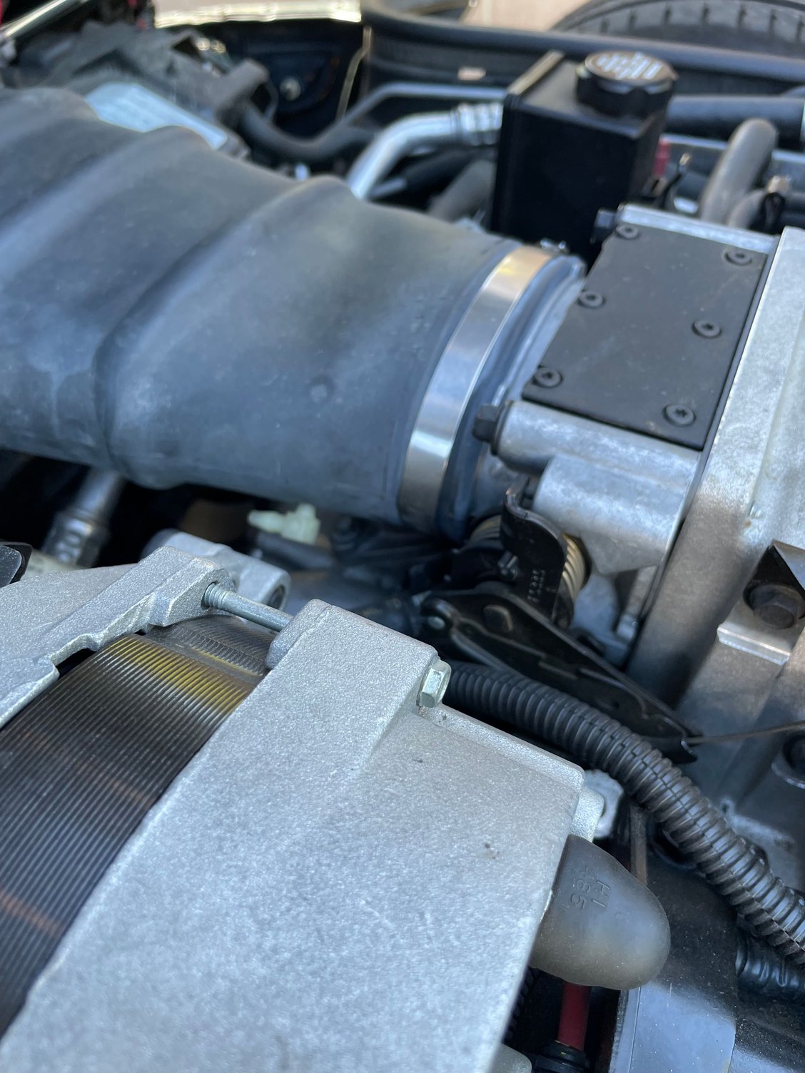

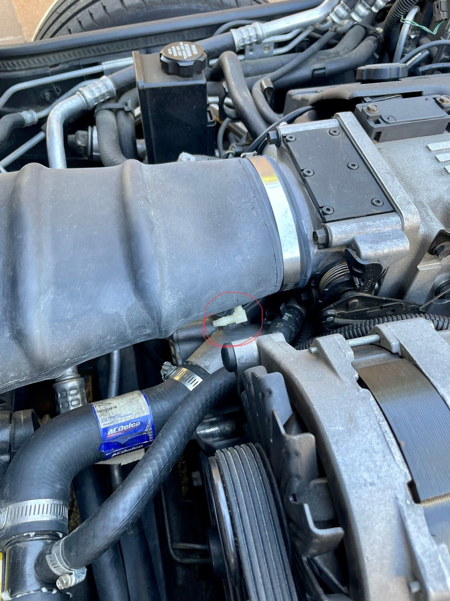

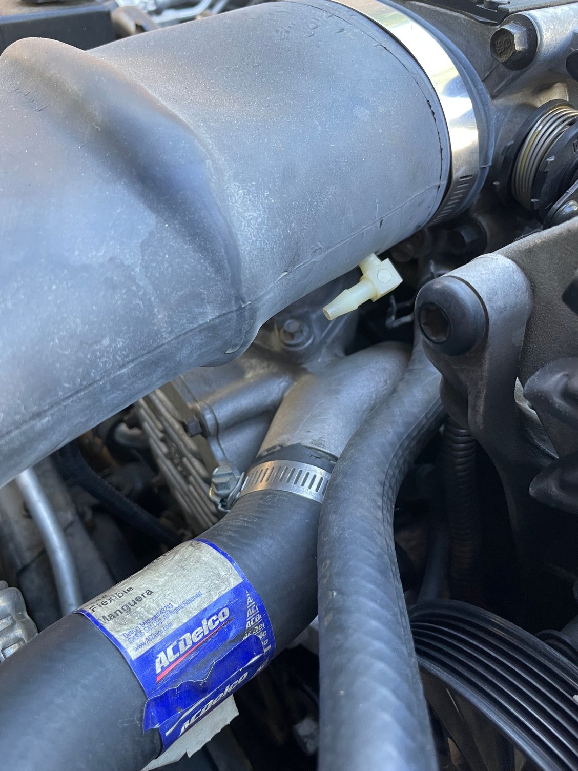

What is this port for? don’t see any hose, and I can’t find any references to it.93 Ca car , part of smog? Thanks

They could have modified the opti for ventilation. This would be the "feed" line. Look for a hose from the opti. Dan

My belt ribs ride in the groves in the pullys, yours looks like its inside out?

‘92-‘93 early has double side ribbed belt.

I could know for sure if you remove the plastic cover on the drivers side and take a picture of the PCV valve area. We can see if the hose has been added for the "suck" side of the opti ventilation. Dan
