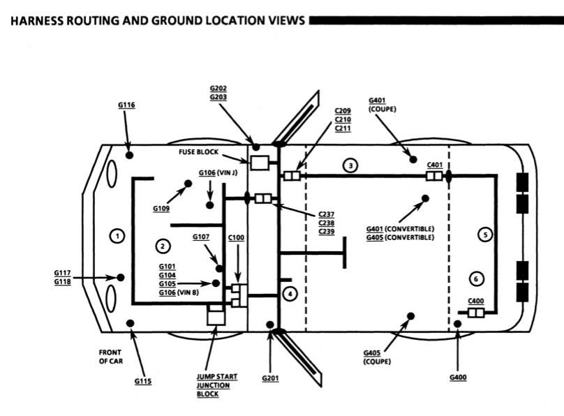

You may have to put a new battery in it regardless, even if it was charged.
The good news is that it lit up initially, though.
If there was something wrong with the wiring then it likely wouldn't have initially lit up at all.
A weak battery in these cars causes a lot of weird stuff to happen.
You could always have the battery tested under load at one of the brick and mortar parts stores, but I've done that before (at Auto Zone) and they told me the battery was good when in fact it was actually bad and a new battery solved the problem I was having.
Same thing happened with an alternator. They told me it tested good, but it was actually bad as well.
That left me wondering if some of the people who work in those Auto Zone stores even know how to use the testing equipment.
Maybe give the cables a look to check for corrosion if you haven't already.
Sometimes the cables corrode and disintegrate inside the shielding and you can't see it. Same with the alternator BAT wire.
Also check for loose cable grounds...
That diagram is from my 1990 service manual. Vin J is for the ZR-1. Vin 8 is for your car.
Also maybe check this thread to make it easier to locate some of the more germane grounds if you haven't ever messed around with em to know exactly where they are...
https://www.corvetteforum.com/forums...questions.html

Natty C has given you good advice. Id start with a new battery and throughly check all the grounds and battery cables.

Like was said before, most likely your battery is kaput from sitting for a year. You can test it yourself before removing it and getting it load tested. Charge it up again, with a regular charger, not a trickle charger or "maintainer". A fully charged battery should read at least 12.6V. Try to start the car and see what the battery reads. If it drops down to 9-10V or less when starting it is no good and needs replacement. That is your load test. And measure it again when you are done trying to start it. If it dropped significantly from just doing that, it is no good.
And FYI, when you load test a battery with a tester it must be fully charged first. After putting your battery on a charger, it's possible for it to read 12.6 V or so but have limited or no capacity - that's what the load test measures. In all likelihood, getting a new battery will get your car started but charge it up first again and go from there.
And also make sure your battery terminal connections are clean and tight.

@OP Batteries have an internal resistance whereby they can discharge themselves over time when not in use. Sometimes they are too far gone and may appear to have the correct voltage but cannot produce sufficient current to start the car.
As Natty suggested, also look for loose connections and corrosion. You can measure the resistance between the ends of your battery cables with your multimeter and it should be low - also continuity to ground with your grounds.
