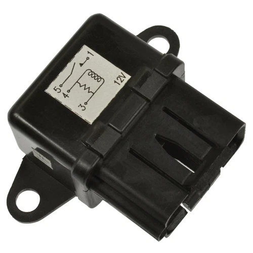

not sure if this might be giving you grief, but there is a starter relay (i believe they call it VATS, for the Vehicle Anti Theft) behind the center console. Hopefully this link will show you. IMHO it is completely useless and is easily bypassed with a jumper wire. I would eliminate this as a possibility now and for future. It was causing me grief, mine wouldn't start hot but it could also be your culprit.

The VATS is not a starter relay but is involved when starting. However, if it is not working, you won't even get the click that the OP is experiencing.

it looks and behaves like a relay and they call it a relay. I ordered a replacement that is still in the box since the bypass made more sense. I don't think you have anything to lose trying the bypass. this is a pic of what I bought. Standard Ignition Starter Relay for Camaro, Firebird, Corvette RY-544 - Picture 1 of 10
