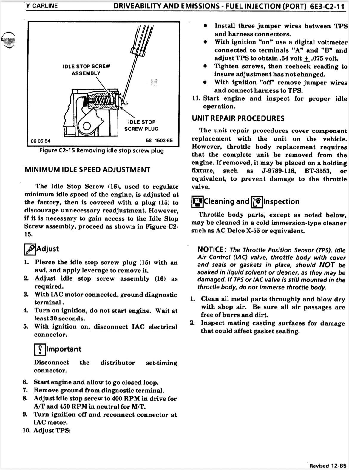

Did you set the TPS voltage ?

Go to youtube and search C4 Corvette adjust TPS voltage. There are a bunch of videos.
I use brad nails and slide them along the wire and into weatherpak connector to the point they make contact with the terminals within.
Top 2 wires of TPS, your twisting TPS until you reach .54 volts.
After you set it, you may want to do a minimum idle adjustment. If you had to move idle screw during minimum idle adjustment, you will have to reset TPS voltage.
