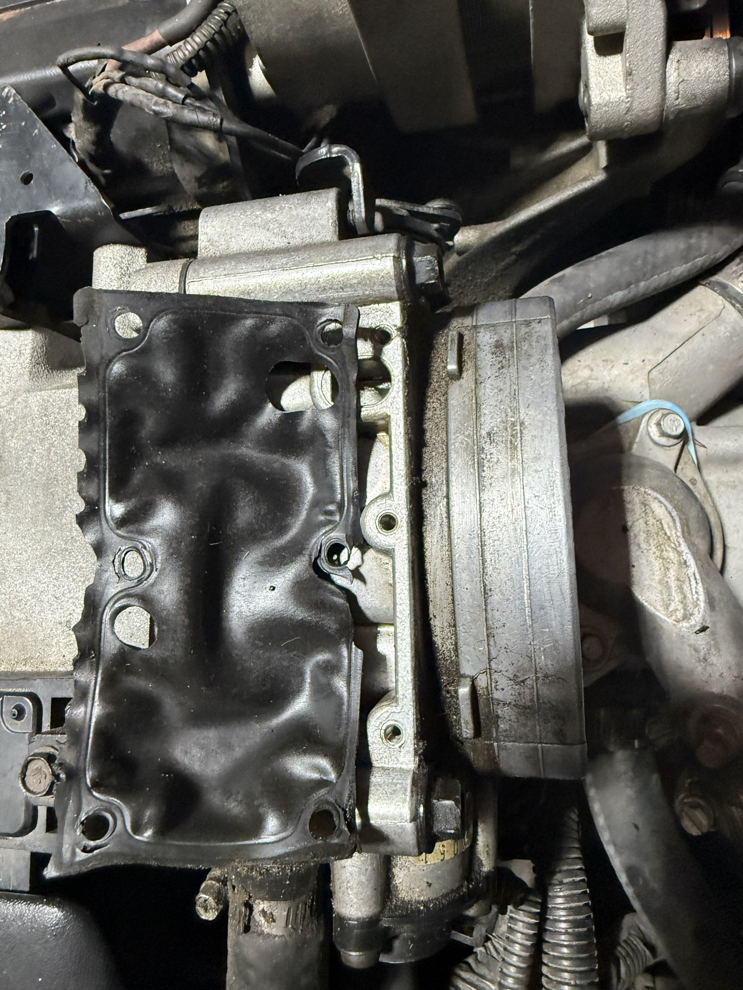

What the heck is this gasket called? It's on top of throttle body. This one looks way to big.

Is this underneath the plate that says "tuned port injection" that's on top of the throttle body. That looks like some kind of homemade deal or something. Replacements are easy to find if so.

Idle air control housing gasket.

Upper Cover gasket.

That one looks kinda funny but if been on for years they all look funny like don't belong on the throttle body, I removed one a while back looked all wrinkled up just like that one ..

What year Corvette?
What about that material though? Looks thin and vinyl like, almost like this was some kind of improvisation cut from material somebody had lying around.

My guess is that gasket started out the correct size, but after being exposed to petroleum products it has swollen up. Some rubber/plastic materials do funny things when exposed, I once threw some brake bleeder rubber caps in a container of odorless mineral spirits to clean them off quick....5 minutes of soaking and they looked like mushrooms the size of a quarter! Lesson learned👍
