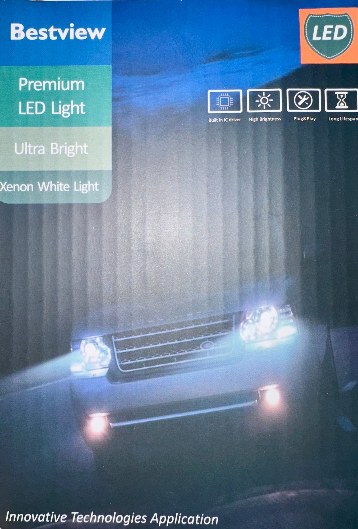

H
These are the LED adaptors I used and work great
now if I can get the new motors or work properly I’ll be happy. I must have installed something wrong
