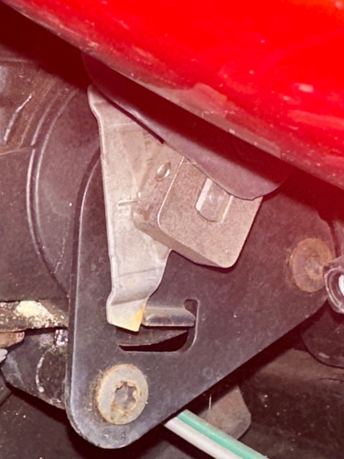

I replaced my headlight actuator motors and headlights this past weekend. The entire assembly was taken apart to pull the new wires from the single harness through the headlight hinge. Doing that, a triangle bracket fell out. I’m not sure if I have it installed correctly as my headlight now only opens 1”. Thoughts appreciated.
I installed a plug-n-play adaptor for the headlights and that part seems to work.
