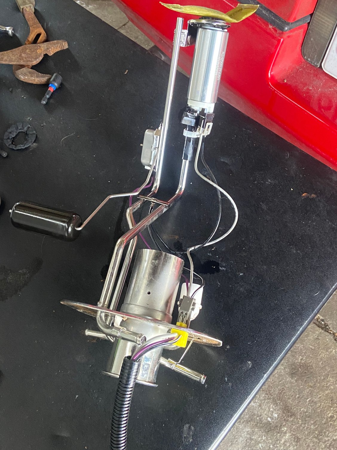

Hello all,
I am completely new to working on cars, and thought it might be a good idea to start out by putting a new fuel pump assembly in. I did everything, connected the hoses and the electrical, but when i tried the start the car it started to crank very slowely and not start. Does anyone have any ideas on what I did wrong? I also have photos below of the fuel pump, maybe that helps. Thanks so much.

Looks like you didn't use hose clamps on the hose connecting the pump to the tube. There should also be a rubber sleeve that goes around the pump to keep noise down. You have a plastic clamp on the hose that's not needed. My opinion is when the pump is turned on its spraying out at the hose. There's about 40 psi at least to that hose. You can also check the shrader valve for pressure at the fuel rail.

Originally Posted by willmassey10
Hello,
when I turned it on I didn’t hear any noise coming from it
In the pic below, note that the electrical connector is not mated to its position on the sending unit plate.
If you never plugged this connector in, this is why it won't start and why you don't hear any noise coming from it. You're new to "working on cars". One of the first lessons is "Checking costs nothing." And, "But first, did you conduct a close visual inspection?"
The in-tank harness is not plugged into the yellow through-connector.
I agree, my old eyes aren't what they used to be. If thats not plugged in it ain't gonna start.
