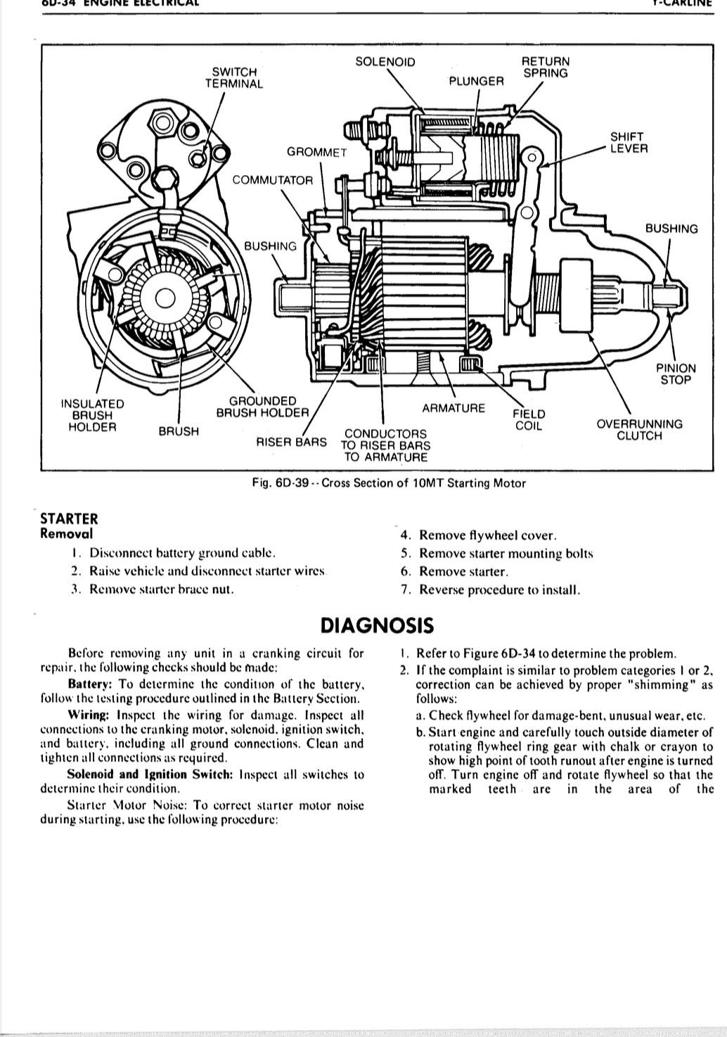

If the battery and terminals are healthy, you may want to see if the starter needs shimming.
