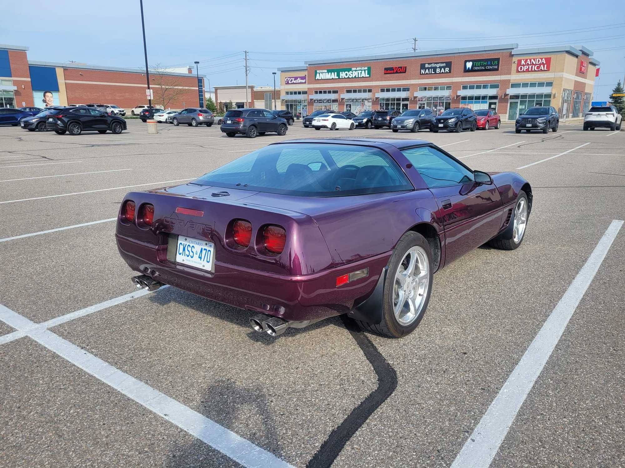

Hi yall. New C4 owner here.I i love my car, I wish my wheel combo was squared. 18s in the back and 17s in the front. The front wheel well has so much of a gap between the tire and the fender. Also front wheel looks so tucked in. Id really like it to be flush with the fender + fill in the gap, so to speak. I see other peoples C4s with stock wheels and theyre exactly what i want with the flush and no gaps. Advice? Google says 18" x 9.5 all around is ok. Wont cause rubbing or speedometer issue. I take it the c5 z06 wheels only come in 17s? Because i cant find 18s anywhere.

OP, your car is fitted with C5 wheels. They have a bit too much offset up front and a lot too much in back, which is why they look tucked in. You can fit up to 11 rim widths with 50mm offset front and rear. OE Wheels has a number of inexpensive options that are 18x10.5 et56 and will fit your car well with 275/35/ or 285/35/18 tires. I'd go for the latter size since you want to minimize the gap to the fender.

OP, your car is fitted with C5 wheels. They a bit too much offset up front and a lot too much in back, which is why they look tucked in. You can fit up to 11 rim widths with 50mm offset front and rear. OE Wheels has a number of inexpensive options that are 18x10.5 et56 and will fit your car well with 275/35/ or 285/35/18 tires. I'd go for the latter size since you want to minimize the gap to the fender.
11 width in the front without rubbing with full steering lock?

Yes, easy peasy if you use 50mm offset (for 88-96 C4s) and 315 tires. That's what you see on my car in my avatar. But there aren't really any street-oriented tires in 315/30/18 or 315/35/17 - they are all really track/autocross-focused. The 18x10.5s et56 wheels I linked you to with 285/35/18 offer lots of good street tire choices, and they look good on a C4, and for a lot cheaper than 11" and 315 options. Here's my friend's 95 on that exact combo front and rear, with stock ride height and stock everything else:

I mean. Im good with the 17s if they fill out the open space in the wheel area without lowering the car. Ive already scraped the front lip a few times as it is, i dont want to lower it. The white car with those Zr1 wheels does look solid as well - and cheaper than the 18" option...

Another thought, what about wheel spacers for both rear and front? Rather than buying all new set of wheels to get those wheels flush with the fender.

Wheel spacers require longer studs. Those aren't super tough to do up front, but they are more of a pain in the rear hubs. It's very doable for someone mechanically inclined and with a garage full of tools, but for a lot of folks it's going to a big task. Besides, the staggered-diameter wheels from C5/6/7 don't really look right on a C4. The C4 had great fundamental proportions and didn't need to hide a strangely short and tall *** like the later gens did (a byproduct of their transaxle layout).

It will be the labor to replace the wheel studs that costs money. A spacer itself is just a flat piece of metal milled to a specific thickness. It doesn't need to be expensive or fancy - just flat. If anyone starts talking about "hubcentric" spacers or super-high-quality alloys or whatever, stop listening.
I meant to include the following in my prior reply: what exact tire sizes are on your car right now? The OE C5 rear tires are too tall for a C4, and that may be what's in back of your car. OTOH, in your pics, the fronts look too short, like someone was going for that 1970s drag racing look. That may be causing part of your gap. Please look on the sidewalls and tell us both tire sizes.
