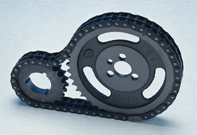

Tom, it's Cloyes CLO-9-3145 $79.88 at Summit
Cool thanks! That will save my buddy a lot of cash in place of the LT4 Extreme setup.

That's the one! It's nice how you can get the Coyles and the Mez. for about the price of the LT4 extreme by itself.

I just got that one myself - going in tomorrow or Wednesday when I assemble the motor!

Don't forget if you're installing the Cloyes chain on a 96 you need to remove the reluctor ring (it's for the crankshaft position sensor) and have it programmed out. The crank sprocket will not fit behind the timing cover with the reluctor ring in place (actually it will fit, but then the motor won't turn).
