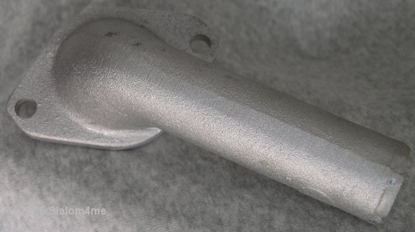

Anyone ever stumble across an OEM thermostat housing that is
clocked correctly at the Streath Ram flange?
I think the Mini Ram flange is similar to the HSR and TPIS (re)sells
a suitable housing for the MR.

I am getting ready to go the Stealth ram route. Why can't the TPI throttle body be used? What are the down sides to removing the IAC? I'm not following the problem with the water neck could you explain that a bit more to me? What do you mean by "clocked correctly"? I'm not worried about the hood as I am going to use a cowl induction setup.

If you installed the thermostat housing shown above on the Stealth
Ram, the neck will be 'clocked' (pointing) in the wrong direction - that
one is out by about 90º.

Originally Posted by Slalom4me
One poorly addressed item on the list is a quality thermostat housing.
Here is what the t-stat flange looks like on a HSR (for conventional
23º heads)
The thermostat housing for the TPiS MiniRam II appears to be
a good match for use with the Holley Stealth Ram - the neck
winds up pointing essentially straight forward. I have not
assembled all the parts together to verify there is no interference,
so there is still a chance something might cause interference.
I am sure someone mentioned this part along the way, I just
can not recall who. Thanks just the same ...
