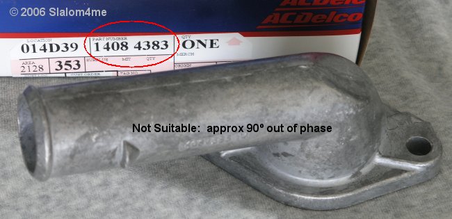

Thermostat Housing & Rad Hose:
The MiniRam II thermostat housing available from TPiS works (see post further down)
Housing from 88 - 92 gm serpentine vehicle or TBI thermostat housing are reported to work
(The housing from a mid-80's f-body (p/n 14084383) does NOT work - see post further down)
(mr. gasket p/n 2661 Thermostat housing works but is reported to be
poor quality and prone to leaking)
Dayco p/n #71028 (85 Camaro Carbureted upper radiator hose)

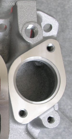

One poorly addressed item on the list is a quality thermostat housing.
Here is what the t-stat flange looks like on a HSR (for conventional
23º heads)
In my post above, it says that a housing from a serpentine-belt vehicle
will work. Well, the one above won't - it is the housing from a mid-80's
f-body (p/n 14084383) and it is clocked about 90º from where it needs
to be for the HSR. A visual comparison against some photos of my '89
L98 lead me to think this is the same part.
