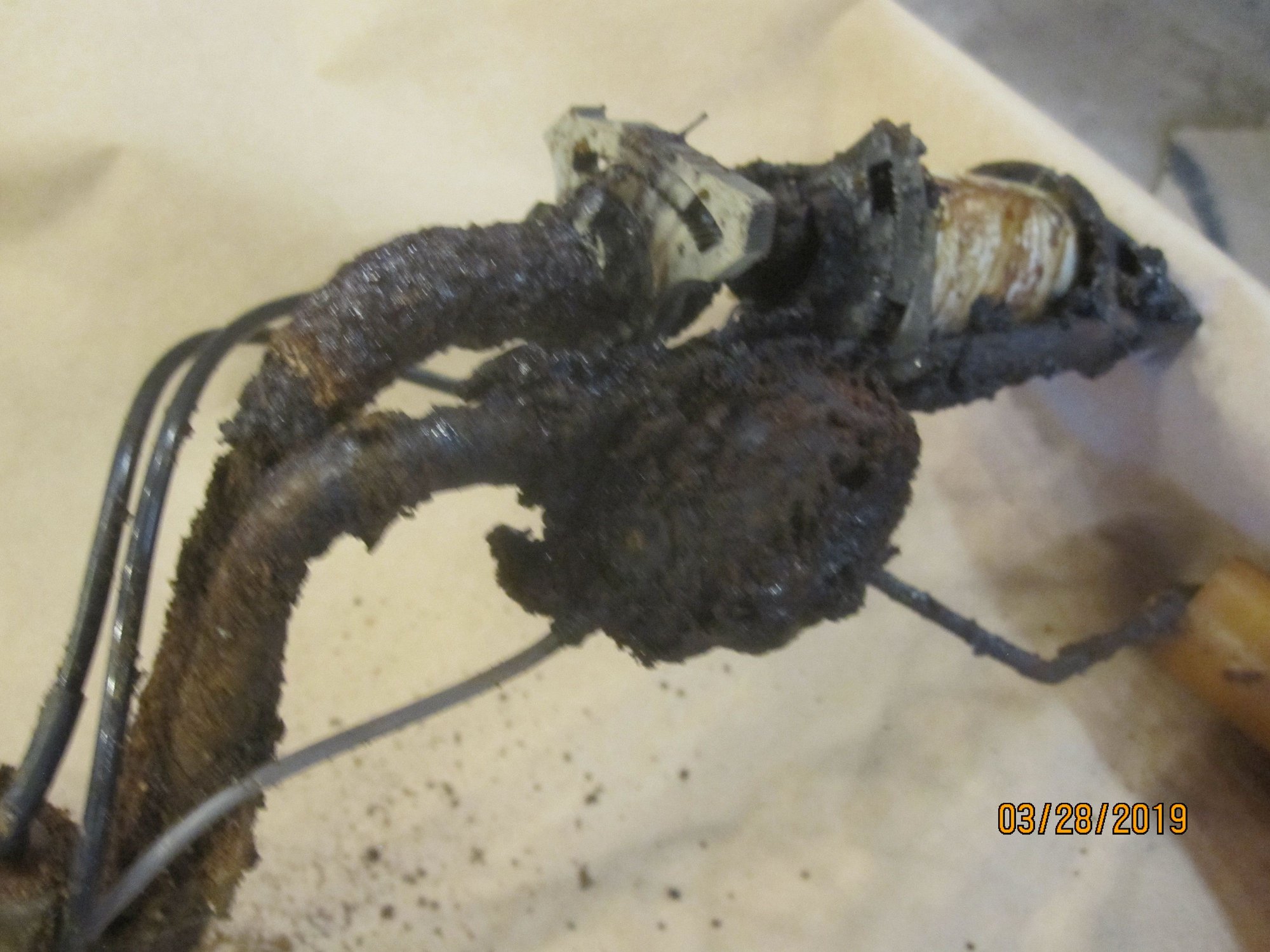

Yes This thread is 13 years old,
Question on the outside door pull. It seems frozen with no movement at all.
On the drivers side there seems to be a movement either locked ou unlocked.???
I got the 35 year old gas pump put and WHAT GRUNGE. There is not a hose connecting
the pump output to the 3/8 vert pipe (NOTHING). I cant see it inside the tank either..???
Is there a exploded view of the crossfire pump /level sensor that shows the parts breakdown???
Another problem I see is the fuel return pipe that goes down to the lower mounting for the
fuel pump was completely blocked about 3 inches with hard grunge. I GUESS WITH ONLY 9 PSI
YOU CAN GET AWAY WITH THAT.
I hope to get the new pump /filter/strainer any day. I guess I will have
to use a short piece of 3/8 rubber hose and two clamps???
