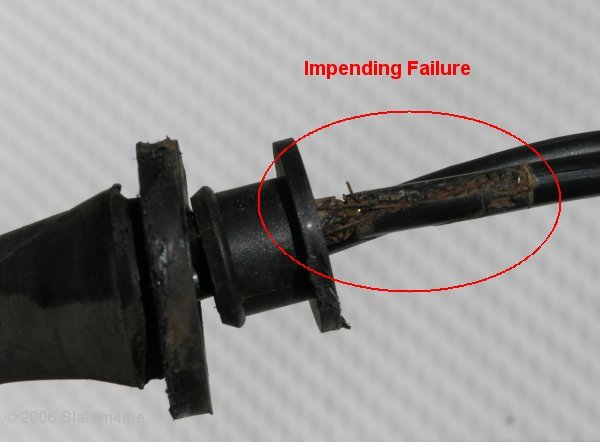

Recently, I felt the hood release was feeling a little more springy and
the hood was a little more reluctant to pop open. Although I have a
hood release tool, I preferred not to wait until the cable broke.
For an '89, the p/n is: #10250486 Cable Asm

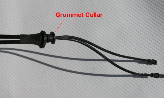

  • there is a round plastic collar inserted into the cone shaped grommet where
    the cables pass through the firewall. You can see it in the picture below.
    This needs to move back out of the grommet toward the passenger compartment.
    After trying to grab it from the inside of the pass compartment, I changed tactics
    and used a large screw driver to push through the grommet against the collar from
    the engine compartment. A patient person could probably do this without tearing
    the grommet.
