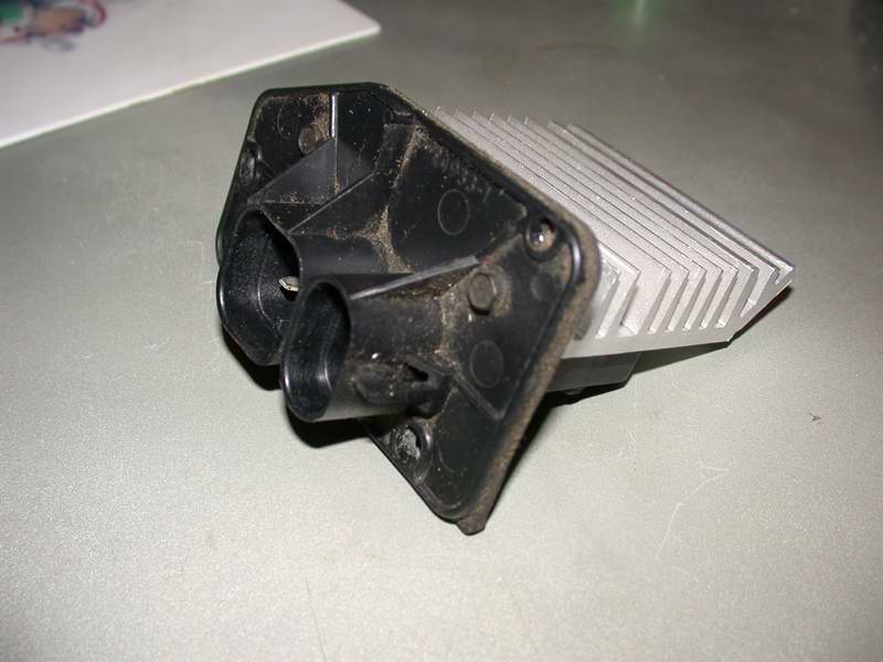

Hi, I have just the same problem. Blower stays on with ignition off. I ckecked the 5 Amp fuse and its OK. Seems like I need to search a BCM somewhere.
Jus to make sure: did I pull the right thing?
--> http://www.buume.ch/bcm.jpg
Apart from missing AC, is there a problem driving without the module?
Thanks for Help and greetings from Overseas
