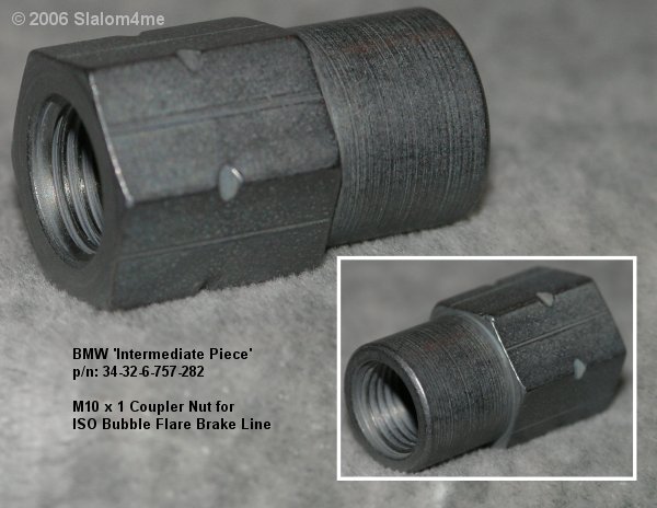

  • Forming a new strain relief section and then replacing
    the existing one by splicing the new section in with a tube coupler.
    This would free you to flare the existing pipe below the pig tail
    where it is straight. My 540 uses OEM brake line tube couplers in
    several locations. I do not know with certainty that
    BMW uses the ISO/Bubble flare but I recall seeing
    this style coupler in the fitting links in the thread.

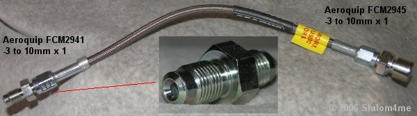

  • Another approach might be to use fittings and braided hose to
    complete the tube run. A male Aeroquip FCM2941 (-3 to 10M x 1)
    has a combination bubble/inverted tip for the M/C. With a suitable
    length of hose and a female Aeroquip FCM2945 (-3 to 10M x 1) to
    connect to a new end on the OEM hard line, the line will be
    complete.

BTW - You didn't need it, but here is the Plan B contingency.
An M10 x 1 coupler nut from BMW, p/n 34-32-6-757-282.
If it had become necessary to cut the line back
and to add an extension section, the coupler nut
is a tidy way to splice a new piece of brake line
into the system. They are used in a number of
locations by BMW as part of an OEM system.
