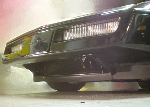

Mine fit no problem. I checked the website, you wouldn't know it requires drilling until looking at the photos and captions on that first link.
I'm not sure who would buy it without checking the install photos that show bolts in the skid bars and mention the use of a power drill, but he should make that fact more visible, it's understandable that some vette owners would get queasy drilling holes in their car. Sounds like he picked the wrong time to be a salesman. .
Anyhow, here's mine, decide for yourself. I volunteered some rudimentary test data for Eric when he first started selling them. I was surprised at the increased airflow, I think it's worth testing with some datalogging equipment.
There's so much aftermarket garbage out there with false claims, that it's nice to see a forum member willing to stick his neck out and come up with something that actually works.

Under most conditions, your car gets enough air to the radiator in stock form to keep the temp close to the thermostat rating. At that point, the thermostat is controlling the coolant temp, so if you add more airflow, the thermostat will just counteract it by reducing the coolant flow. You might drop your temp by a measly 2 degrees in these circumstances. Similarly to a larger radiator, the bmad simply can't help when the engine doesn't need it.
You will see an improvement though, anytime the coolant temp is ordinarily well above the tstat temp, if you live in a hot climate, or run the car hard.
Think of it as a radiator upgrade. My heatsoak tests indicate that the bmad is bringing twice as much air to the radiator.
