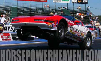

Really interested in seeing your setup.....do you not use coil overs in yours with the rear spring?
here is the vette I mentioned above...

I know the car that you are talking about, Brad Plourd raced it for a while. It is actually a A/FIA LT1 stocker.
My car runs as a D/FIA and the best 60' has been 1.38 10.98 @ 119. The car generally works on everything short of wet grass on a 9" tire.
http://www.autoimagery.com/store/cgi...ch=witherspoon
If you would like picture I will need an email address. I am kind of challenged when it comes to posting pics here.
